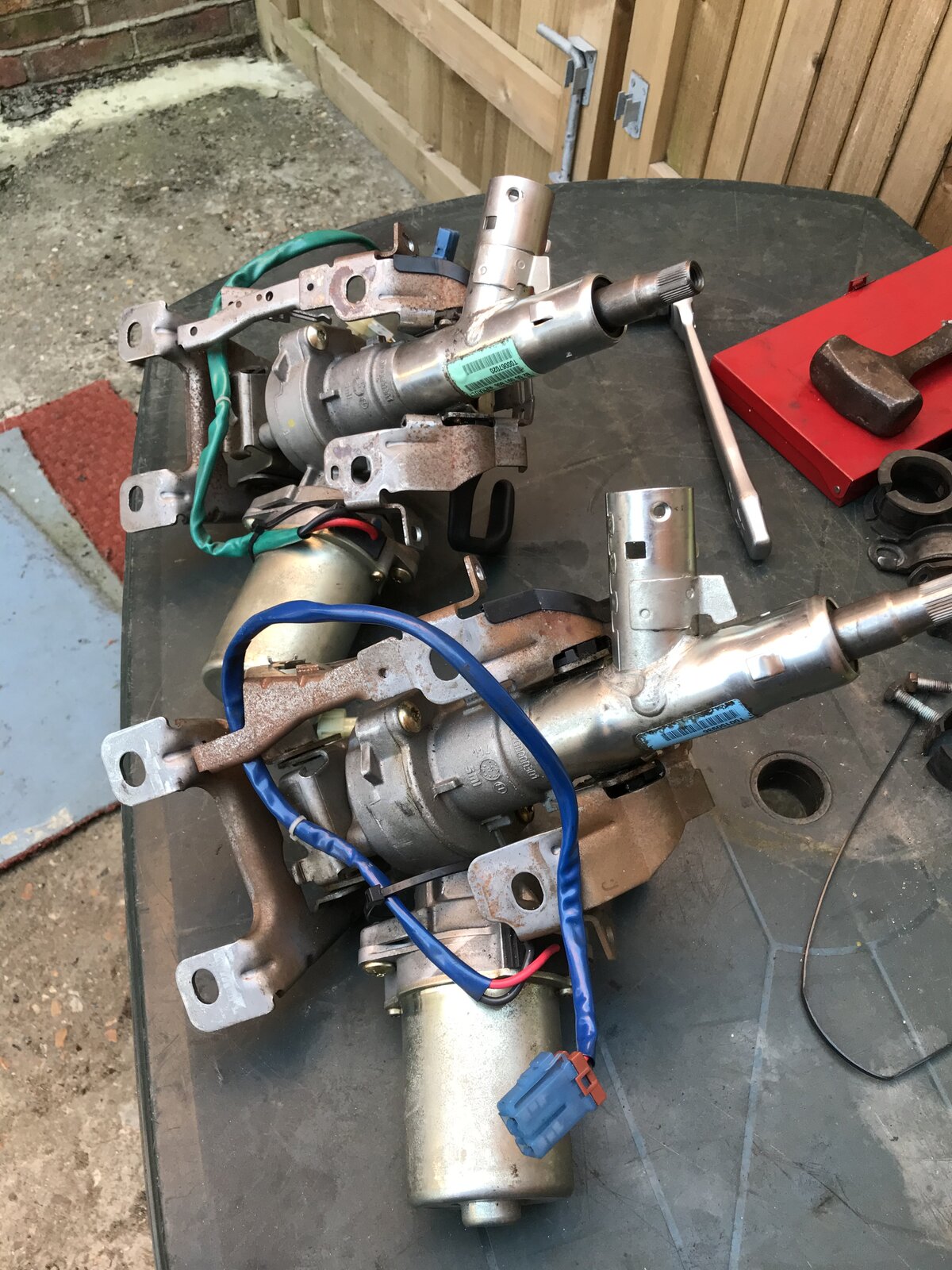

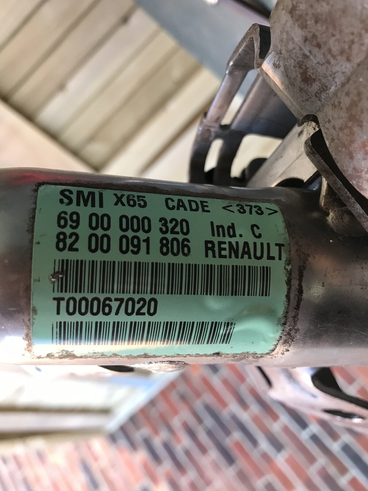

So I’ve had a swap round now of each column and the blue is the more powerful column, the green will lose assistance quite quickly after turning the wheel, this was while stationary with engine on. Since I’m using the kit to control assistance I’m not sure the ecu matters as as it’s the green label one, I’m going to have a look on eBay for different ones and see if I can pick something up cheap to try and for spares.
GrahamS
  335d

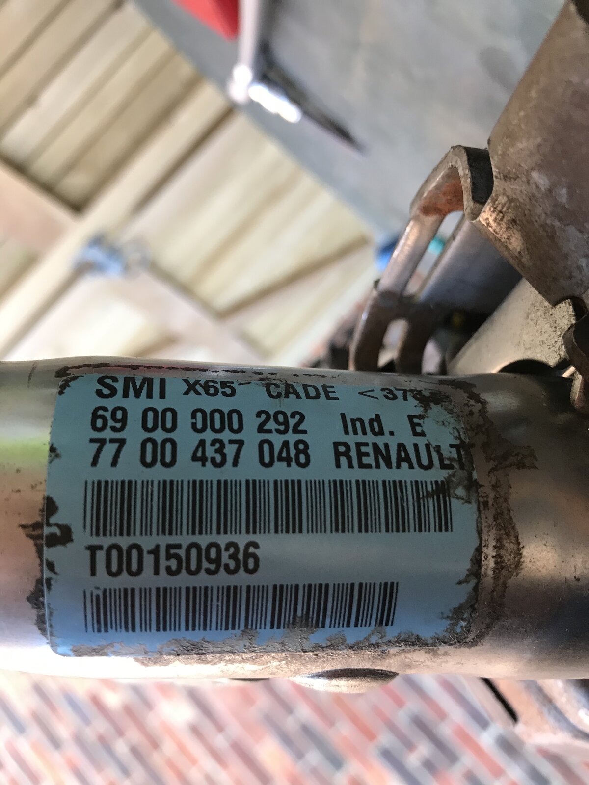

All of the ECUs and columns are the same as far as I know with colouring not representing anything specific.

There was a big difference with how easy or not it was to to turn the columns by hand (off the car).. So not sure if one is more worn or not but the lighter one to turn felt better in the car

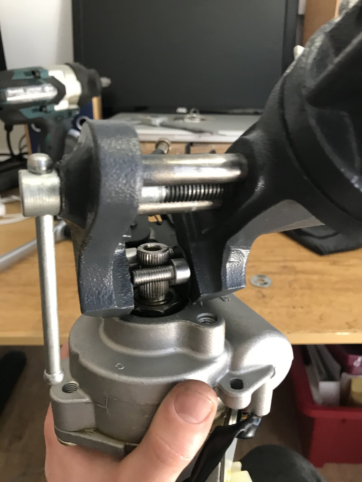

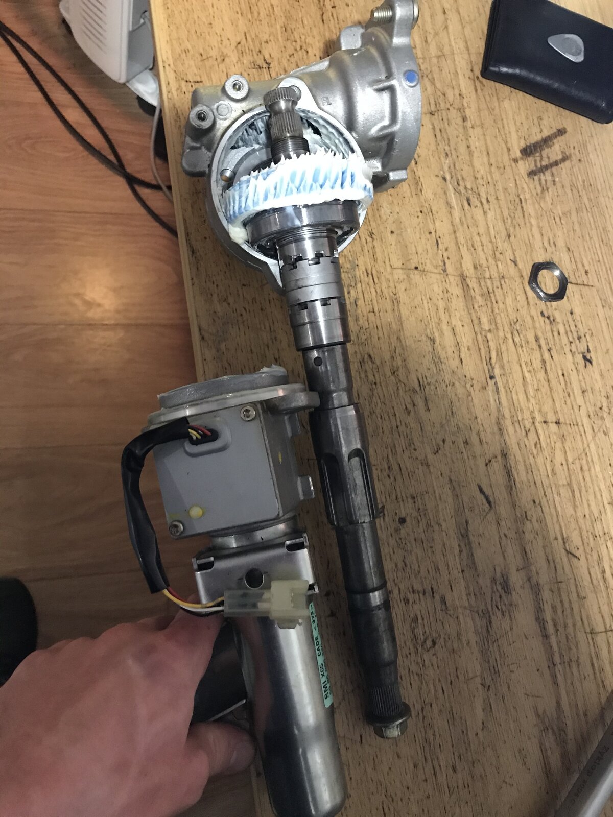

Thinking about it, i played around with mine on the bench adjusting it and using a spanner/adjustable on the column input shaft to get a feel for it before fitting.
Trying to take apart the spare column, I have no 27mm socket :LOL: It didnt work anyway, unless its a reverse thread the nut is done mega FT

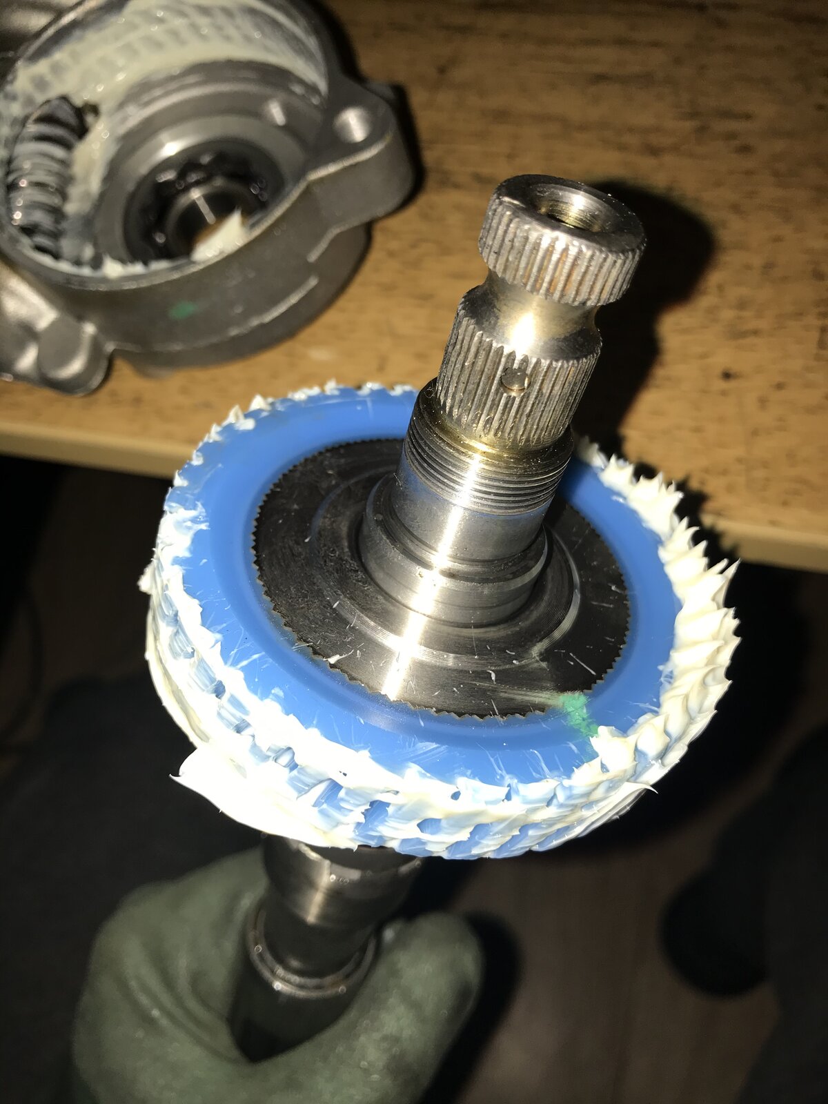

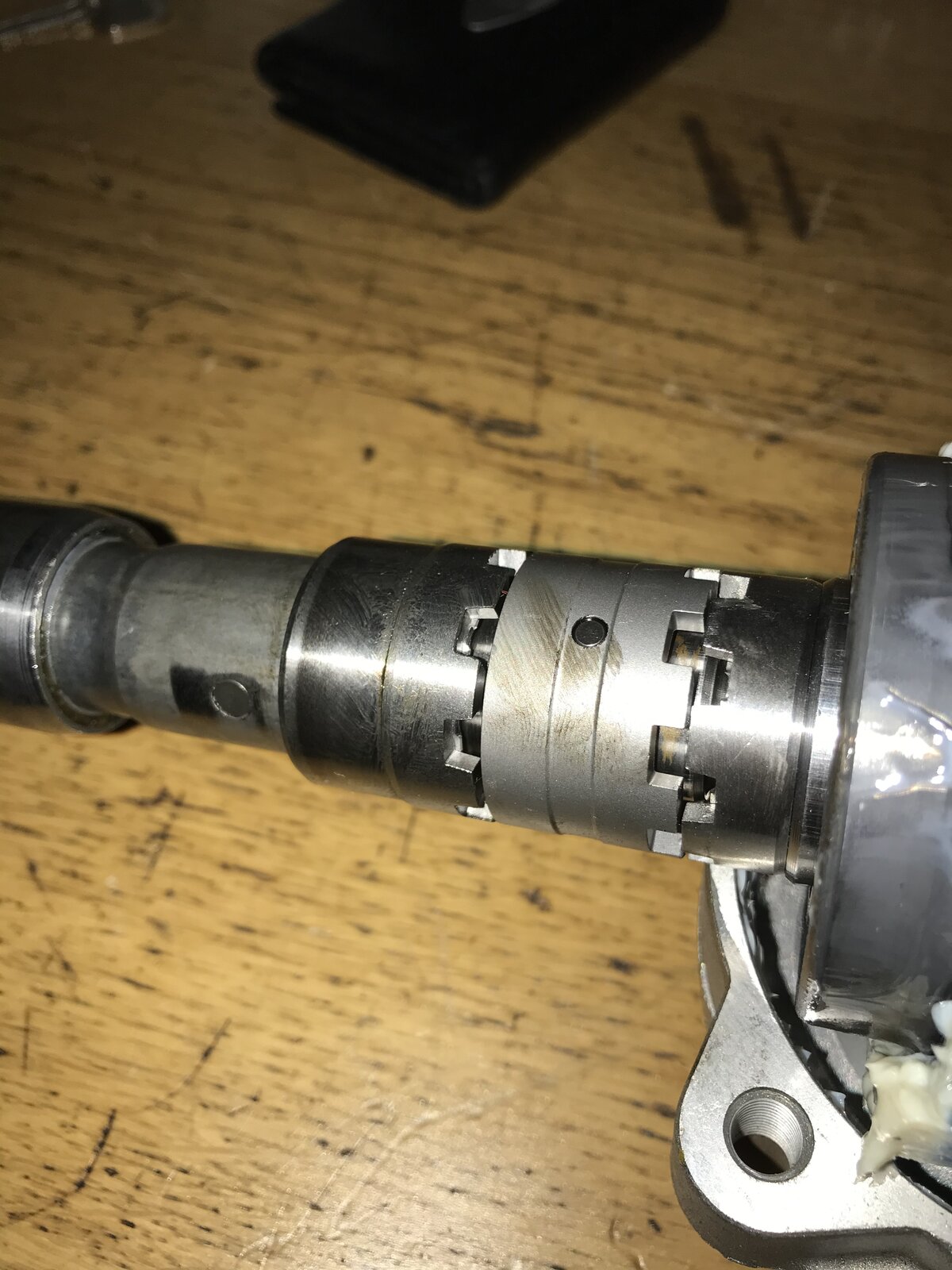

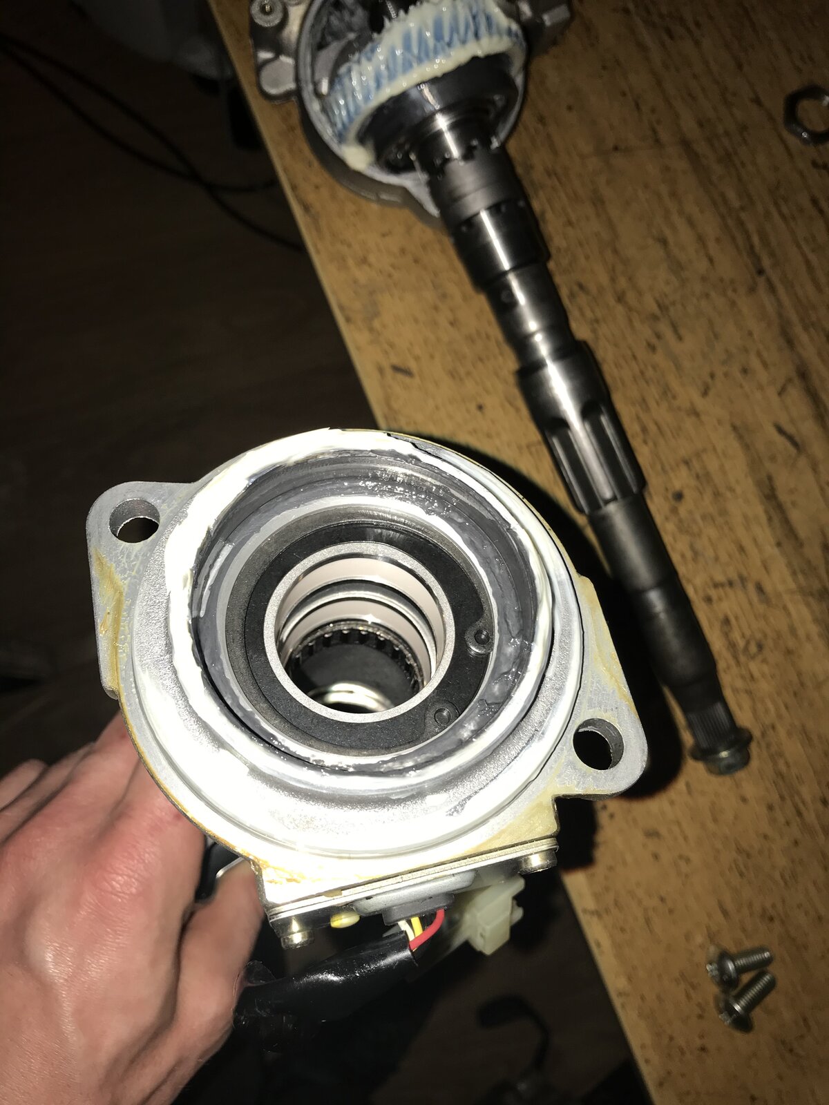

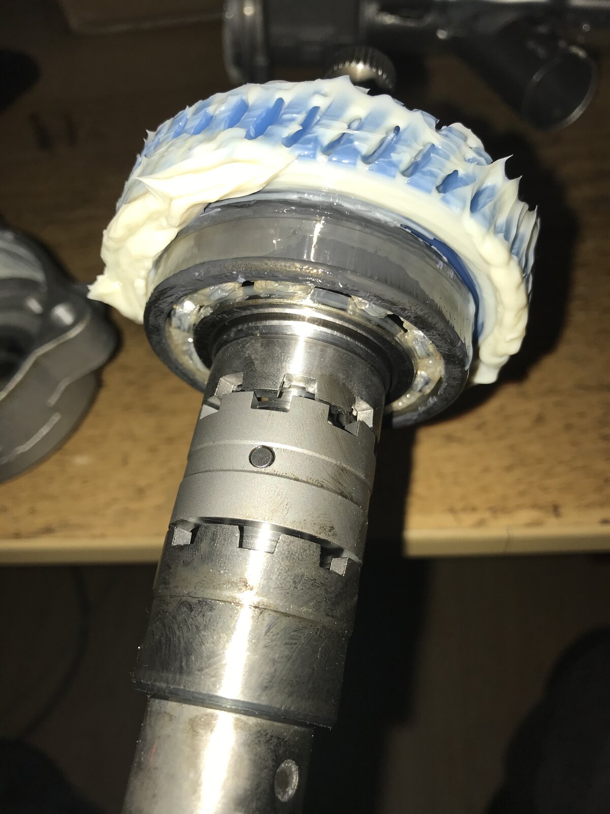

Ive been learning whats inside the columns and the 'worm gears' which I read can be a problem, basically I took the motor out and 2 bolts that hold the gear casing on but its still attached to the shaft with the 27mm nut and it spins freely, so its not the motor its the gears or seals inside. This one I was trying to open is the one very hard to turn, the one on the car is easier but still hard, but its very noisy and clunky so I know something is wrong. When the socket I ordered arrived Ill have a proper look at how it works and see if theres an obvious fault. I also read that you shouldnt turn the column with the ignition off, because the worm gears dont want to move or something and it causes wear?
Eddie555
  Q7 2018 & 172 Cup.
AFAIK.. The gears inside that motor are plastic and thats where the wear and notchyness will be.. Thats why, if you've been following @pule333 , has adapted a Mk3 column into his Mk2.. His theory is these Mk2 columns were designed for a lighter car on skinner wheels and tyres so less force would have been required..

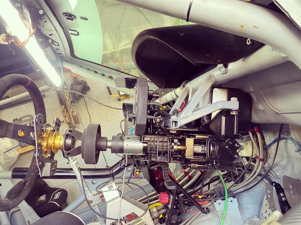

You'll find Ilyas MK3 column mod briefly on his Instagram #ruskiweldshit
Sent from my SM-G977B using Tapatalk

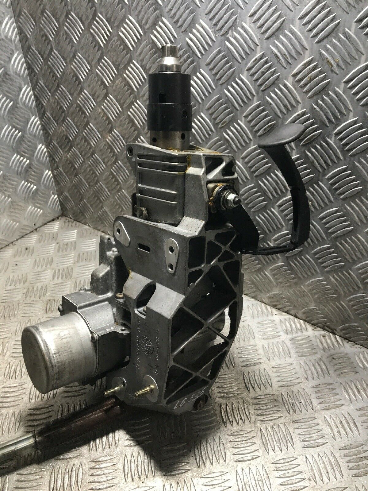

@pule333 Damn look at the frame around the column compared to the one on the mk2 made of tin foil. Is the mk2 motor gear housing compared to the 197 a considerable size difference? bigger is better (more powerful)
What are you planning with that insane build? European hill climb? o_O
Whats the wiring like for the 197 column? I was looking on ebay and the megane ones have the pump facing upwards too, the mounting looks strong
Is the 197 distance adjustable as well as height?

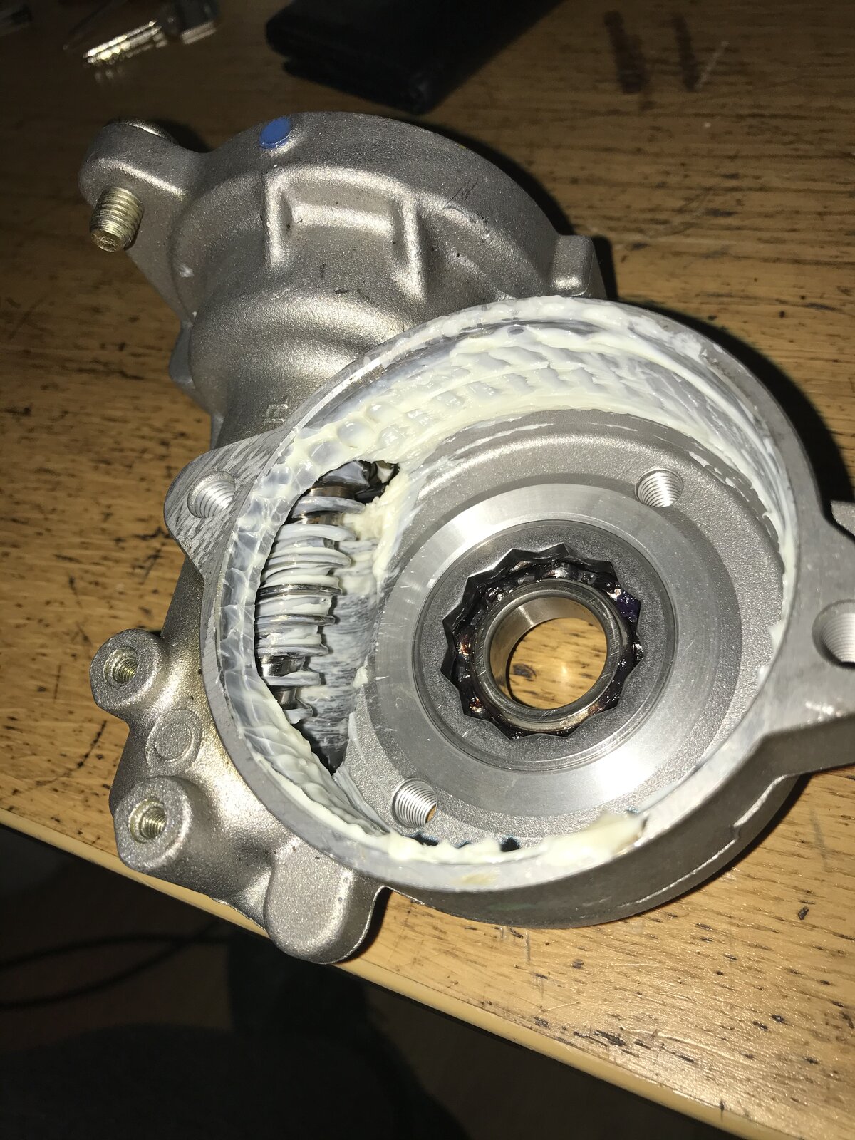

I think this is what’s causing the problem, the blue gear is not seating properly to the metal worm gear so it’s too stiff. There’s 2 pins to detach parts it looks like. The actual gears look fine, blue is nylon I think, looks strong enough
Haha I don’t know. Plan to do high 7 at the Nurburgring. Kick some ass at javelin sprint series. Beyond that I have no idea. Just building the best I can build. Well building the fastest [emoji23][emoji573].
Diameter of the motor is larger on 197. But it’s not as tall. Everything just feels more solid. Also on the bench side by side rotating by hand, 197 is considerably smoother. You can feel it. Also easier to ratate. That tells me the inner design is different. I simply don’t know yet. Wiring is simpler a bit. Position sensor is inside so 4 less wires to connect. But it’s the same controller as for MK2 essentially. I asked them about 9months ago if they can make one for 197. So they did. And yes it’s fully adjustable. Up/down. Forward/back. Slightly heavier than MK2.
