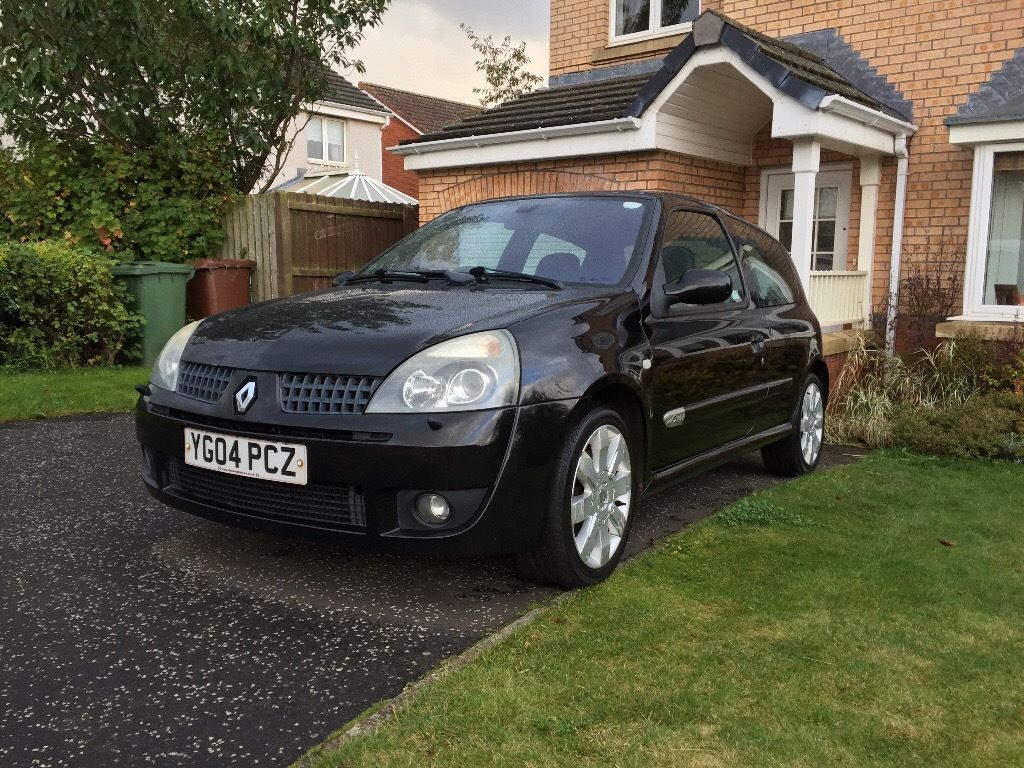

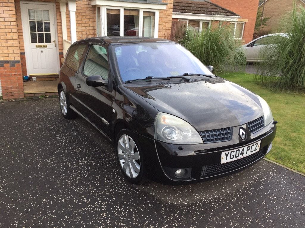

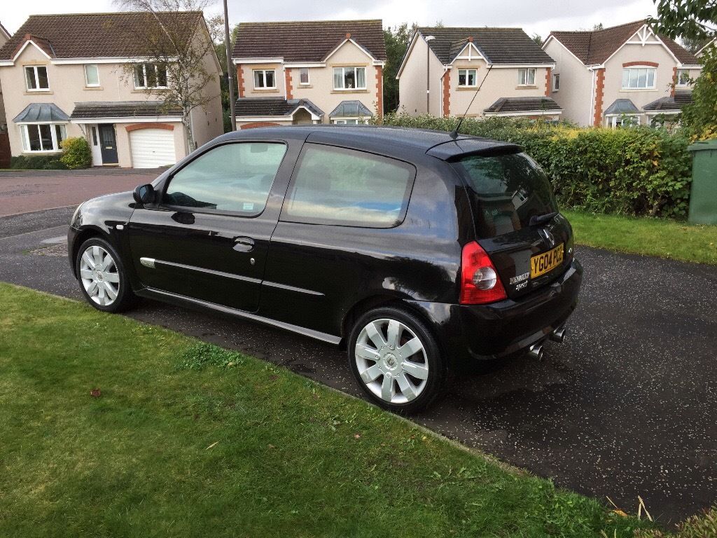

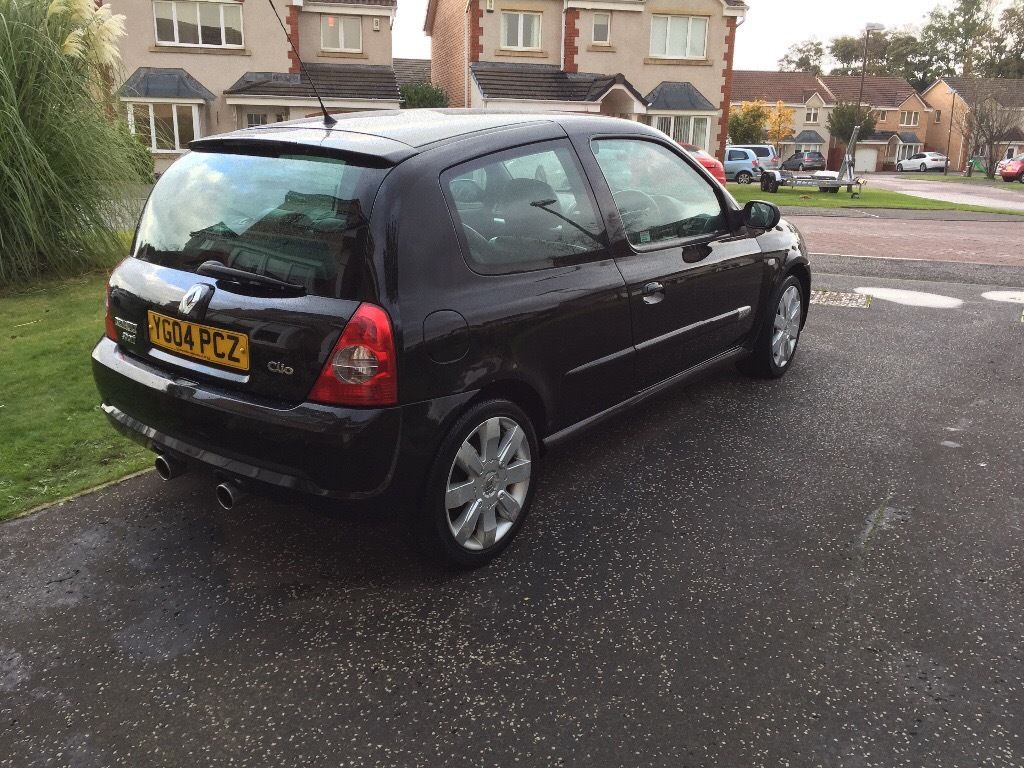

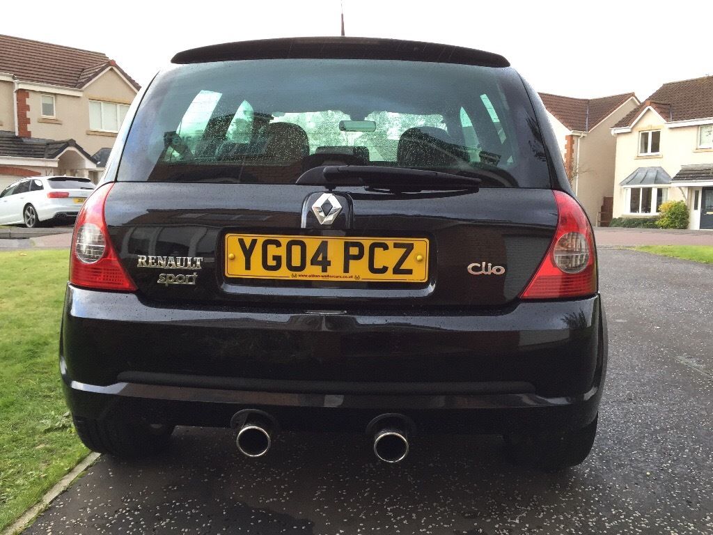

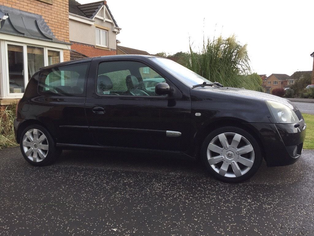

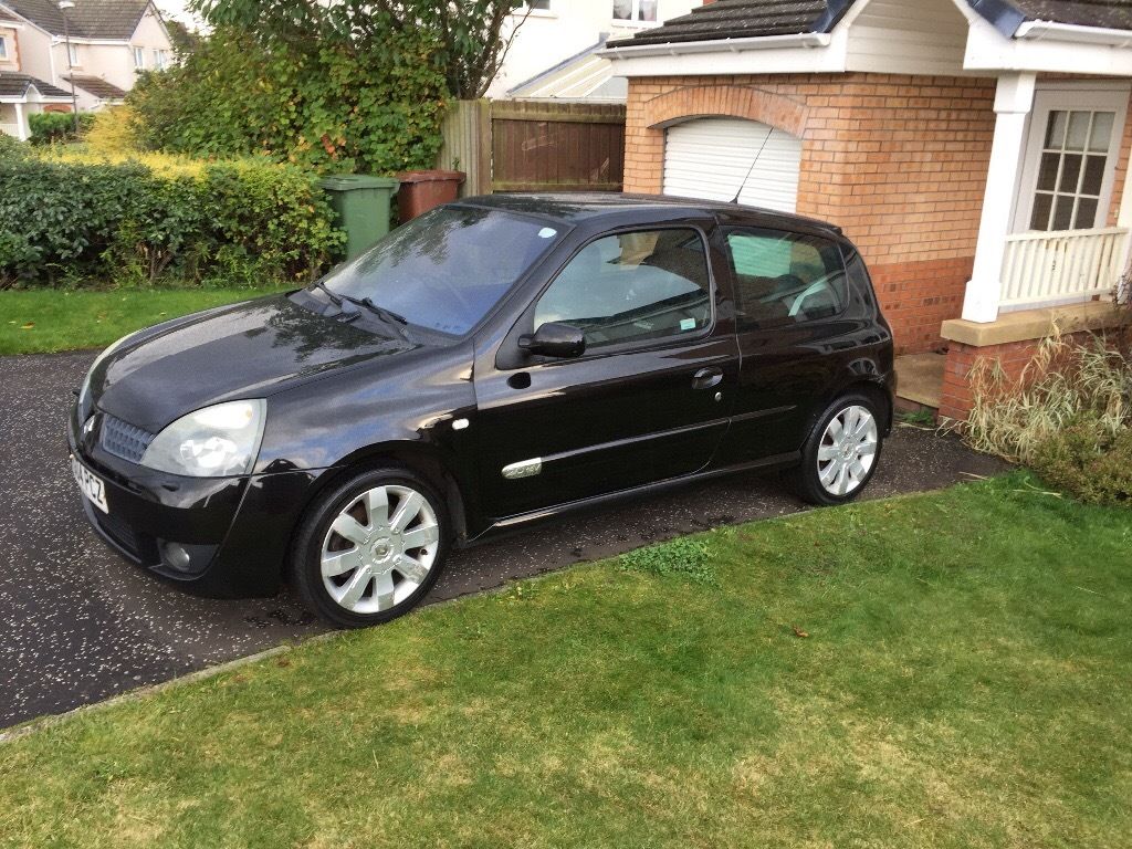

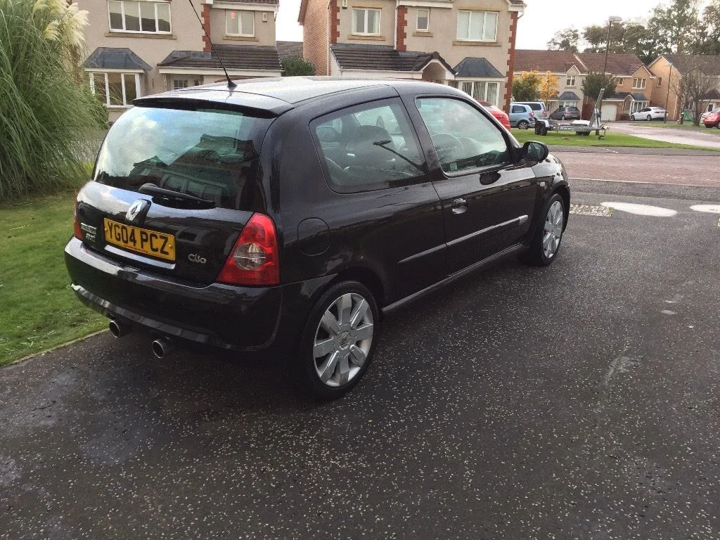

Here's the pics from the ad. They do flatter it a bit, I think. I've yet to see it in daylight....
This one has spent the last 12 years not far from the sea so I suppose rust was inevitable.
It's on 120k and the price reflected the work it needs. It's a non abused car with masses of history so worth the investment IMO.
