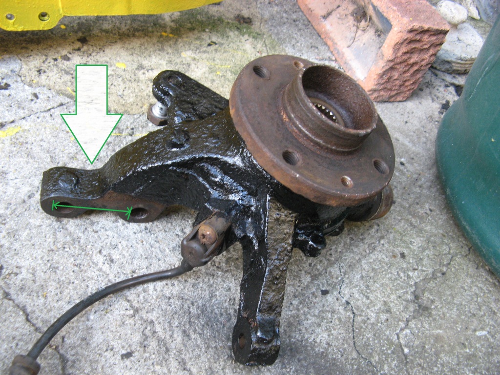

fyi, this is what is meant by bolt spacing, the distance between the centre of both holes in the hub where it bolts to the shock! (or top of both holes or bottom of boths holes lol)
i cant see any scenario where non-sports would have 54mm or sports would have 58mm but im open to being corrected!! post a link to the chart if you can still find it! :)
