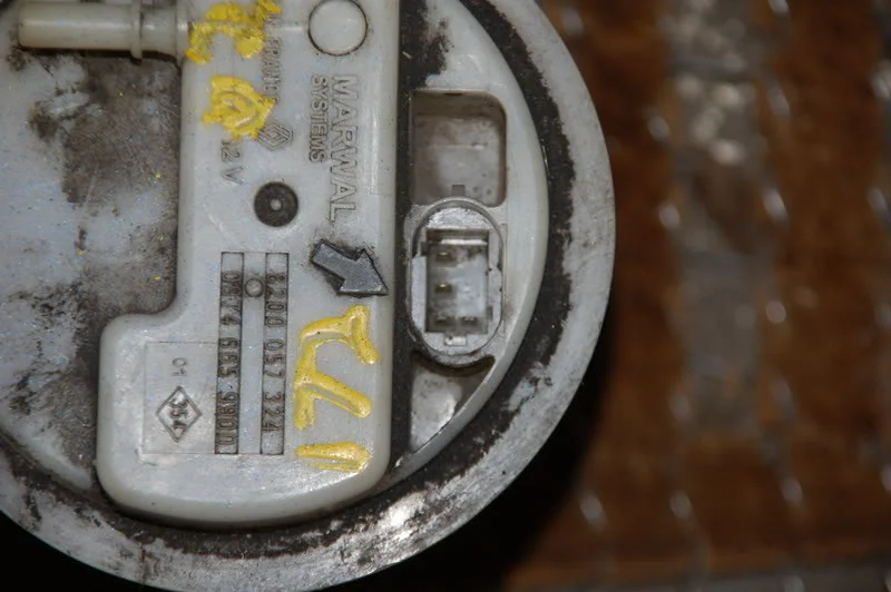

ok you see the 4 pins? the bottom 2 are the 2 for the pump, the one on the left is + the one on the right is -

cool. so when i charge thisit will jsut arm and start pumping yea?
what 12 volt can i use the old battery or summet?
