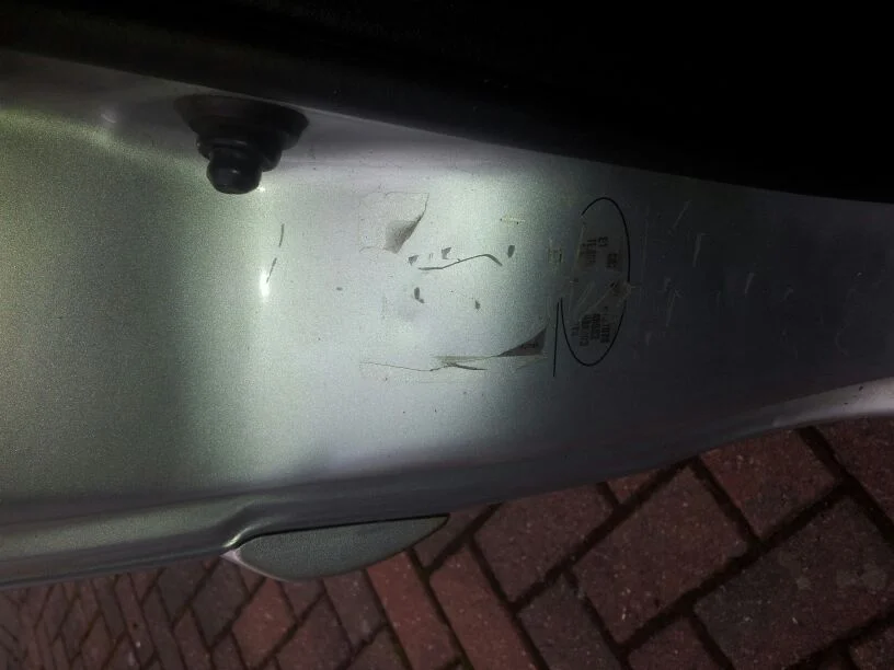

Could only think the door switch needs replacing.
Check this by opening drivers door and if the interior light doesn't light up that'd be a start.
It is a black protruding rubber switch. Should be able to see it in that pic.
Its only a thought may or may not fix it. :)
