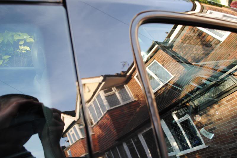

I've done my best and got it pretty decently sat now, still a small ripple but much better. Will upload a pic from my phone.
I'm going to look like a right ***** now as its hard to see in the pic, half way down is where it was, looks alright now I've done it, this is how it's sitting now which is fine tbh but from the side it's rippled a bit.

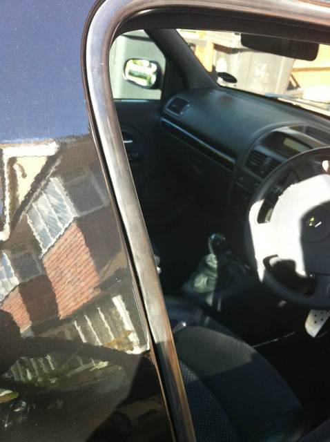

This shows how it really is, not that bad I know but still annoying when I've gone out of my way to try and perfect everything else.
