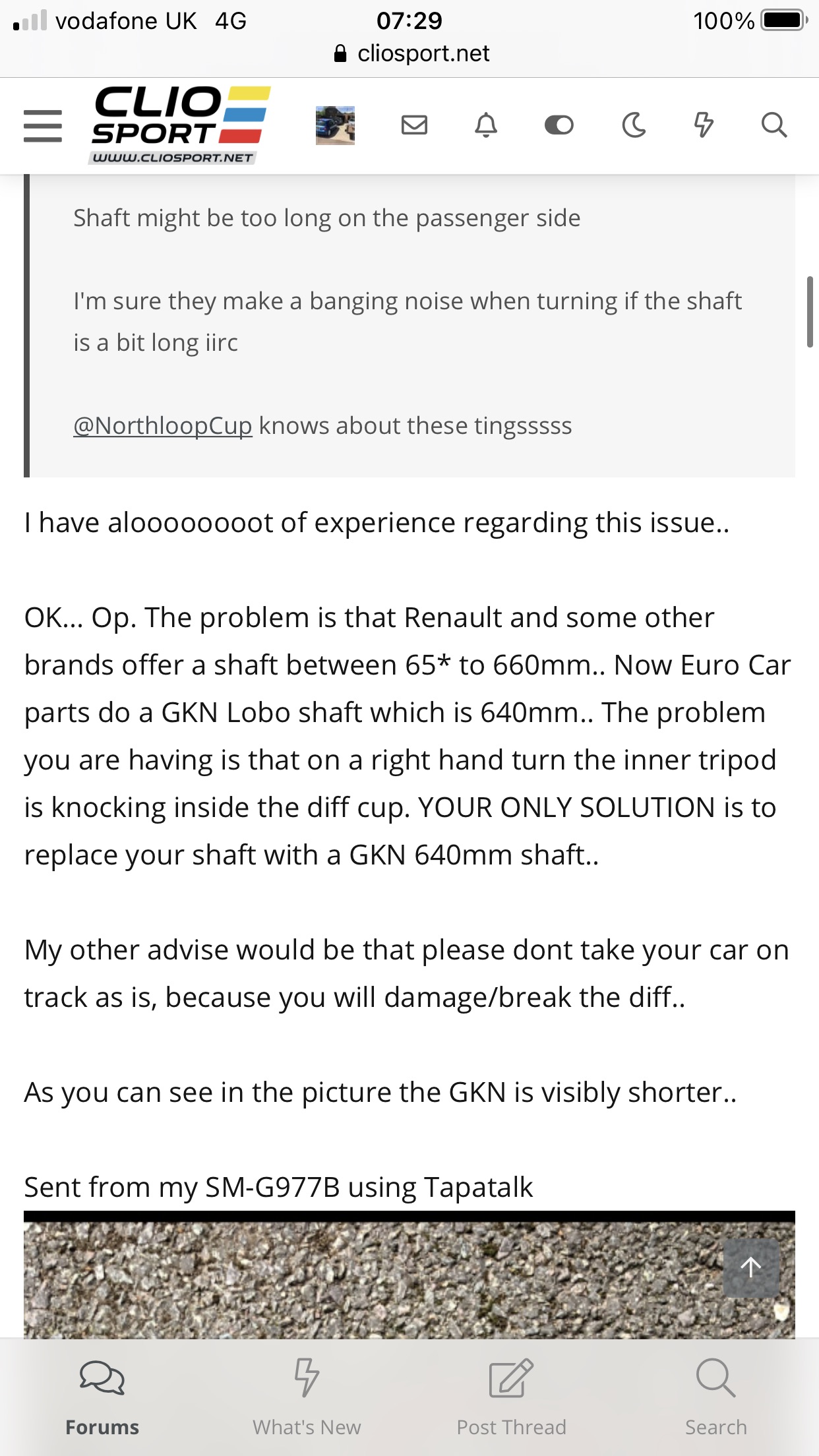

GKN 640mm from euros, that’s what I fitted

Many thanks for your very swift response. Much appreciated. Yesterday I went to collect the car from the gearbox specialist and didn’t even get into third gear before the heavy vibration started - even when driving straight and coasting in neutral! Turning made it even worse. So took it straight back at no more than 20mph. The specialist diagnosed the issue as being driveshaft related so I had to leave the car with him until I can provide a suitable replacement. Thanks again
NorthloopCup
You can also move the engine as far over to the drivers side to try and alleviate the problem.
You should’ve been told this by whoever fitted the diff mate really - it’s such a common occurrence!
