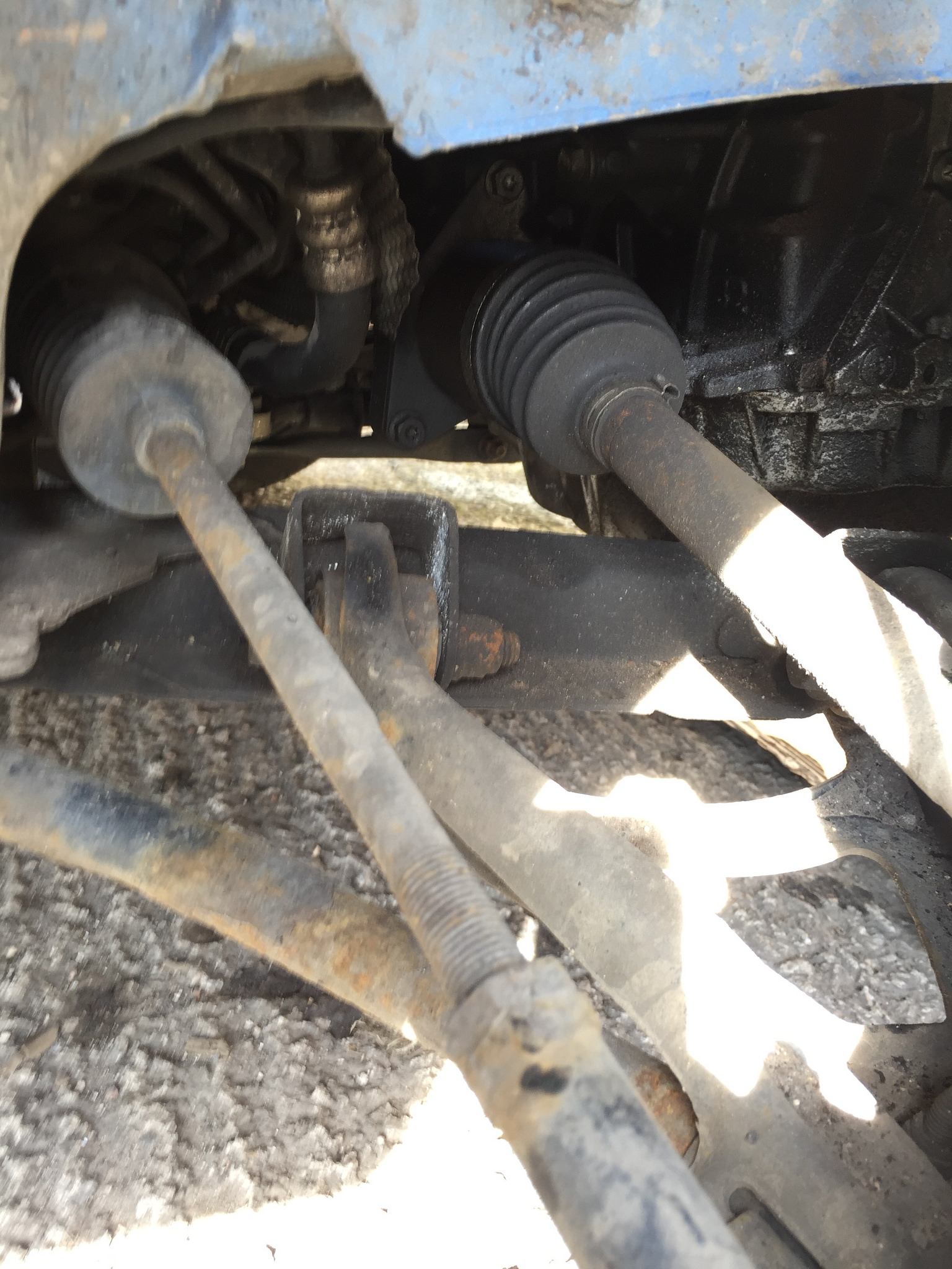

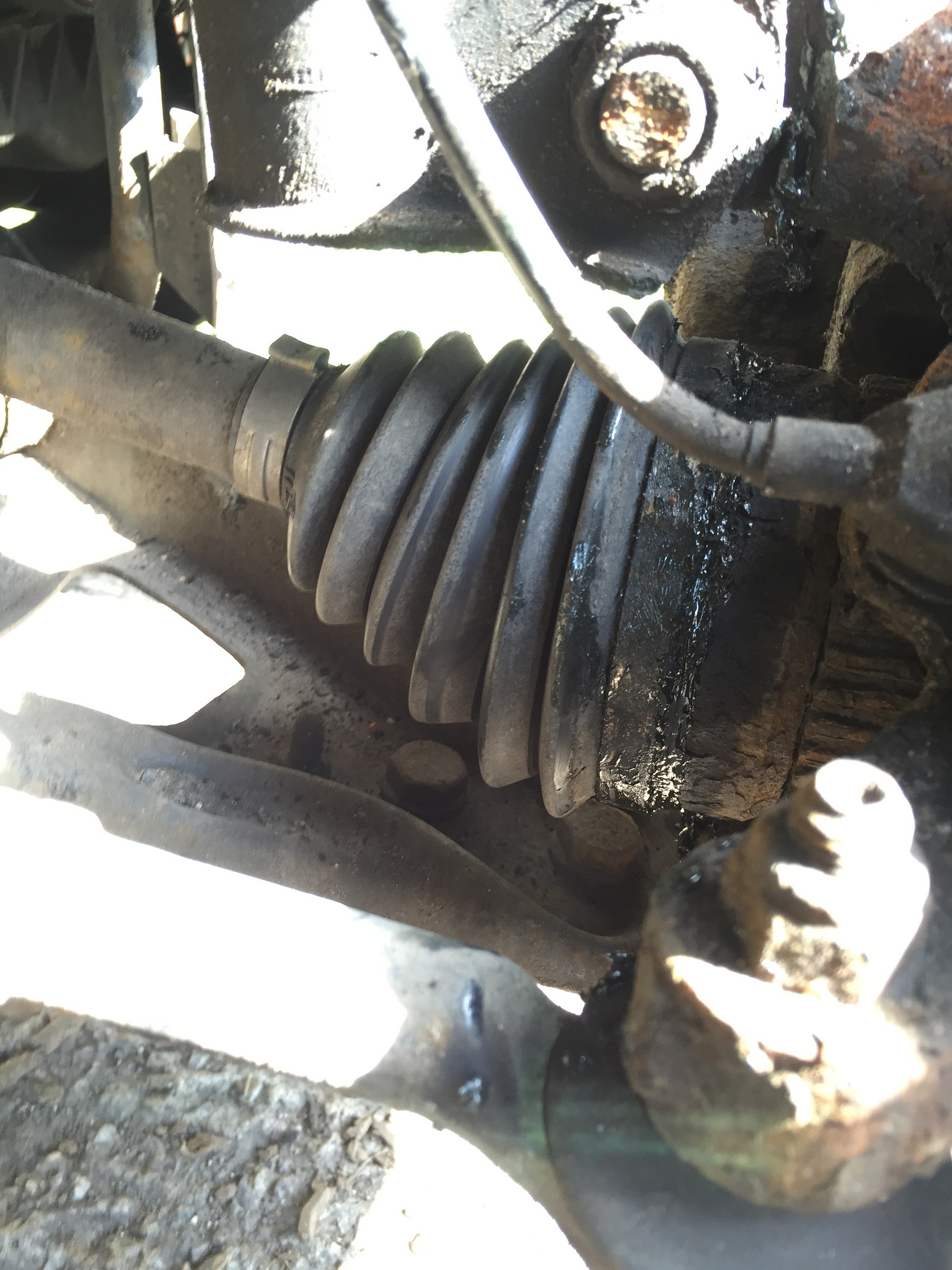

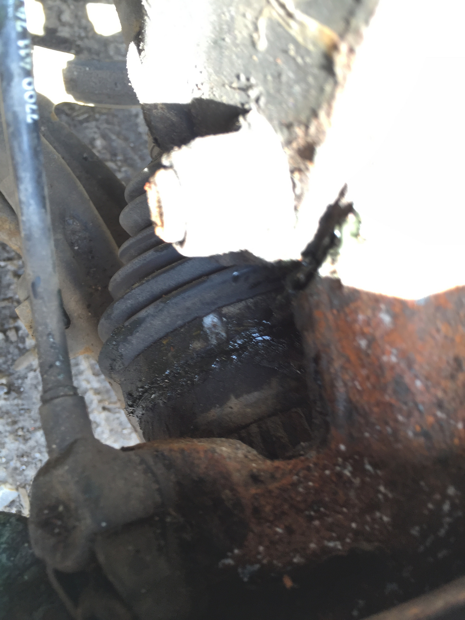

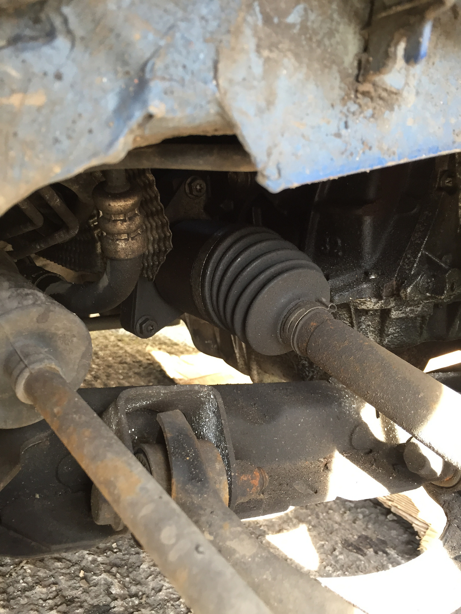

Decided to take the wheel off and have a look myself this weekend after a few more months of wear and found that that the large CV gator clip had snapped (possibly due to the shock being worn?) and grease splattered everywhere, I cant see any wear on the driveshaft really and theres still grease in the CV joint, cant see any splits in the gator either.
So am i daft in thinking i can repack the gator with grease and get a new clip and things with be fine? I'm gonna atleast try it for the sake of a few quid but any other ideas?

as you say for the sake of a few £'s may aswell give it a go before forking out for a new shaft
Sure its the driveshaft? The top mounts tend to knock at full lock - Renault supply a spacer to fix it.
Only tends to happen when the tyre tread depth gets low. New tyres and it instantly stops.
Yep, as you suggest - just repack it with grease and re-clip it (I've used jubilee clips on the outer boots and have been perfect for 50k+)
If it doesn't solve the issue you've not lost anything but your time and a few pence.
