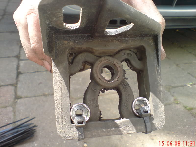

Itl be the mounts, either get new mounts which i think can be had for £10 each on ebay, they all use the same bracket but the 182 needs two.
Or ghetto fix it, put two sockets or pieces of pipe eitherside of the rubber to prop the mount up. If you join theres a guide in the guide section.
  Yozz'd up 182
Hehehe, that's pretty clever. I'll see if I can bodge something together like that as a temporary fix. I'm guessing that if it warranted a guide that this is a common problem?

Rather than using the sockets take it off and fill all the space in with "tigerseal" leave it to cure over night then bolt back in.. will probably outlast the car!

The rubber mountings were pretty shot and the subsidence is mostly gone now with the new fittings but it's still not entirely straight. Not really sure how to progress now. It's only a minor thing and I can probably live with it but it'd be nice to get it sorted. I'm thinking that summat like the fix that mwn11 posted might lift it a little high as we're only talking 1/2 maybe 1/4 of an inch out. Bit of a b*****d that there's no adjustment in the fittings other than bending summat, redoing the whole shebang or bodging something with the rubber mounts.
  Evo 8 MR
Just bodge it with the sockets, some aftermarket exhausts are too heavy for the mounts so they will inevitably sag.
