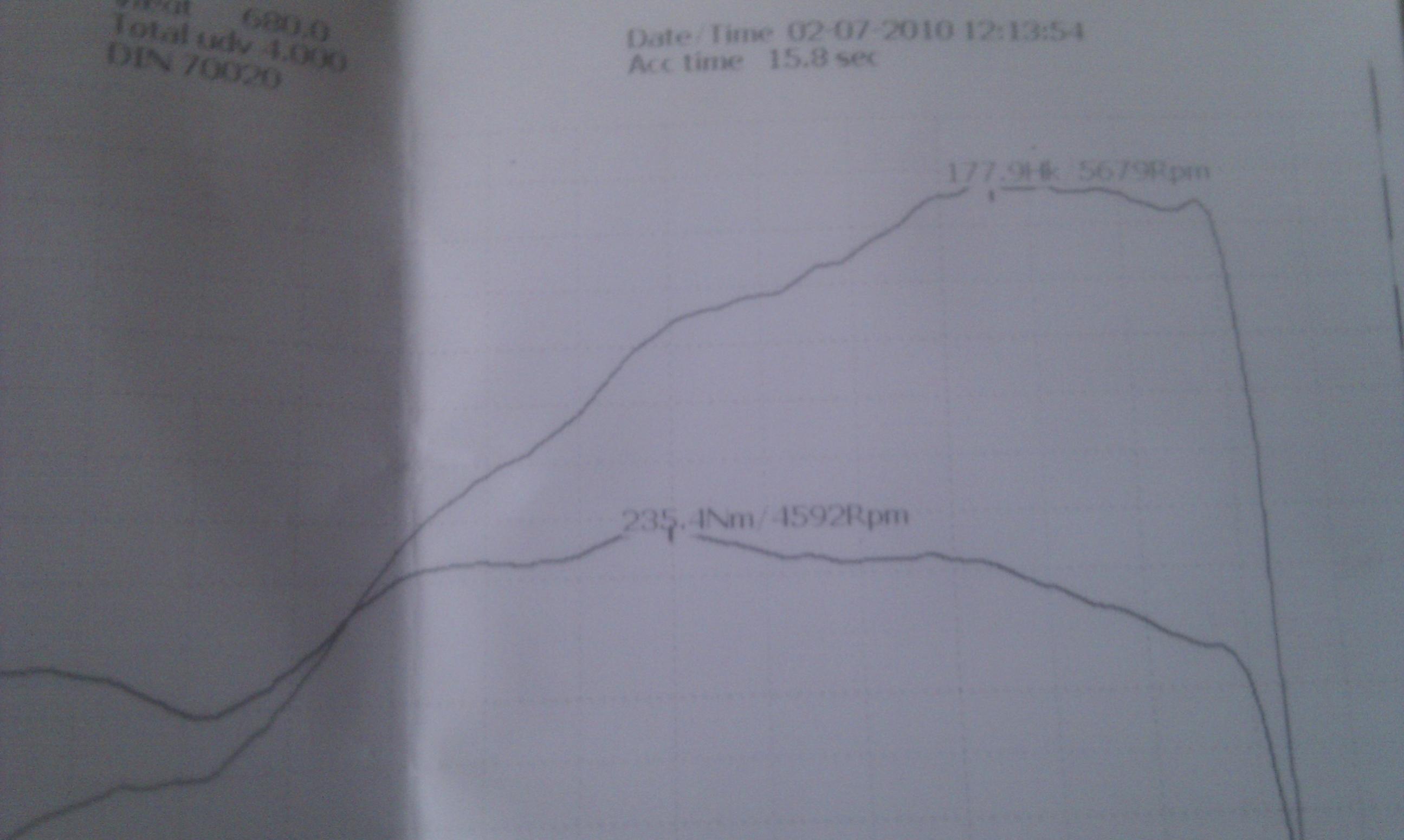

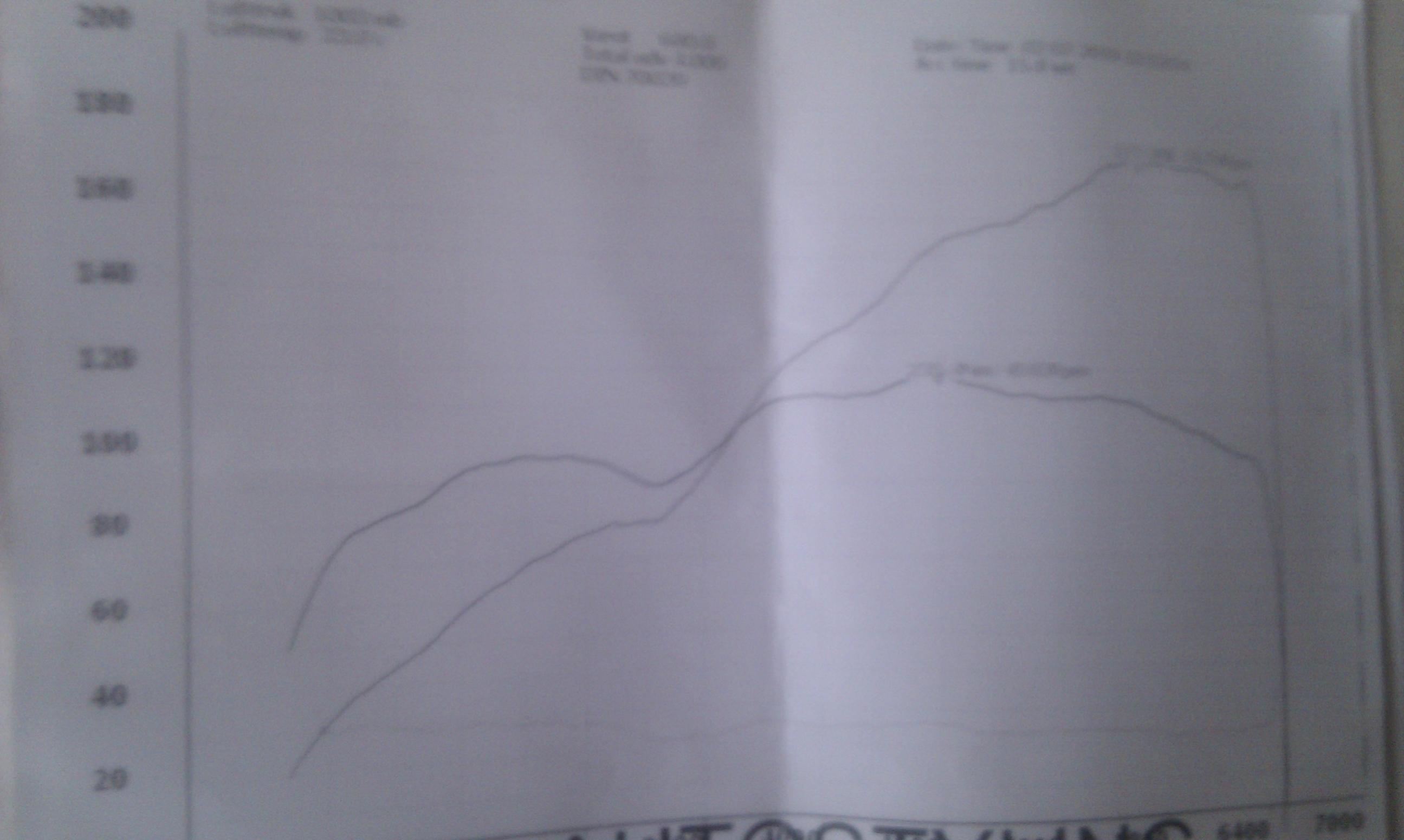

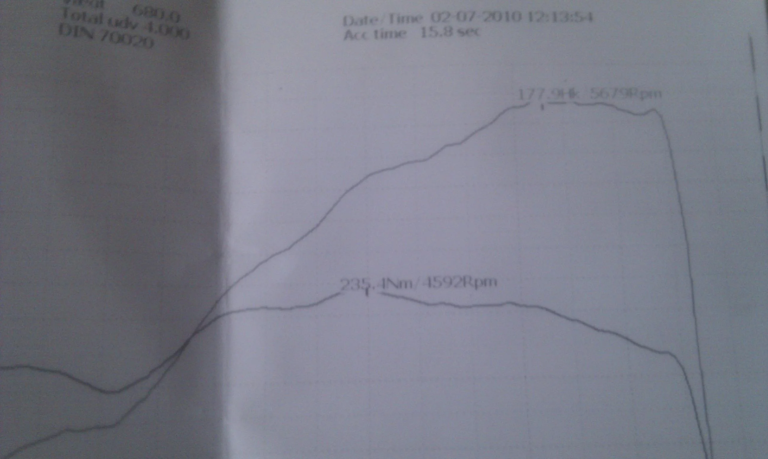

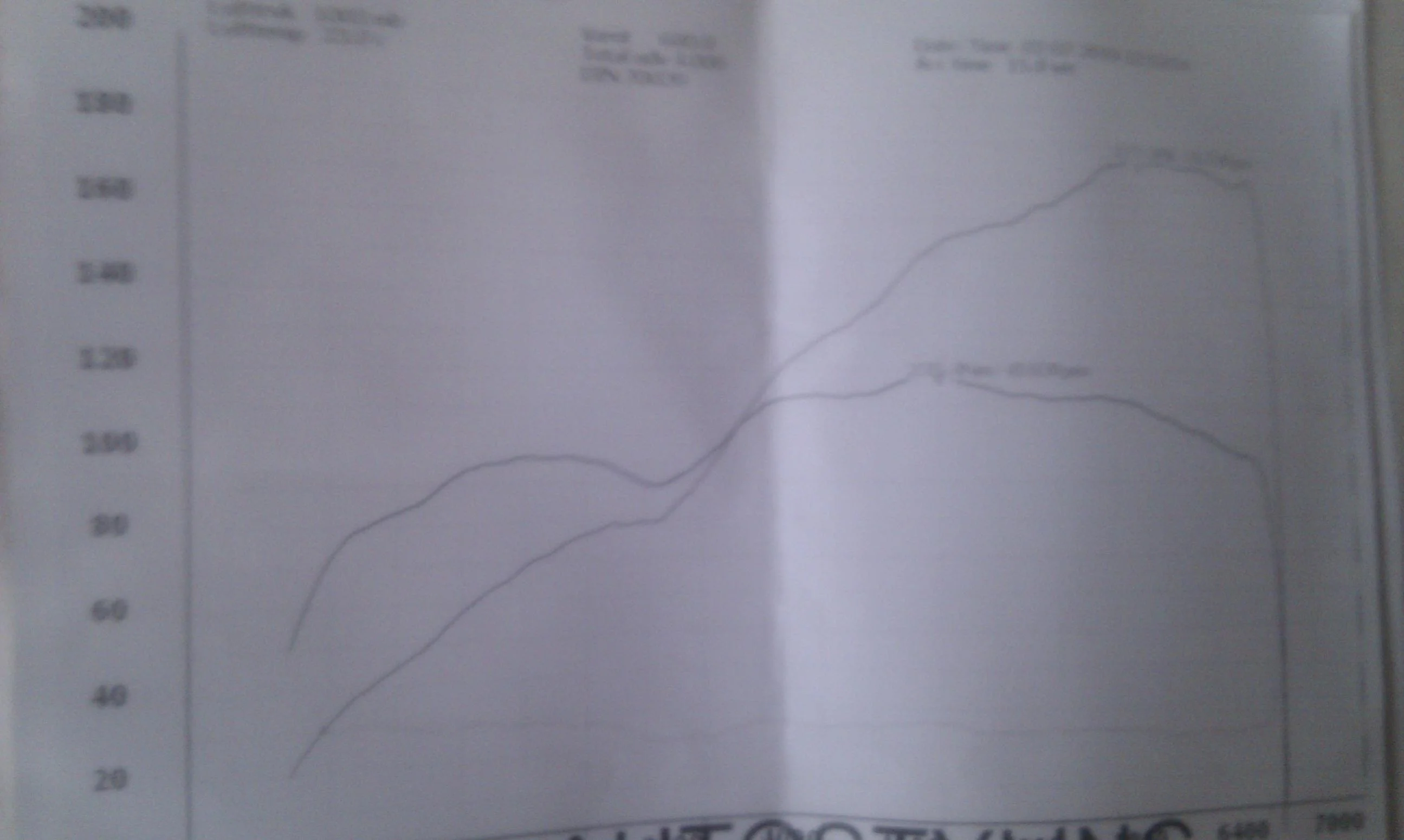

Hi guys.
I think there might be a problem with my engine as the curves look a little off.
Ive got C&B cams, decat, KTR exhaust, matched inlets + a custom map from henk@fastchip.
What do you guys reckon?
Im sorry, i dont have a scanner, only my Desire to take pic's with.
I rev'ed it to 7800 on the RR, but only says about 6500 on the printout, dont now why tho.
But yeah, peak power at 5700, and peak torque at 4600.
Okay, ill try that. Got vacation coming next week (:.
But how about the curves? Could this be down to a mapping issue?
Oh and Fred, could you look at this topic "Camber and tracking. " in the suspension section, pretty please (:
well if the dyno only show the car eving to 6400rpm but it was reving to 7800 i would say the dyno was knackered!
Well it must be.
i'll get a new measement, and i hope you will take a look at it when the time has comes.
thanks.
THey will have just set the ratio wrong, from an innacruate tacho. Happened to me.
My car made peak power at 7950rpm aparently, when the red line on the ECU was set to 8000rpm, yet according to there print out it revved to 8500rpm! mmmm no.
