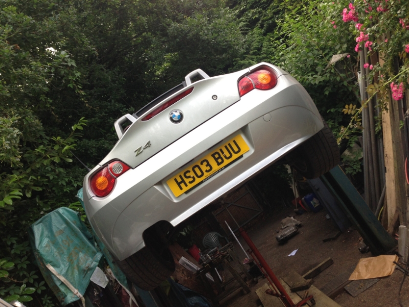

Carried out here:
Then, at the unit last night:

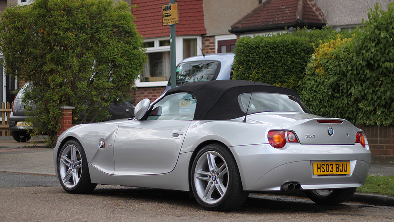

The car currently looks like this:
After the above work, it drives better than it ever has in my ownership, smooth as you like, feels fast as hell, and with the //M wheels and decent rubber, it handles brilliantly.

Who has a 4 post in their garden btw? It's epic.
Ruining it? Do tell? It's getting big brakes, OEM xenon's (orange indicators), wheel refurb, possible exhaust bypass pipe to add to noise, m sport steering wheel, possibly the facelift front bumper... But that's an expensive one, I'd love an m bumper, but I'm dreaming there tbh.
Hang on, you have a ramp, outside?
You have an outside ramp? Outside? :-|
Not me, lol! Just someone I know. Quite convenient tbh!

Thats absolutely awesome! I've always wondered about having one!!! I gather its an all weather effort? Well impressed with that!
Rob
Couple of empty tonne bags over the top of either side when not used, and the belts need changing more often than if it's inside. Other than that I think it's just a normal one I think mate. Clutch was lovely and easy whilst it was up there!
