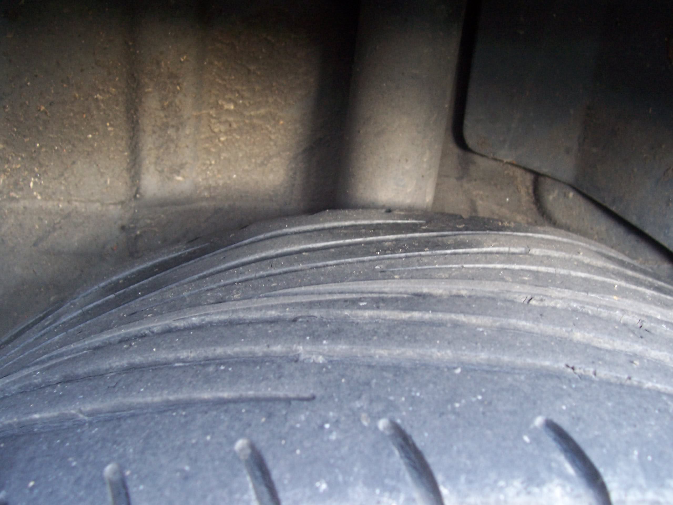

Just went to rotate my tyres and noticed the rears have worn very strangely.
The outer half is OK, but the inner half has worn in stripes, so I now have a 20 sided tyre.
Anyone else seen this? Perhaps I should ask Goodyear.

been a few cases of this recently. Read on a few forums of poor wear on eagle f1s.
shame as theyre generally a good tyre with a very good rep. dont know if maybe theres been a bad batch released in recent months

Shocks are 2 years old and are fine.
I don't see how any suspension or brake problem could cause this as they are even patches only covering half of the tyre. Plus the last tyres did not do this!
  fiesta zetec s mk5 / 182
looks like shocker wear to me, or flat spotting caused by heavy braking, severe balance issue or bearing problem.
  172cup
MINE DONE THIS!!... wore shockingly bad on each outside wall. had the tracking done not so long ago too...
now ditching F1's (as they changed the tread pattern too)... not going back. F1's used to be my choice everytime. Back to good old Exalto's
