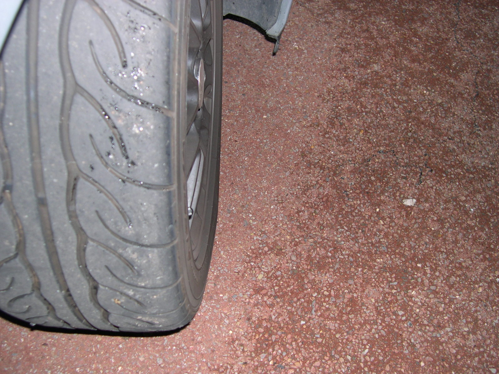

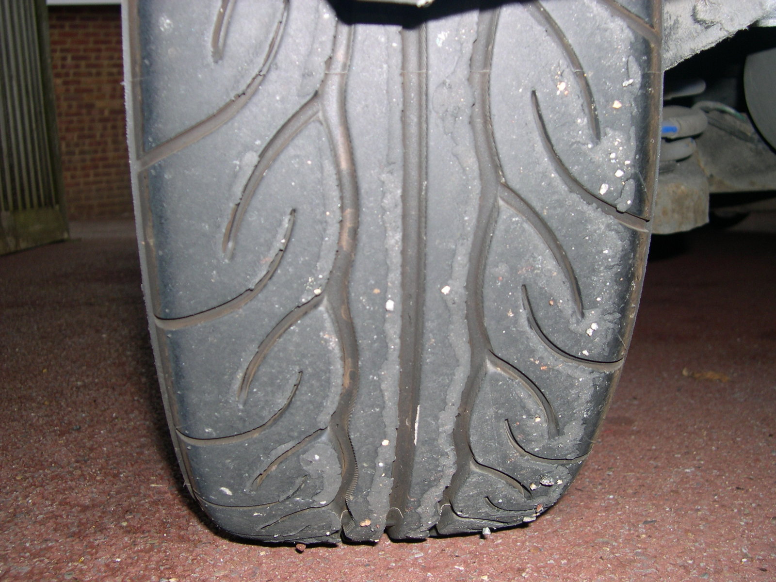

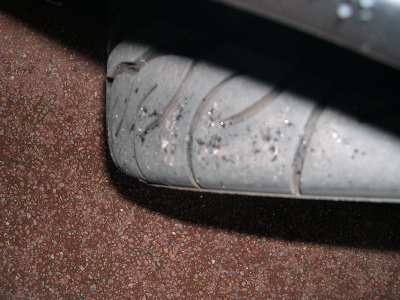

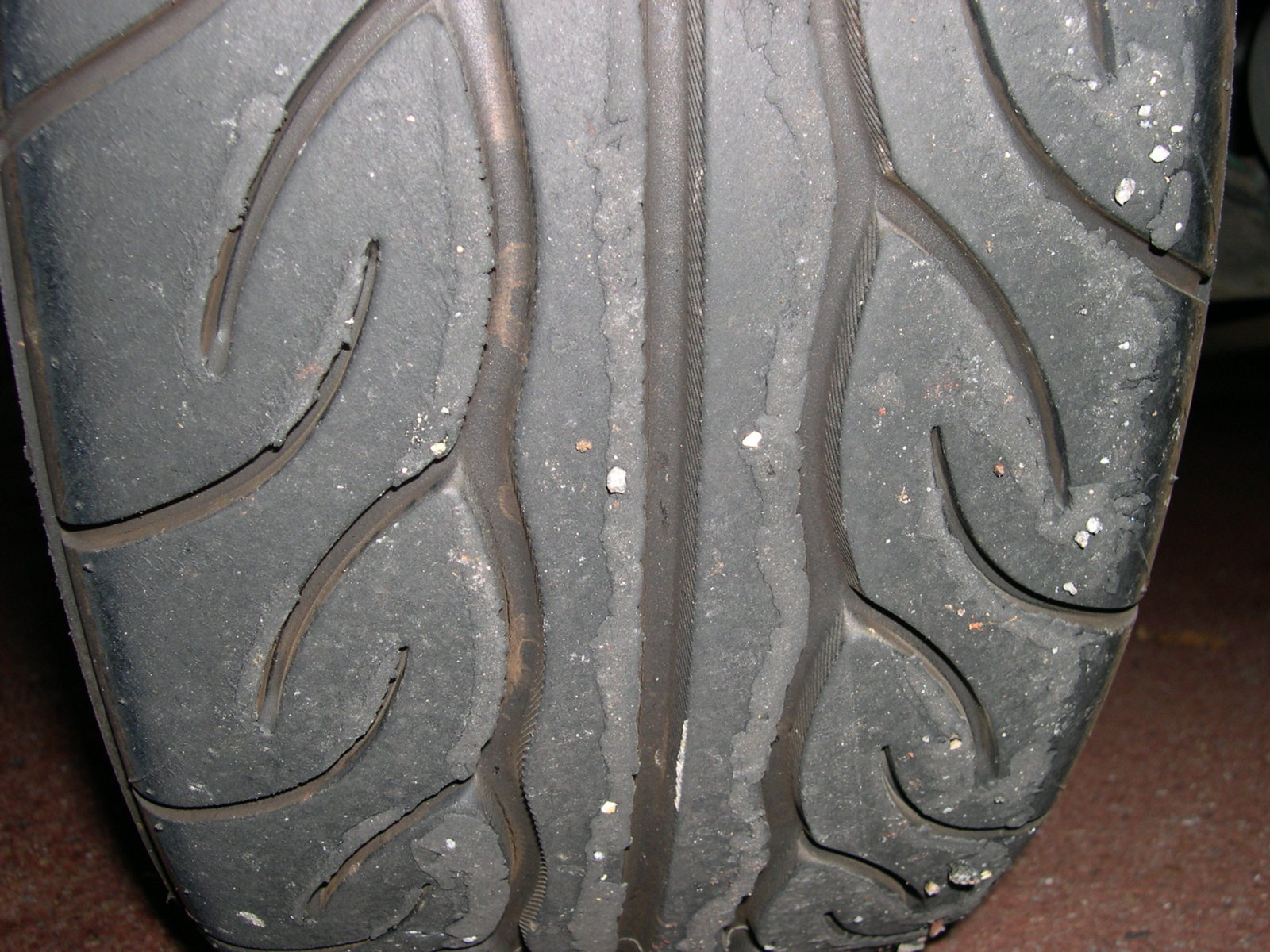

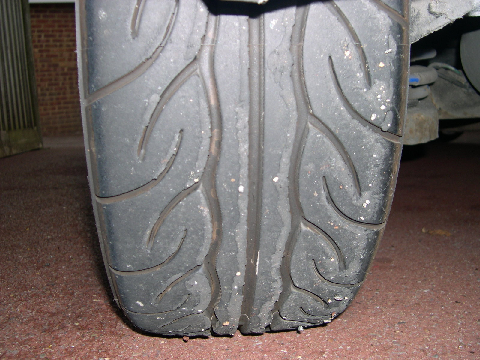

Get a pic up to so we can see for certain.
Above front tyre
above front tyre different angle
above rear tyre
rear tyre close up
both front tyres are the same, and both rears are the same
theyre not as bad as i thought, but who knows how much more they will deteriorate

Are you sure a lot of that (last two pics) isn't just rubber pick up off the track? Photo isn't large enough on my phone to tell. Might find it flicking off over the next few days when you drive around.
I will have another look, but the front tyres has tiny flaps where the rubber has eroded it looks, and the rear tyres the inner tread is very spongy and feels almost "not set". maybe lots heat has melted it. But I will try and pick it off to see whether it is the tyre coming away, or added rubber from the track
Donnington's clockwise and that rear tyre just looks to me like you were having a lot of fun. Working the back when they're hot will roll/wear some of the surface across to the edge of the tread block.
Other than cutting your session times down a little as said above I see nothing on those tyres I wouldn't expect to see myself.
