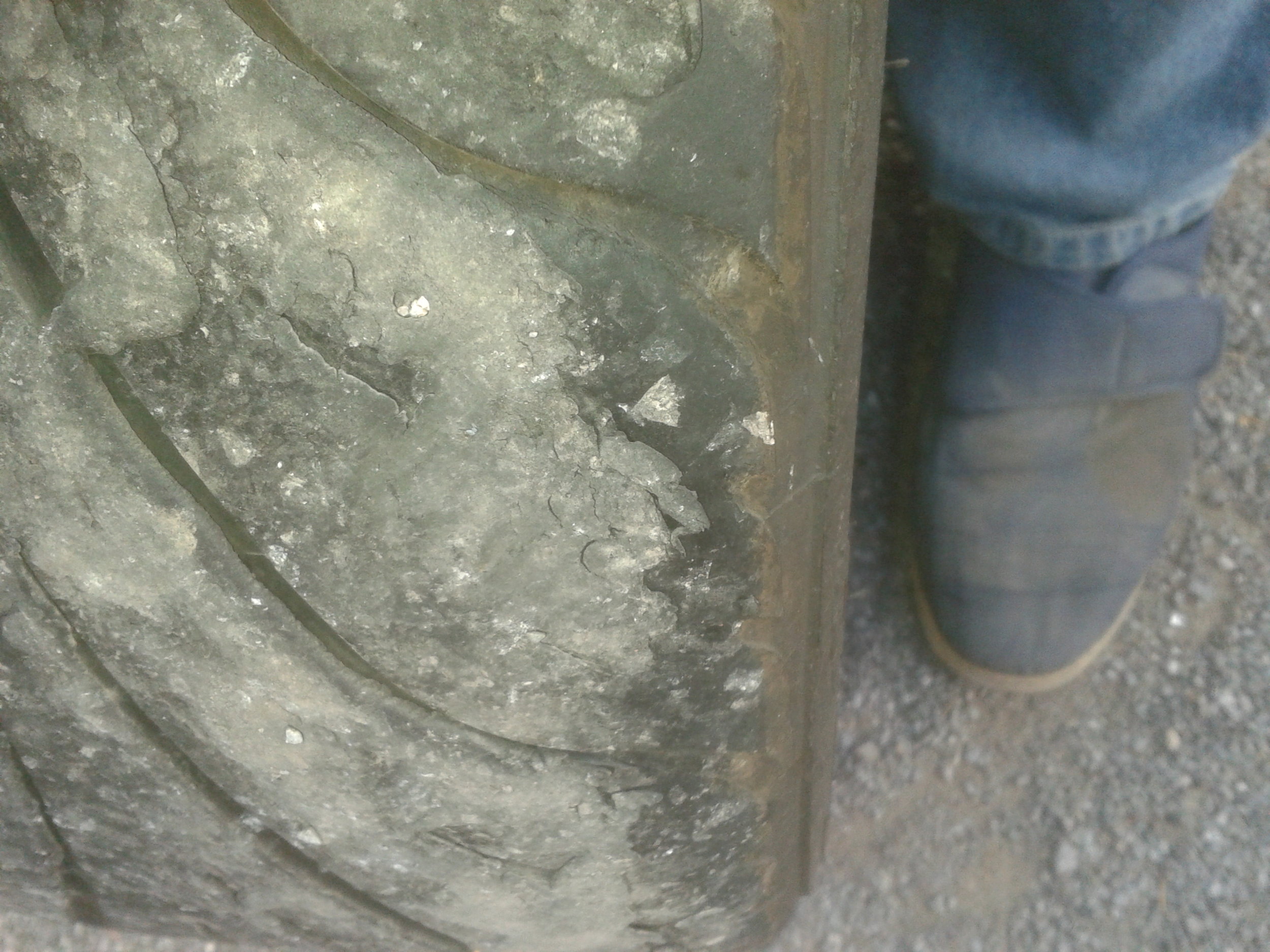

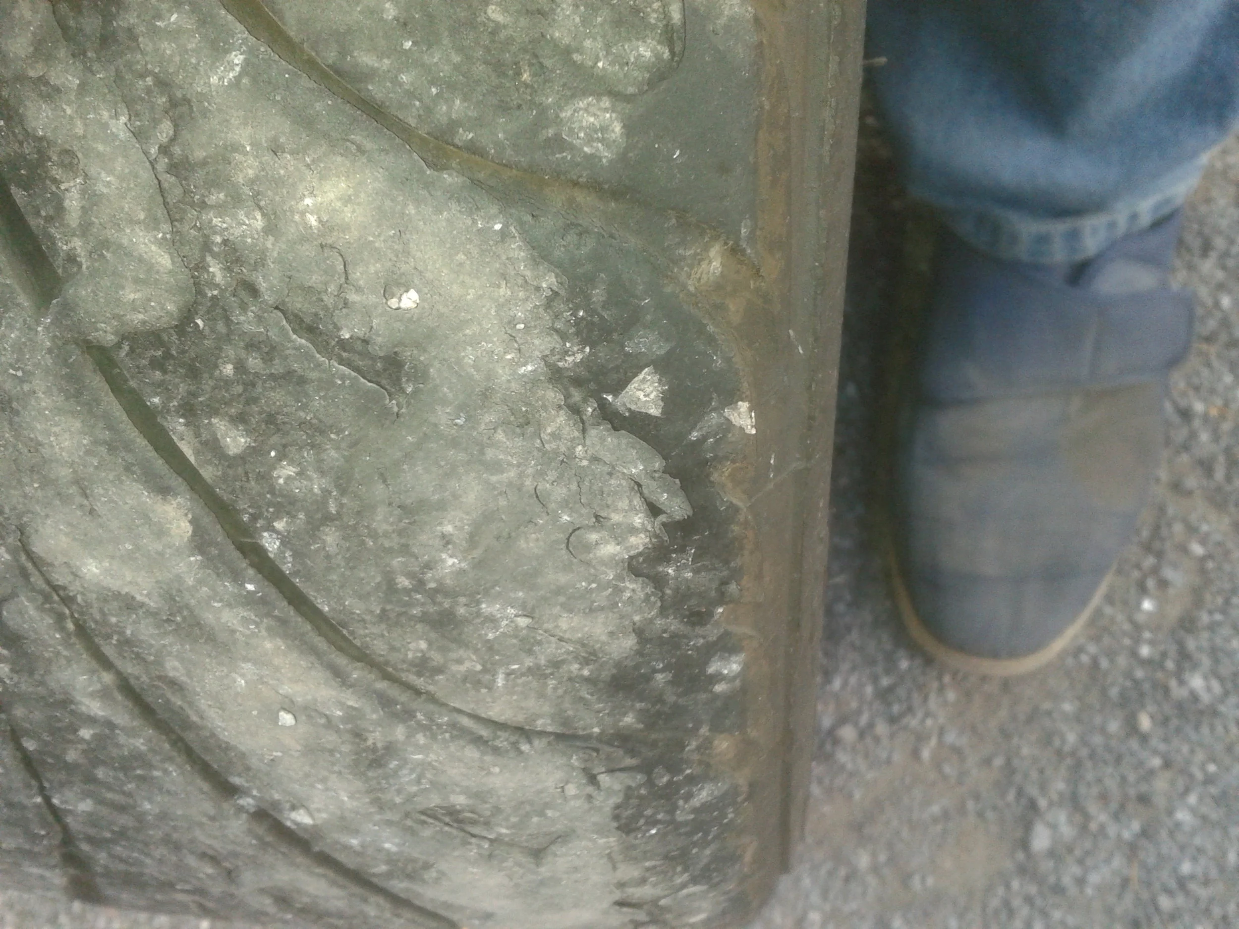

Yoko AD08r track tyre review, after being on the track (Look worse for wear)

Don't know what the fuss is about.....look barely worn to me haha! Outside edge on the front will likely take a hammering, what camber are you running? Rubber on the tyres is just pickup from on track. Proper track rubber tears up far worse than that in no time......a set of yoko a048's fronts will last me two track days before being down to the canvas on the n/side (castle Combe being mainly right hand bends).
Any chance of a photo where the subject is in focus rather than the driveway?
No. CBA. Think Ive had all the comment i need. Auto focus on a cheap camera- I'm no David Bailey and think i got the idea across.
Thanks for all the comments, most were really helpful and set my (Novice) mind at rest :smile:

I know this is late now. I just joined. I'd put another degree of camber front and rear on that set up. They don't look too bad though
Those tyres are perfectly fine, id expect to see far more rubber pickup after a decent trackday. The ad08r wears very well on track imho, its certainly harder than say an r888, whilst giving far better wear/grip than a road tyre like a michelin pss.
Yup. They're a cracking road/track hybrid tyre really. Even great in the wet.
after a month or so of driving on them, they seemed to have cleaned up a bit
They did perform well on the day (Wasnt a full day, just 2 hrs) just surprised how rough they got
They wont last more than about 3 full track days at that rate imo, and thats pricey at around £300 for a new set
Still- no doubt i will find out :-)
Silverstone next, then Lydden

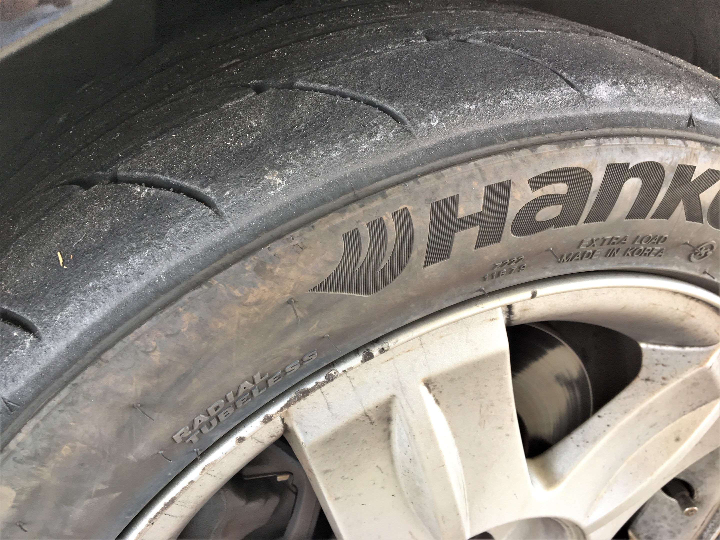

This is what a tyre looks like after it's had some heat in it -- the whole tread should be soft and gooey from outside to inside! (This is the front left tyre on a clockwise circuit.)
