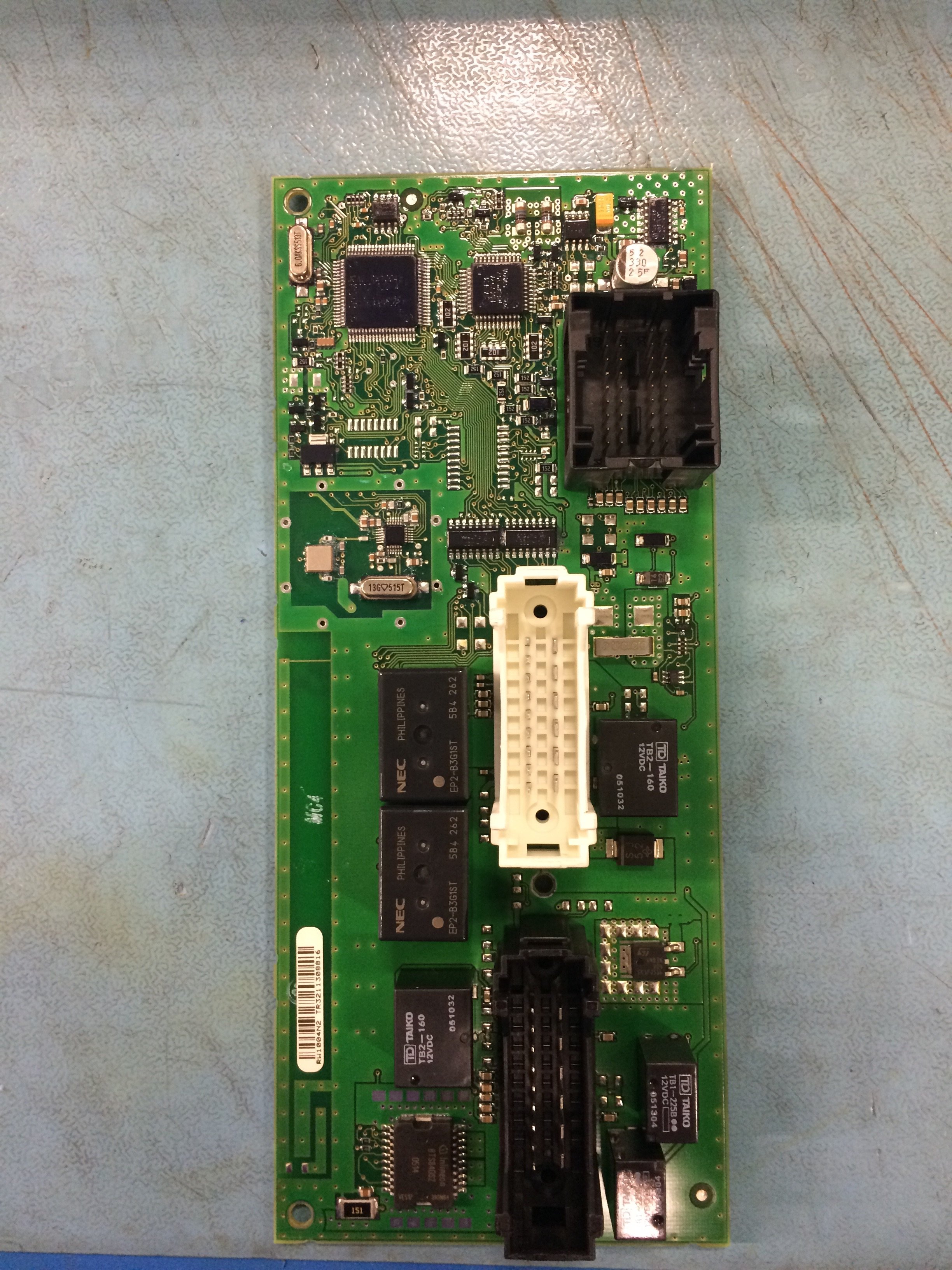

I was told the security chip was an 8 leg eprom, I have 2 at the top of the pic, this is my 182 uch, which one is it? Cheers for the help
