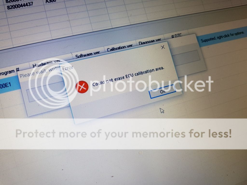

So I got my 172 ph1 renault, and after a few years of not using it I tried to read and write ECU with RS tuner.
I have read the .cal and ecu files without problems.
Here is what I got tho while trying to rewrite the file that I read:

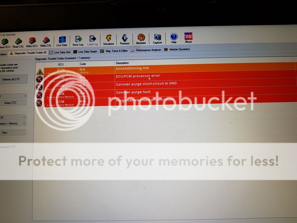

Also, here is the ECU fault I got when I read problems:
Could it be that some wires have problems?
I tried to look for df0022 error, but could not find anything.
Any help is highly appreciated!
Sorry to revive my dead thread, but I have poured in quite a bit of cash into my little Clio, and now the engine refresh part has come up.
Maybe anyone has a clue how to fix my problem?

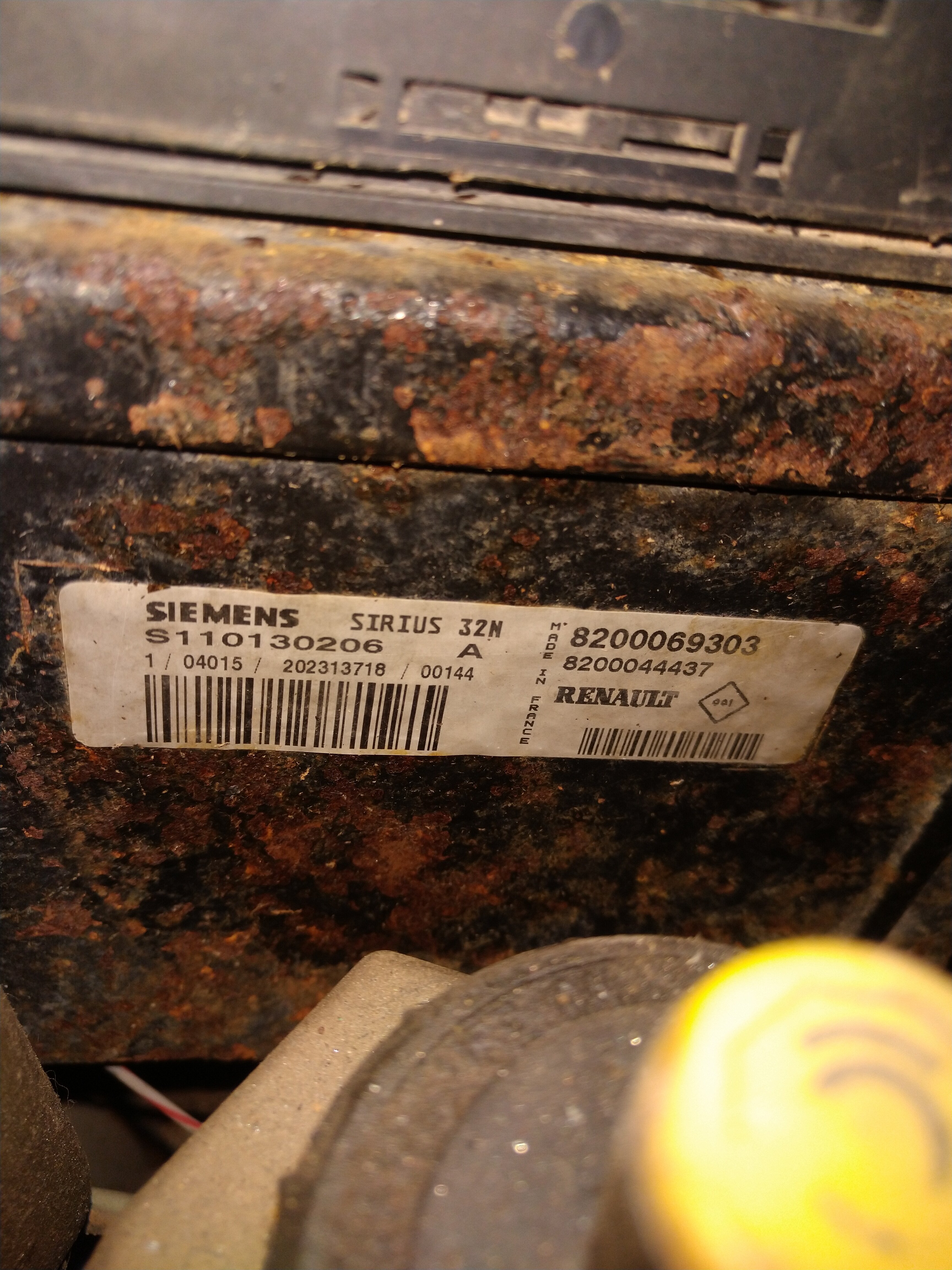

Here is my Ecu code on the back if that helps.

It’s possible the ECU has already been mapped and is locked out to the RST. It’s also possible that the ECU is goosed.
Can you erase the faults, or does it give you an error here also?
