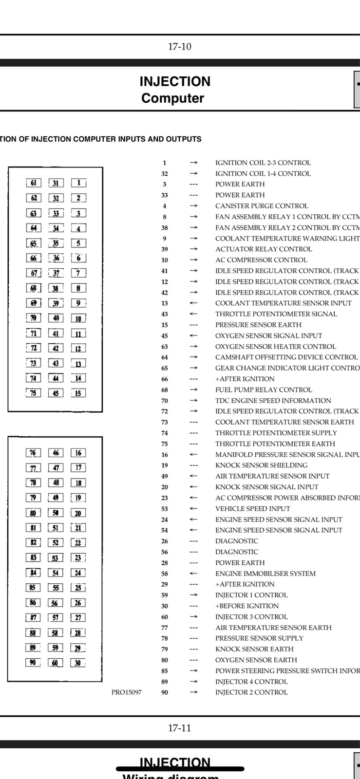

  Clio 12. 16v 2005
I believe the 4df 712 engine has a Meganeti Marrelli 5NR ecu
No ECU wiring given in Haynes Manual. for CLio 2 1.2 16v 2003.

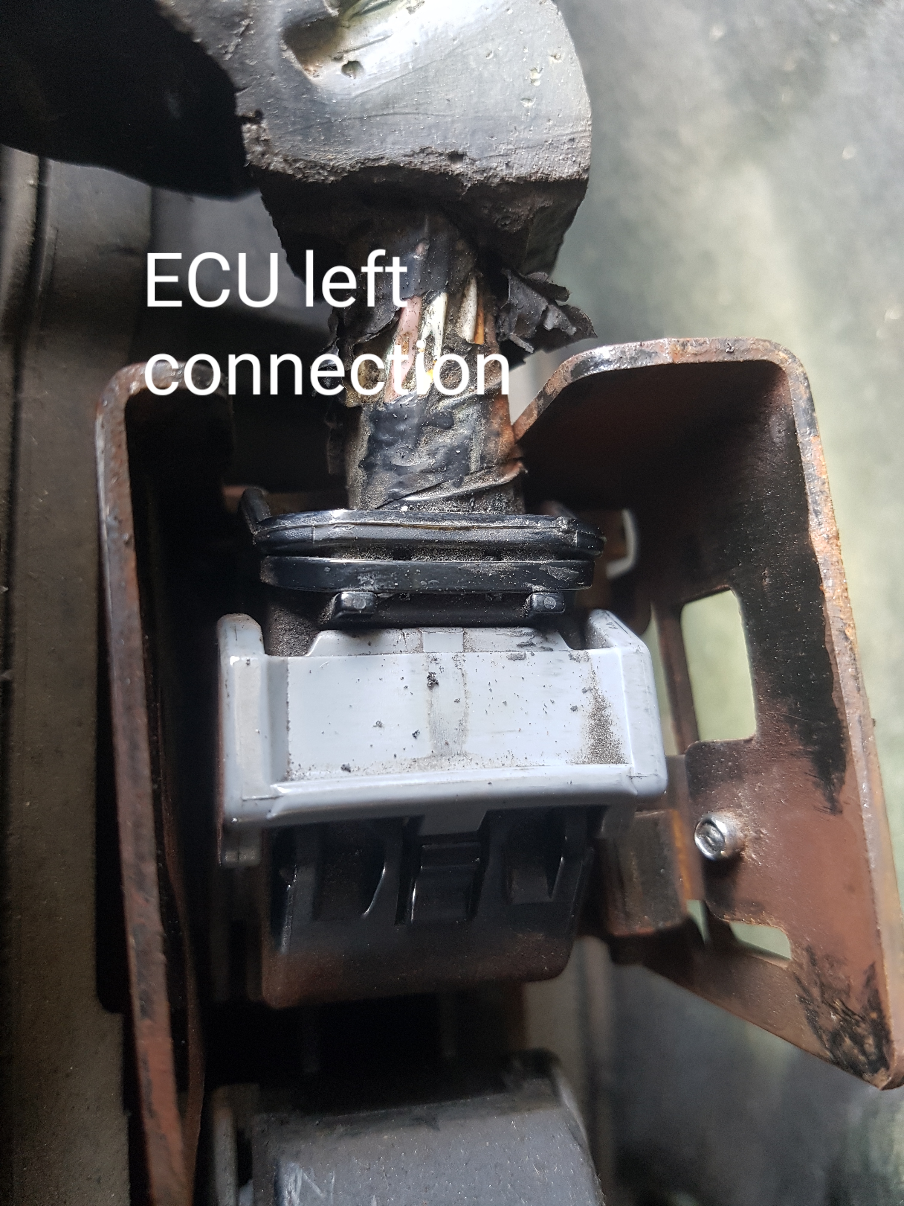

I need to trace signals and check ecu.
