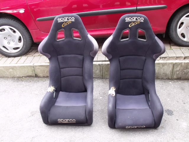

Just picked up some new seats :) going to be cleaned and repaired, and the backs painted a nice bright shade of green :D
Also got my 888s ready to go on, so should be done during the week.

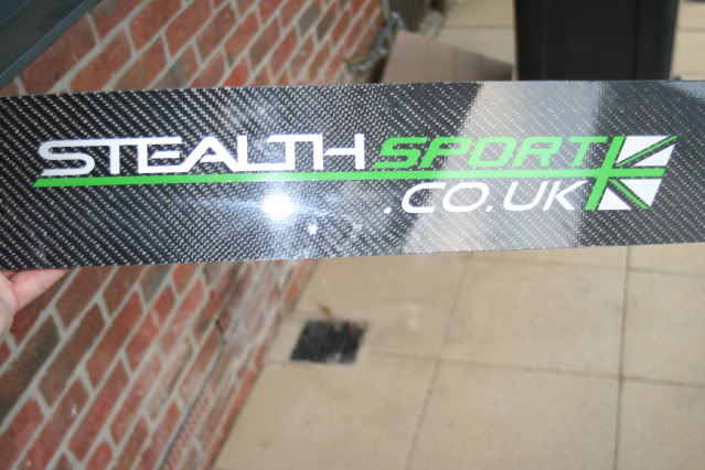

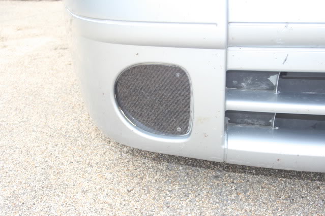

Right,
few more updates.
today had the vibratechnics engine mounts fitted, brake fluid changed for AP 600, and some carbon fibre blanks made up for the foglights.
have decided against the seats, as moneys a little tight and gonna get something a little more special in a few months time.
pics:

how much was the seat repair going to cost mate? looked at a few dead sets myself
  ph1 track weapon
Re: Eds ph1 172 - The soon to be controversial project!
they were looking at about £40 to repair them

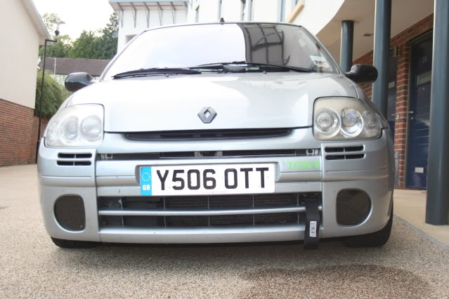

Right,
so for the fruits of a days work!
day started by me and my mate Nick taking his focus RS up to X-Sport to have his coilovers setup and the car cornerweighted. Turns out that the whole setup was wayyyyyy to low, and weight distribution was appalling! An hour later, and Nick left very very happy with a car thats handling has been totally transformed!
At the same time I had my TRS tow strap fitted. Thought i'd go a little different to the usual 'Si' tow eyes and run a strap. Like how it looks, especially with the lime green tow sticker (thanks Ady). in the pic you can also see the carbon fibre fog covers. Really pleased with them!
Next, I decided I wanted a change from the Oz F1s that were on the car. Having already bought a set of 888s off me that she needed delivering, clio-girl almost bit my arm off when she got wind of the fact mine were for sale. I want to run some crappy wheels so i can save a few quid towards the Rota Slipstreams that i ultimately want, and turns out she had a spare set of mk1 16v wheels going, so a price was agreed, and today i drove down to Bristol to sort everything out. Tyres were fitted to the mk1 wheels, then the F1s taken off and mk1s fitted. There were a few worries about rubbing issues due to the wider offset, but all turned out to be ok. HUGE thanks to clio-girls other half , Gaz, for helping me sort everything out when i got there
Not content with silver wheels, next stop was Halfords for a few cans of satin black. Not being one for doing things properly, rather than mask the wheels, i cut a 15" circle out of a piece of carboard, laid it on the wheel and sprayed away! Now obviously wheels are far from perfect, but they were dirt cheap and are only temporary so i'm hardly fussed. Havent had a chance to use the 888s in anger as there was traffic pretty much all the way home, but theyre definitely a lot stiffer!
And finally, I'm off to Brands Hatch on Tuesday. Cars ready to go now, helmet on loan, all levels checked, oil changed, brake fluid changed. As some of you know, I'm mates with Matt, owner of a certain business, so I'm doing a little promo work using these rather funky plates

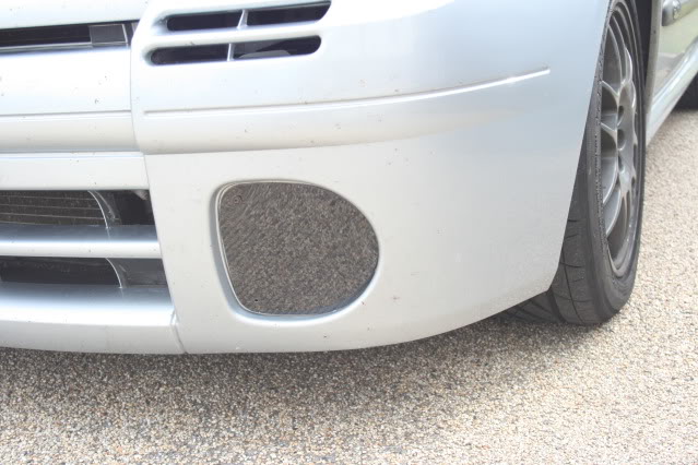

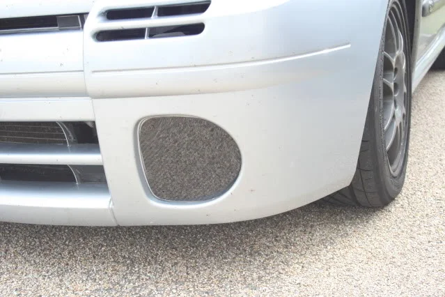

Why blank the fog lights when they can be used for brake cooling etc?
  ph1 track weapon
because in all fairness i wont be doing any more trackdays til next season now i shouldnt think, and the gains to be had from cooling ducts to the brakes is pretty minimal, so didnt see much point really.
have got a spare set of blanks i can hack up if needs be but prefer the look i have tbh

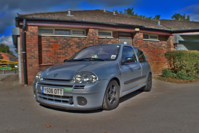

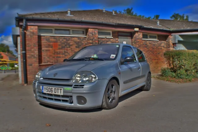

few pics done by a mate. he was messing around with HDR
