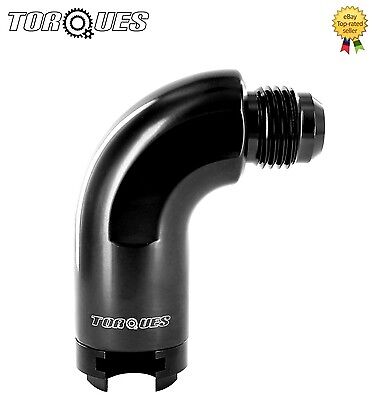

I’m sure someone has used these before but I can’t seem to find it.
I am converting to AN hardline and braided line for the fuel system.
so require an adapter that connects to the fuel tank connection and converts to AN fittings. anyone had success with finding one that fits the renault fuel tank take off?
scotiamr2t
  Mazda 2, Ph1 172
@AdDaMan I tried one version they had and it doesn’t locate properly on the renault fittings.
it seemed the locating ring that is moulded into the renault pipes doesn’t go into the torques fitting far enough for the adapter to actually click into place
Brigsy
  T.Turbo
Its actually a push fit with o rings inside, that splits at the bottom and threads together. Nice bit of kit fits on the meg rs sender and rail ok, from memory clio fuel pump outlet is identical to meg.
