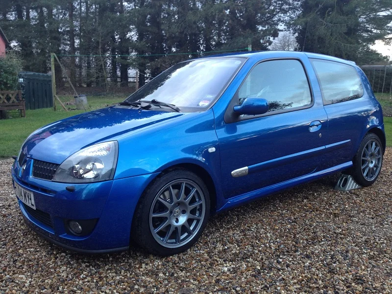

Here is when I first fitted them, they sit exactly the same now. Bare in mind these springs are over a year old anyway.
The AST topmount will lower the front quite a bit due to them being quite a bit shorter than the standard mounts. When I fitted mine the front end dropped about 10-15mm.

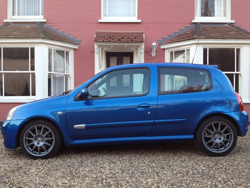

From the picture you posted, does look a bit weird. Although going by the Sportline thread in Clio Media, how much they seem to lower by is a complete lottery anyway. But yours does definitely look weird, Rear looks standard height?

I think the rear is about standard height! From the ground to the bottom of the wheel arch is 610mm. Can anyone measure theirs?

My front arch from ground is 595mm and rear is 610mm
Just out of interest what are yours?

About 600 both Arches but mine is on 17's which are 4mm different in overall diameter inc tyres so less 2mm off that makes it 598ish if it was on 16s.

So it seems that mine sits alittle high at the back anyway then at 610?! Strange. And its not as if they need to settle as they are over a year old.
Danny that looks a perfect height. Can't help but feel that's more than the 25mm stated in your trader section?

says 25mm in the listing, but it's a bit more in reality. Pretty consistent though
