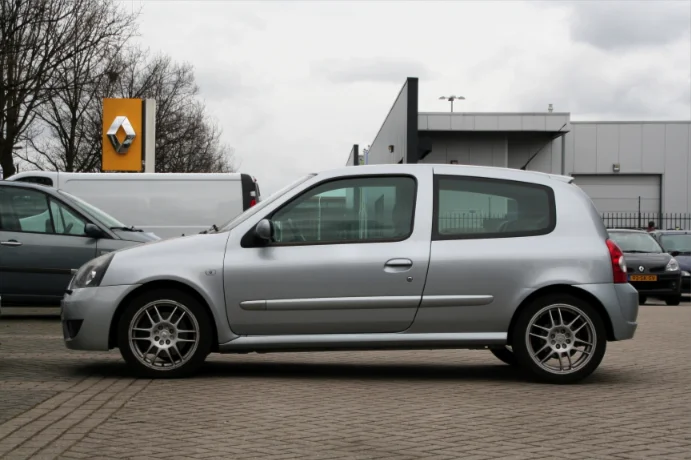

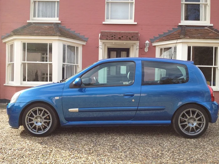

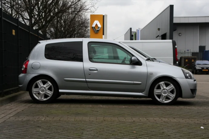

  Clio 172 RS2
To illustrate the drop left Eibach coilies, right standard coils.
Mechanic's Clio 172 @ local Renault service center compared to mines.
