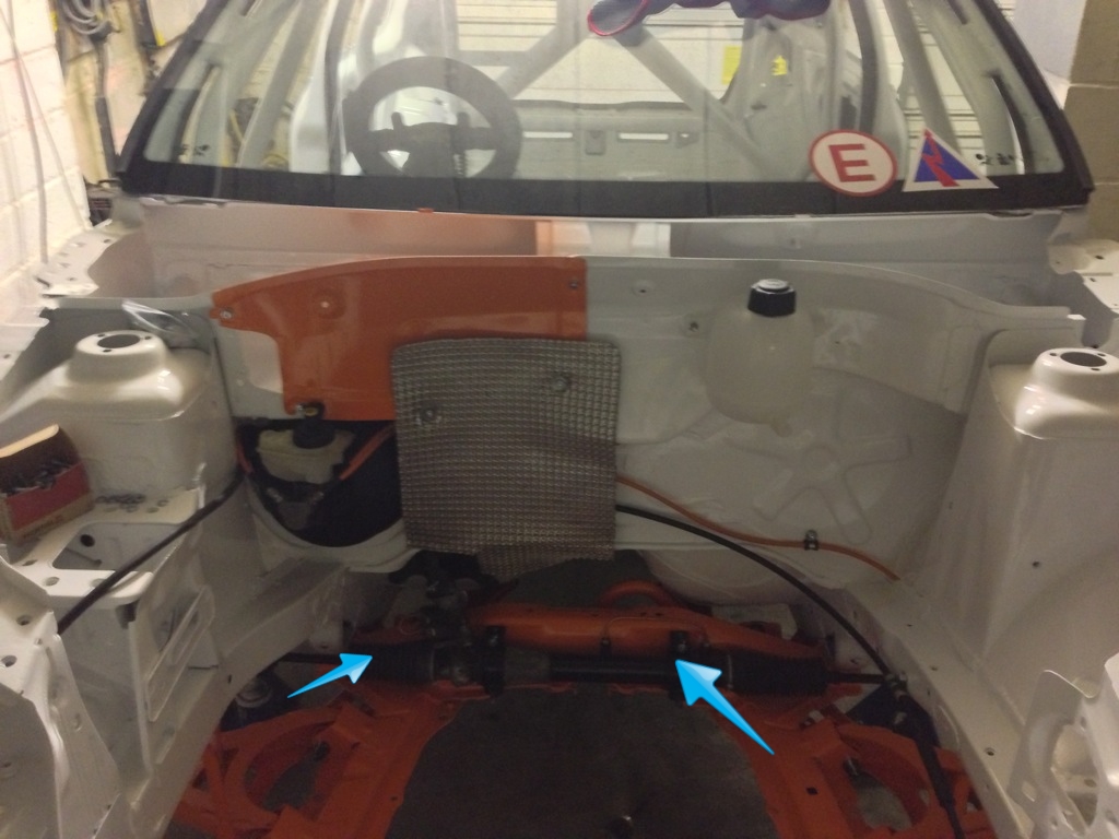

I was looking through BigAsh's thread and noticed he has two parts looped on his rack I only have the section on the right of the pic looped and have all 4 ports on the left blanked, Im not sure if this will be causing a resistance ??

Neil I removed all the fluid out of mine and then looped the rack. Are you sure it's not air locking or vacuuming? Does it do it in the same spot everytime?
On the video it sounds like your tyres are causing a resistance on the surface it's sat on. Mine does it as well. Try it on turnplates if you've got some as that will rule out the sticky tyres. Easy enough to improvise if you've not got any though.
The 2 small pipes on the rack at the column end are just a feed/return dependant on which way your turning, so I don't see them causing an issue as the main assistance is done on the column. The rack filled with fluid and a looped pipe I do see being the potential issue.
Inside the steering rack there's just a solid disc on the on the actual rack itself and a nylon seal that runs inside the body to seal it. They're a piece of piss to strip down as well btw. I've got one in bits currently to pack full of high temp grease.
