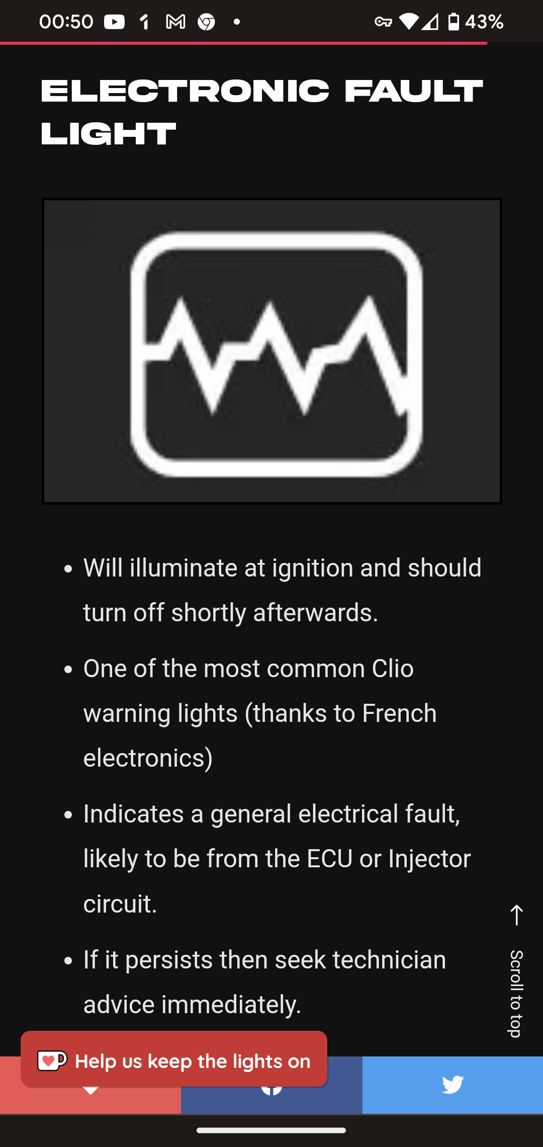

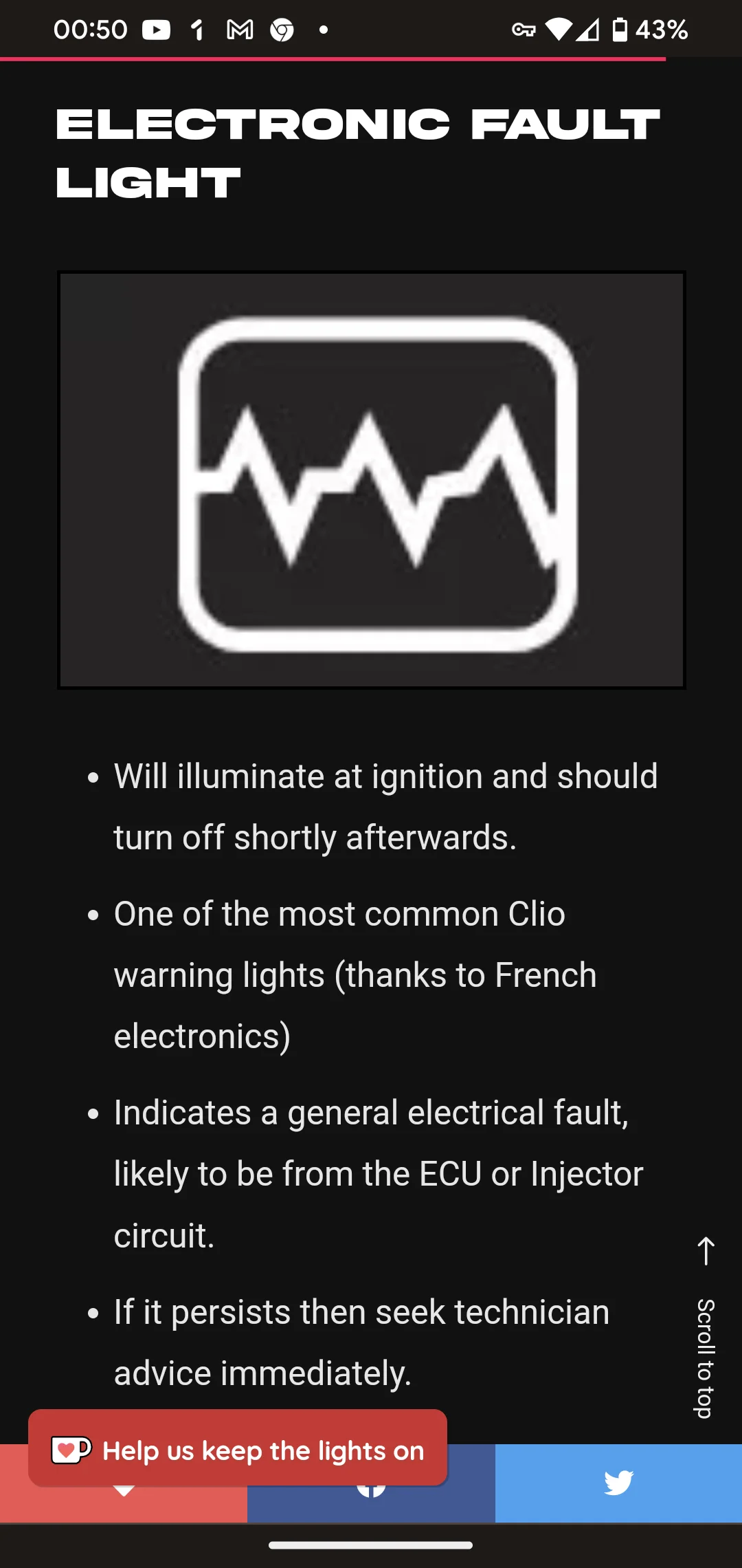

Hi, have the wiggly electric light on the dash of my 182. Have plugged in to the ecu and no faults are showing- going to try with another reader, but the car will only rev to 3k.
happened since I (stupidly) washed the engine of all the road salt.
Any ideas on how to diagnose the issue? Or any solutions.
