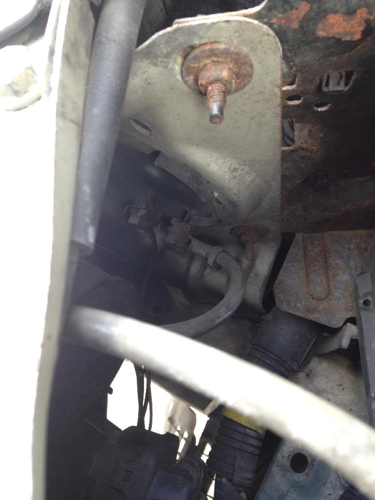

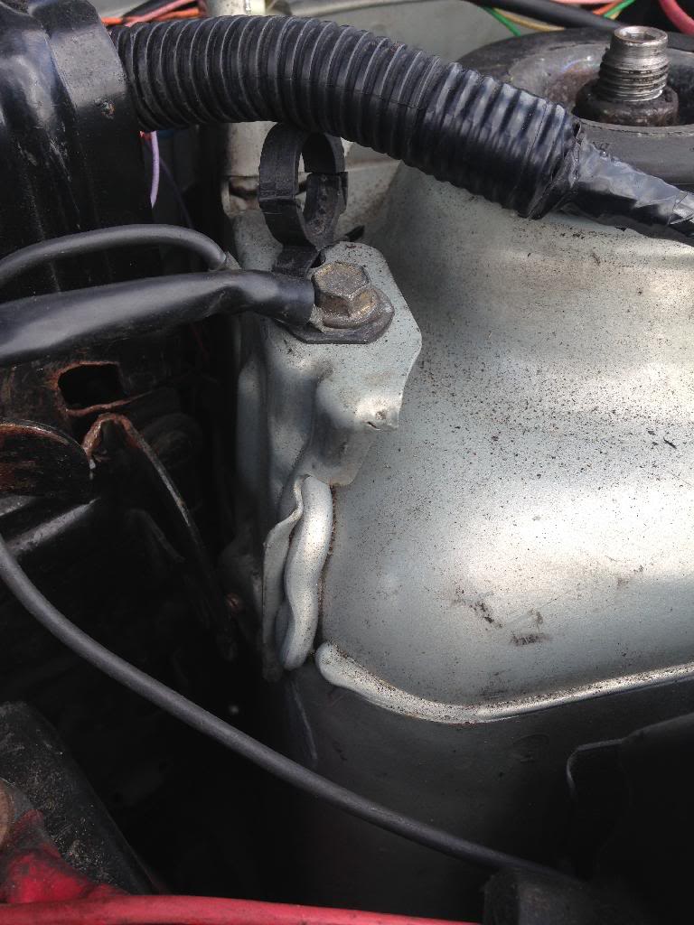

An earth will just look like a cable that's bolted onto the body like this (freshly taken)
Ah okay thanks for that :) ill check them over and just scrub them a bit with a wire brush/wire wool and electrical contact cleaner when I buy some? By the switch, do you mean the stalk?
