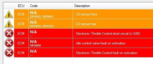

Plugged my mates 1.2 into my RSTuner, because he'd been having problems with the car losing all power and not being able to accelerate above 30 mph.
The three faults that look the suspect are the bottom three (why does only the ICV fault have a code?)
Am I right in thinking the Electronic Throttle Control is built into the accelerator pedal?
Is it a case of replacing it?
Is the idle control valve issue linked?
Any tips on how we can sort it would be great!

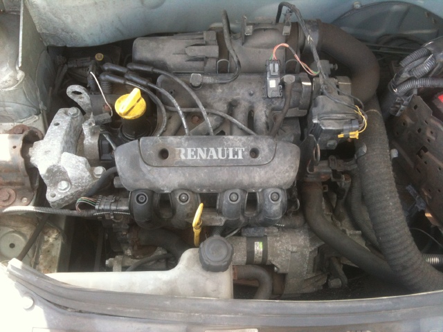

This is his engine (if it helps)

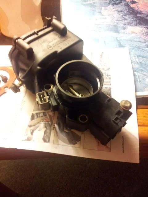

Removed the throttle body housing, but it doesn't seem to be like any I can find for the d7f engine on Ebay?
They're all metal but this is plastic?
