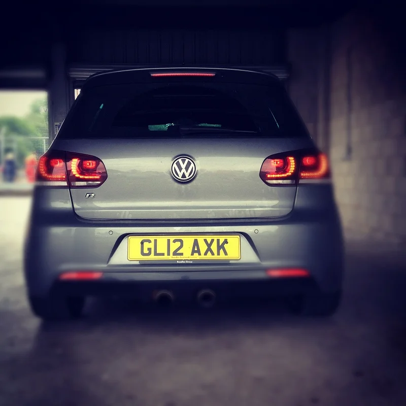

With the car seemingly all ok, the next trip was to Oulton Park for a track day, where i met a few CSers. I was meant to be getting into a rented Exige S, but it was damaged in a motorway trip on the way up! So suddenly, the Golf was called into action until a replacement car was sourced.

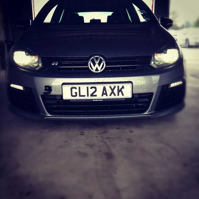

What was the Golf like on track? Well, as you'd expect really. Lots of grip, fail safe handling which would take any kind of abuse. Couldn't seem to disable ESP fully, but if you drove it sensibly, the light didn't flicker. The brakes must have got hot though as i am now missing a centre cap, which must have popped off!

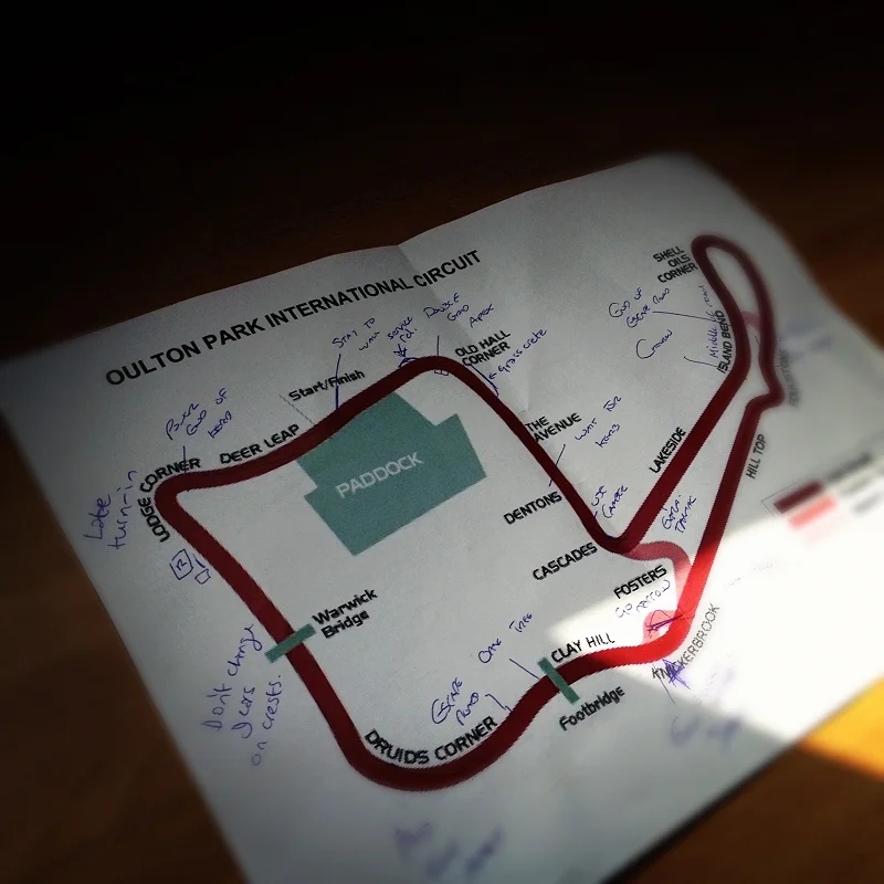

I used an instructor who helped me to make notes for the weekend; i learnt a few new lines and the valuable pointers in case it was wet.

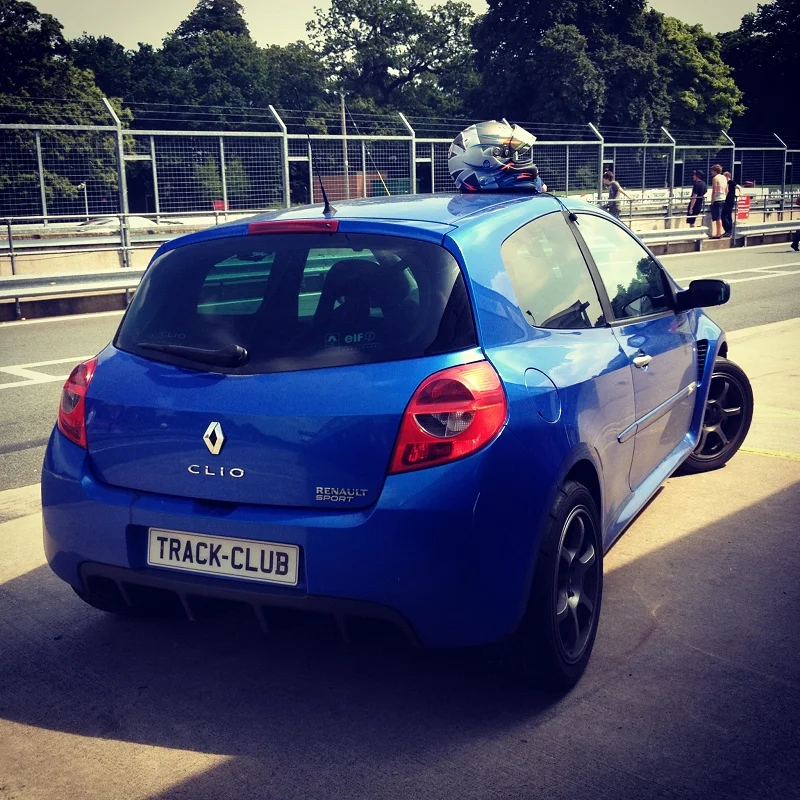

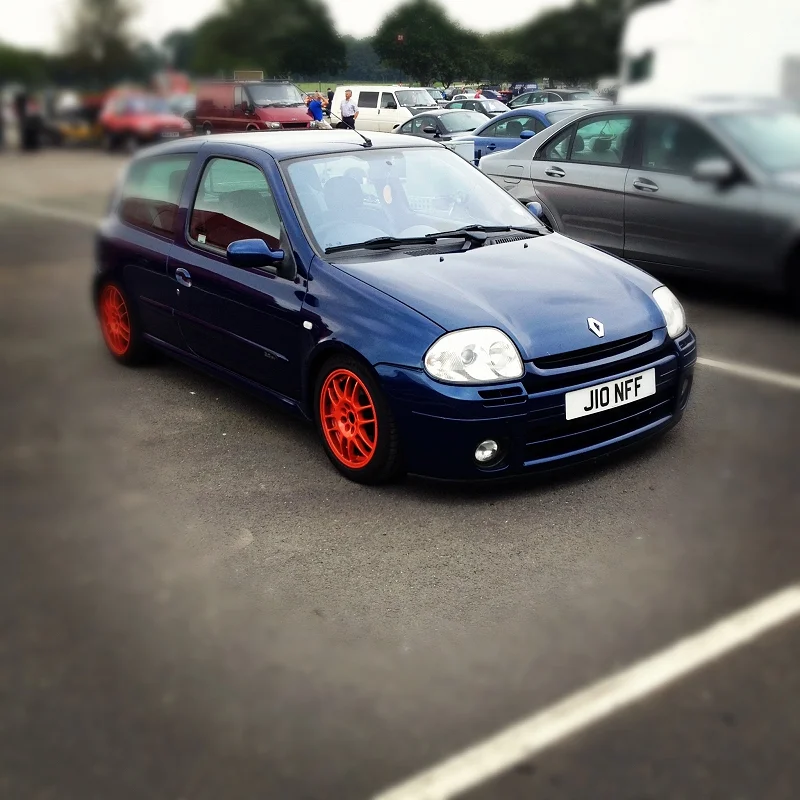

In the afternoon, i was given a Clio to use. It was a 197 with a stripped rear and rollcages. It also had wider wheels (Rotas!) and AO48s. The comparison with the Golf is, again, as expected. The Clio was of course more nimble, and adjustable (or less forgiving, depends how you look at it). It was however gutless, particularly noticeable at Oulton which has a few uphill slogs. I think it was reflective of its hard life, as some newer 200s were noticeably quicker in a straight line. Nevertheless, it was still reasonably quick over a lap and i was pushing a couple of Caterfields.

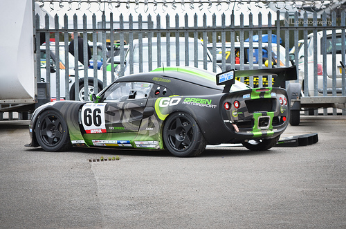

Saw this Parked up on saturday with the diffuser off and I was wondering what was wrong, its a shame as I was looking forward to seeing it on track too, unlucky mate:dapprove:
Looking sorry for itself-
Broken Elise by Niall97, on Flickr
Nice photo Niall; shame it was in that situation though! The team steam cleaned the engine bay i believe and just left it there to dry/sulk.
