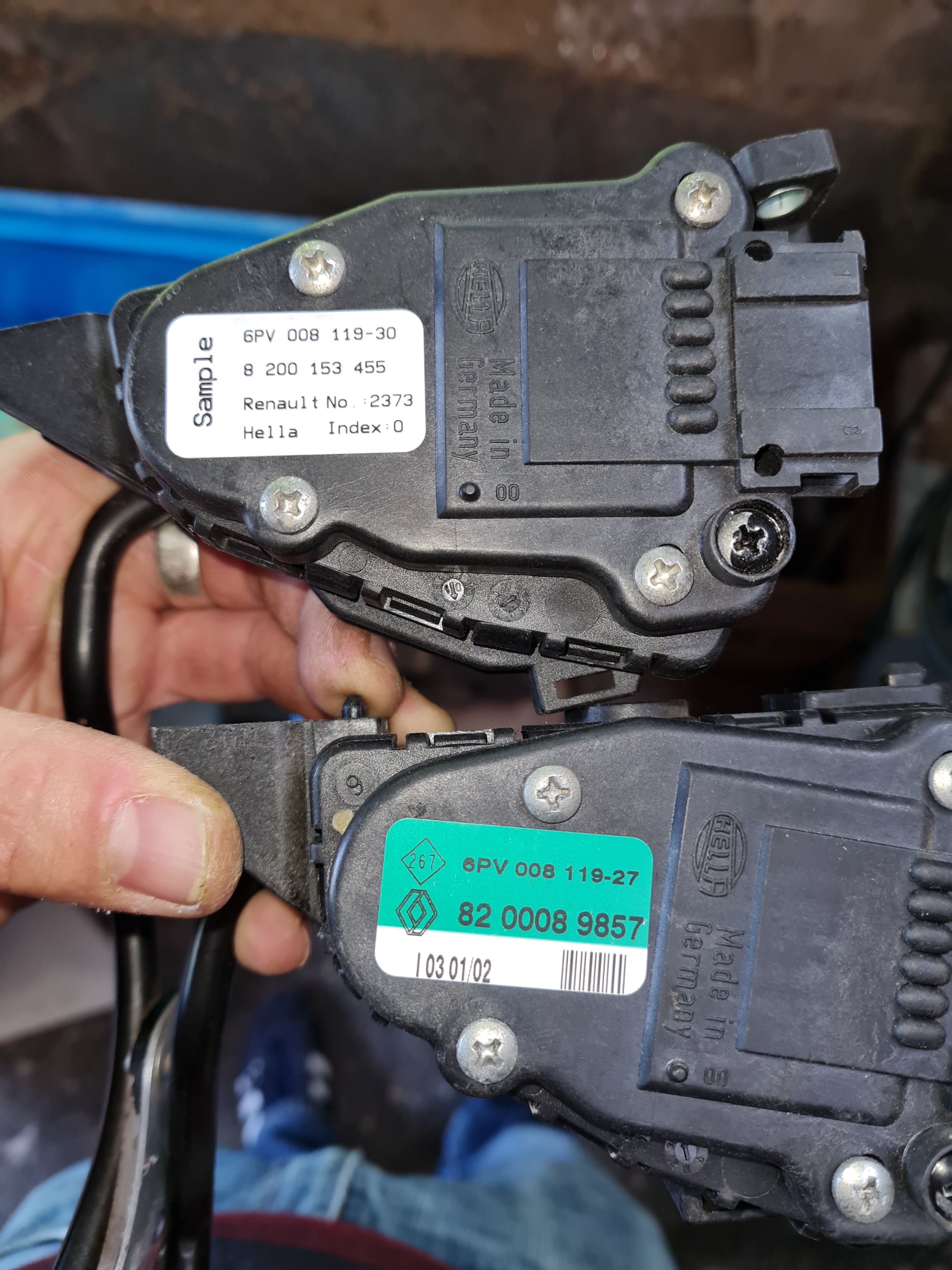

I've had this problem before and thought I'd sorted it but lately my car is going into limp mode until I turn it off and back on again. I've gone through the entire fuse box cleaning all plugs etc and checked the throttle pedal plug but still not sorted it. I've got a spare pedal so might try swapping it to see if that solves it.

did Renault revise the throttle pedal at some point? These have different part numbers

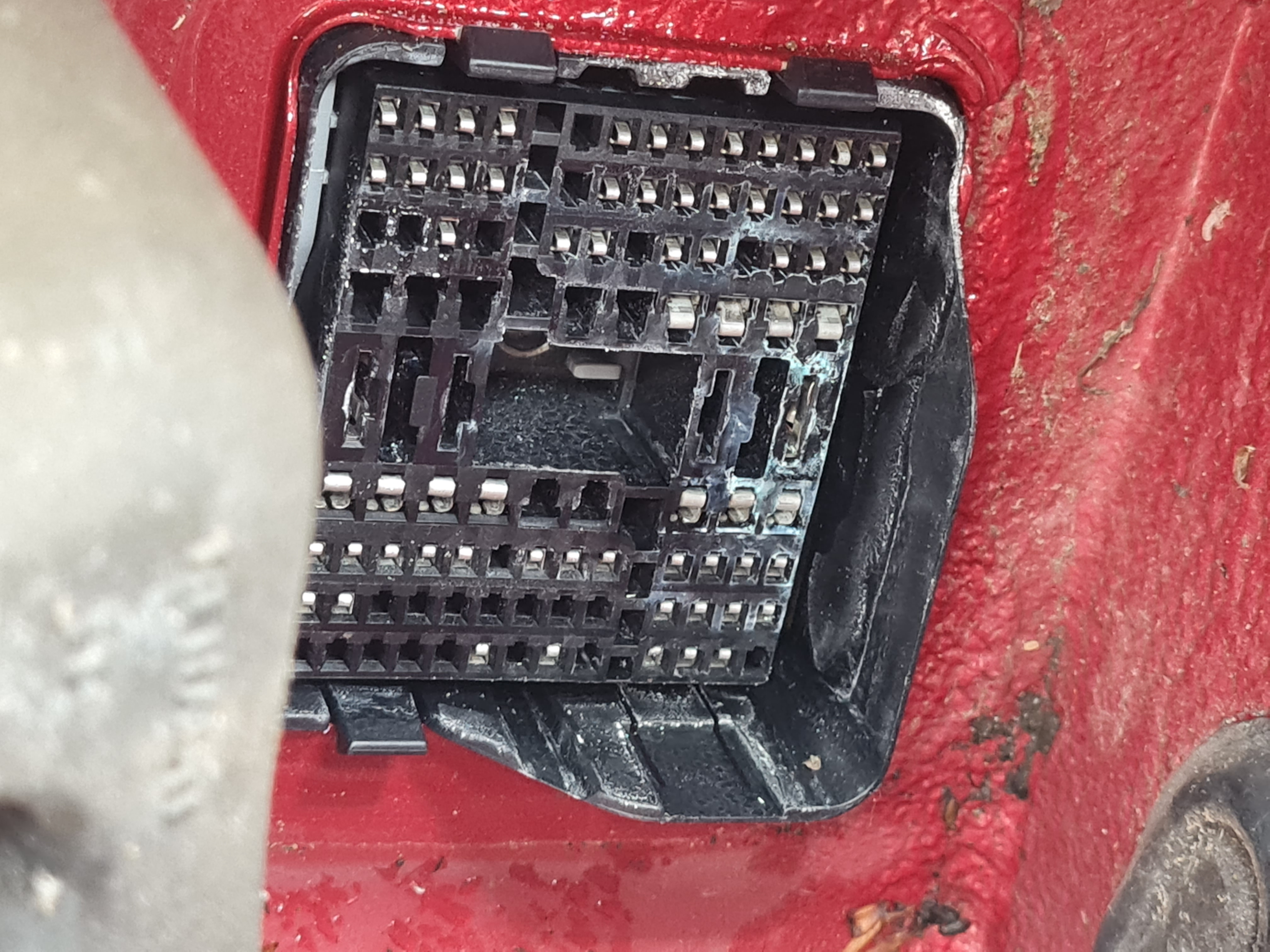

Cleaned the white plug in the fusebox with 1000 wet and dry and packed with silicone grease as suggested by @Touring_Rob. Wait and see now, the only bit I couldn't do was the socket side of the plug, can't see a way of safely getting to them without risk of damaging them.

You can get plug cleaning tools, like small needles coated in abrasive stuff that you can push in and out a few times.

Well! I might be tempting fate but the 1000grit on the pins in the fuse box and a generous glob of silicone grease would appear to have solved my issue.....so far
