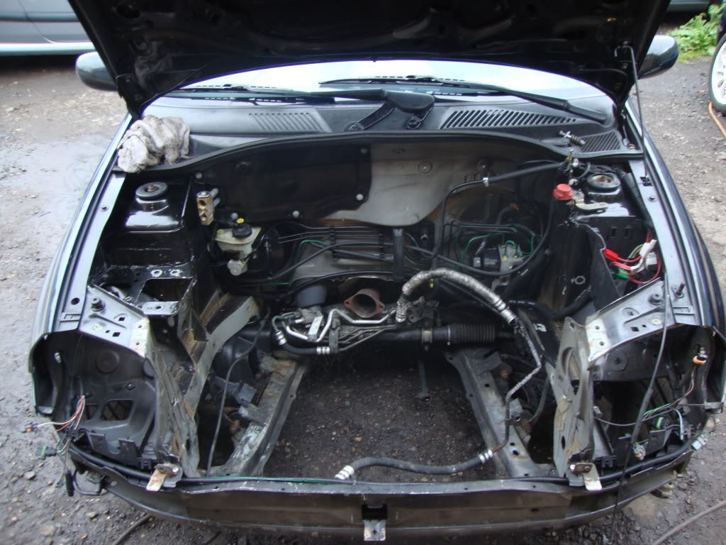

C car.crash Clio 182 Oct 20, 2016 #1 i need a pic of a engine bay without a engine fitted. I want to see the route of the fuel pipe near the brake servo. Thanks
C car.crash Clio 182 Oct 20, 2016 #3 Does anyone know if the fuel pipe tucks behind the heat shield at the master cylinder?
B barnesautos 172 Ph1 Oct 21, 2016 #4 car.crash said: Does anyone know if the fuel pipe tucks behind the heat shield at the master cylinder? Click to expand... They do indeed @car.crash. Run in between the brake pipe and the heat shield . You can see just about where they come out from master cylinder area.
