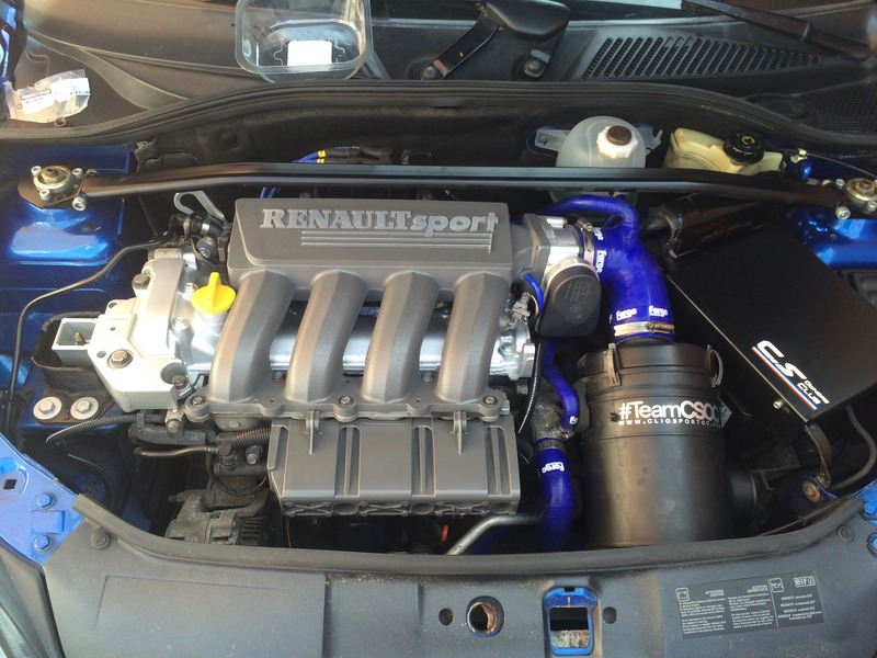

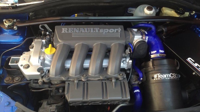

This is what the bay looked like a few months ago, and its been through a few different guises, good and bad over last couple of months.
I wasn't particularly happy with any of them, i liked the engine cover, but i couldn't fit it with the PMS strut brace. So that was the end of that.
Day 1

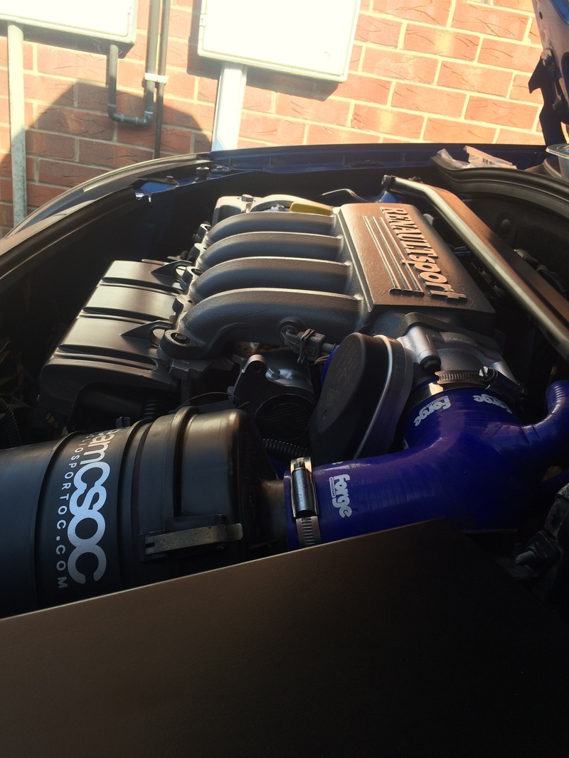

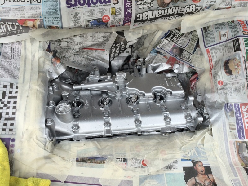

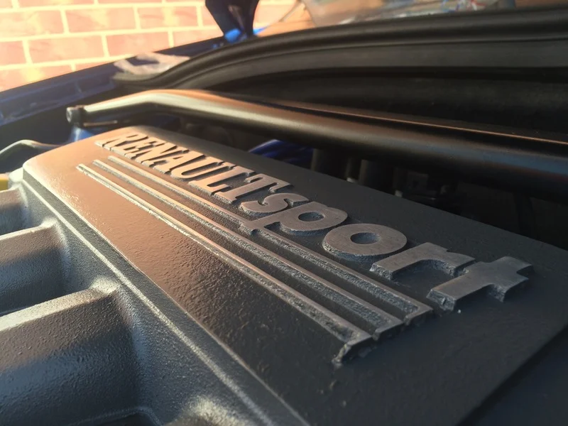

Removed Inlet and masked Rocker cover off best i could.
However once all built back up, i just wasn't happy with the finished article. The silver on silver with the rocker cover just didn't work for me, so back to the drawing board.
Day 2

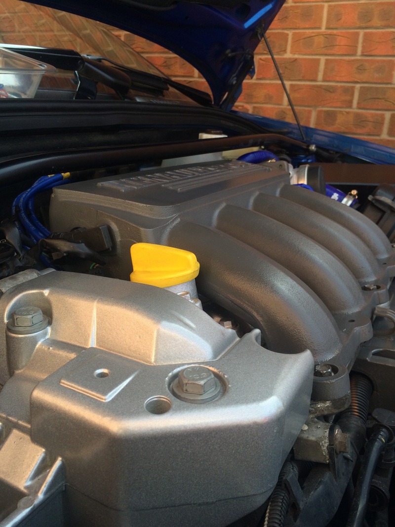

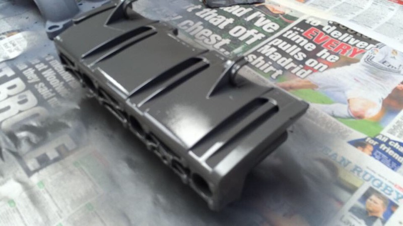

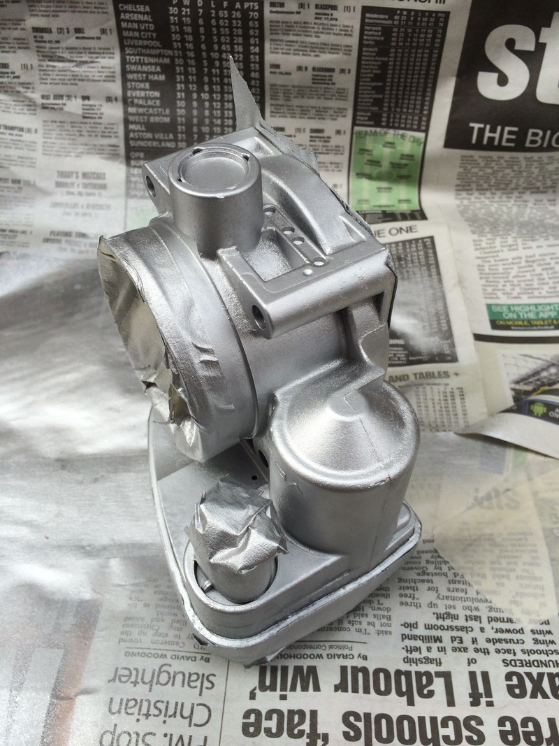

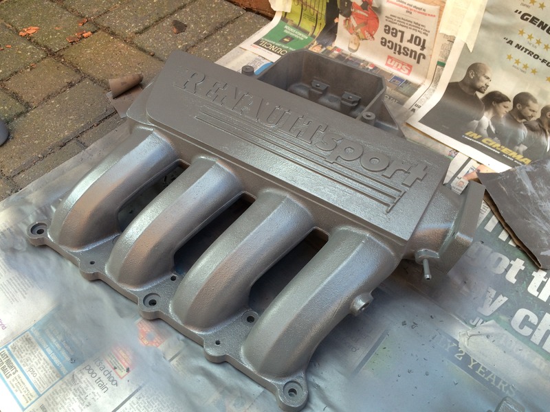

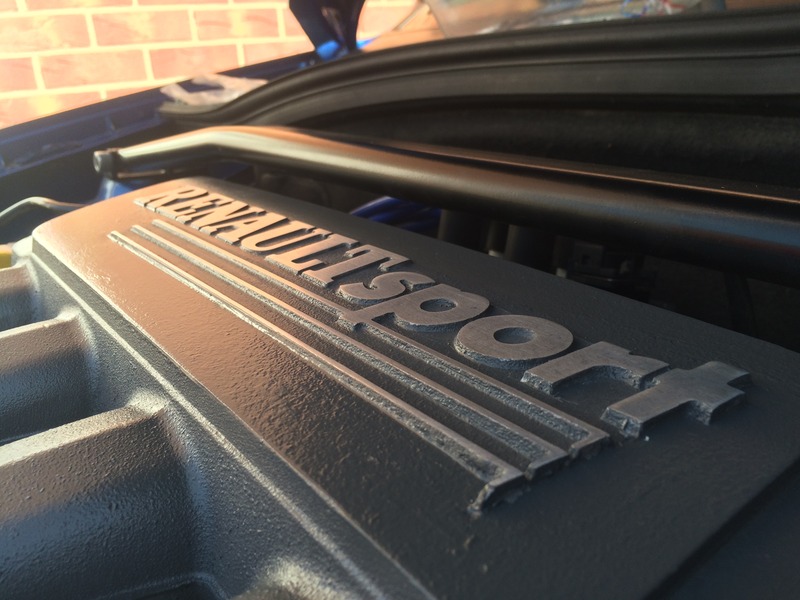

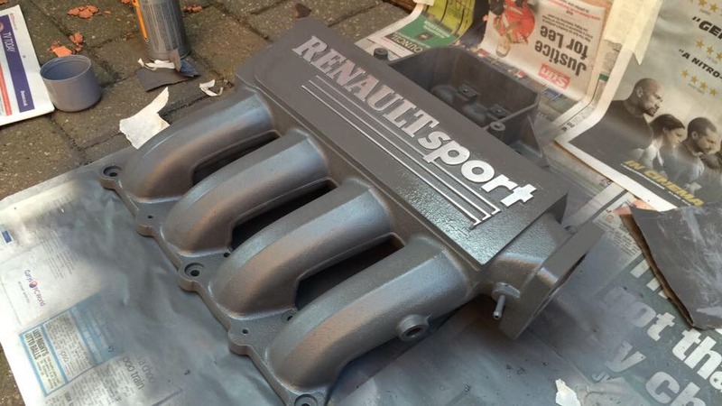

Off to Halfords i went, bought some paint, primer & wet&dry sandpaper.
Back off came the inlet and set away at getting it painted.

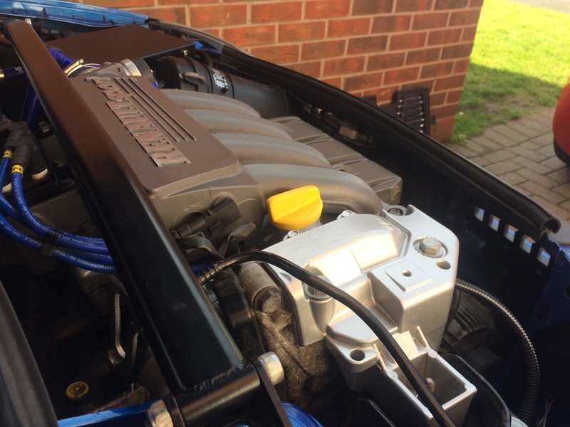

Back together it went again

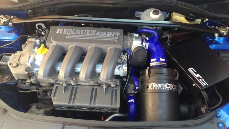

Getting there...

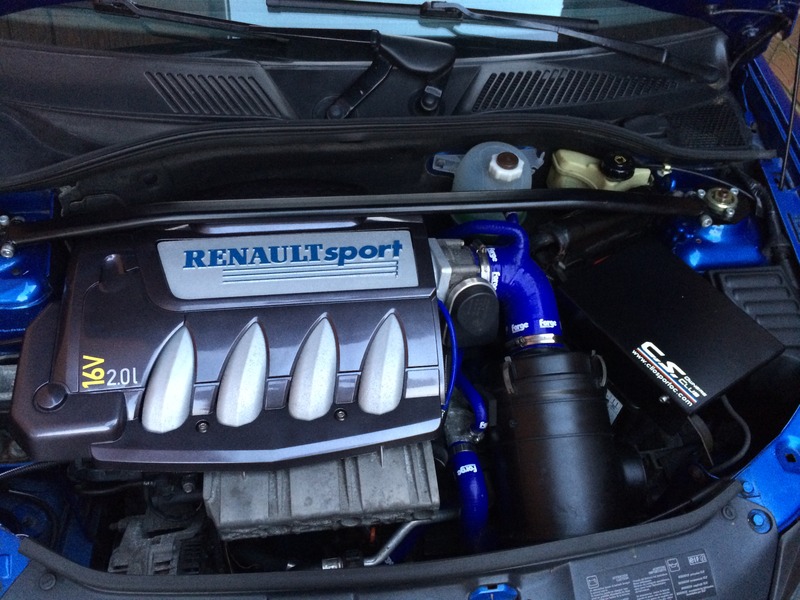

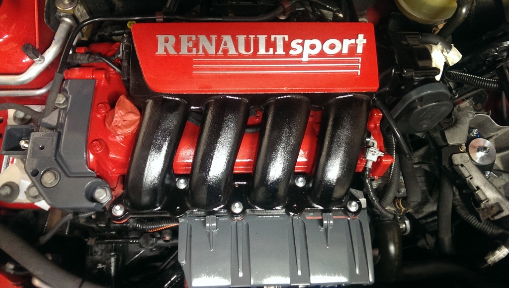

All Done...
Thats all Folks...
Nice turn around. Iv got similar plans and luckily got hold of a complete set of engine bolts and other parts I'm going to have plated.
Yeah, just masked connector off.
Yeah, it took me two days really to do it properly, at two seperate attempted. Well worth the the effort though.

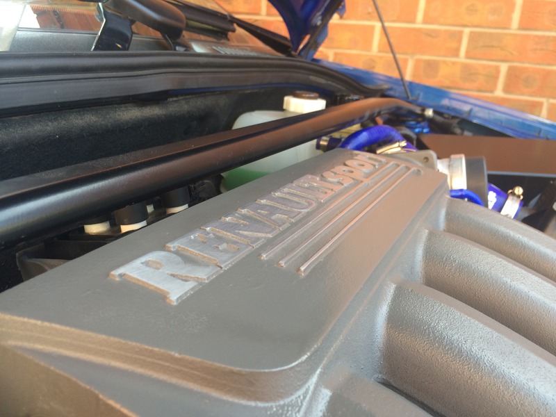

Very nice. Hoping mine will look as good as this. Did mine all silver too and looks poo.
Like the darker inlet and fuel guard! Nice work.

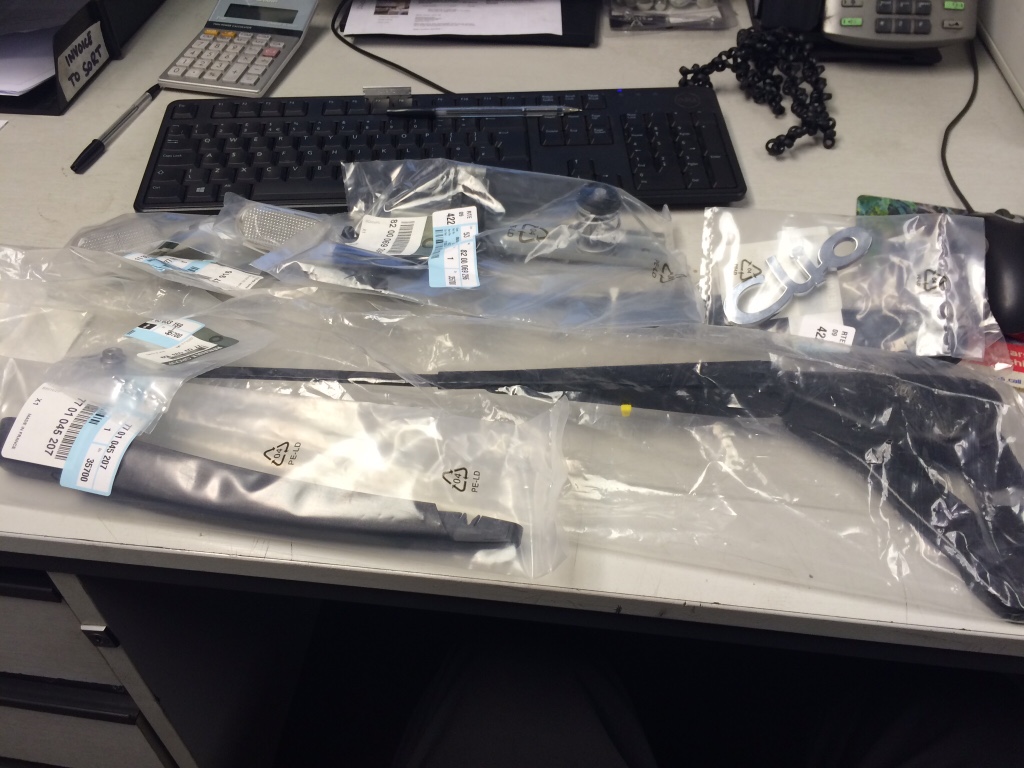

I'm on with the coolant cap - new one on order! Along with new wiper arms as mine are knackered. [emoji85]

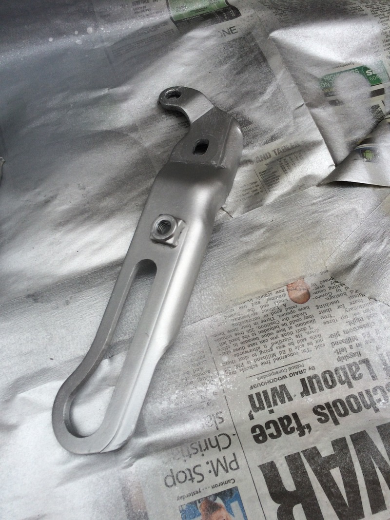

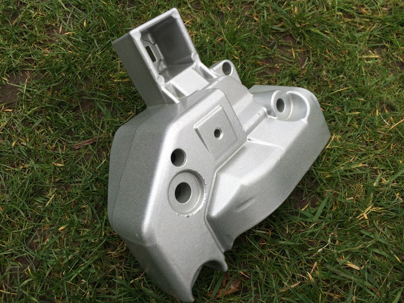

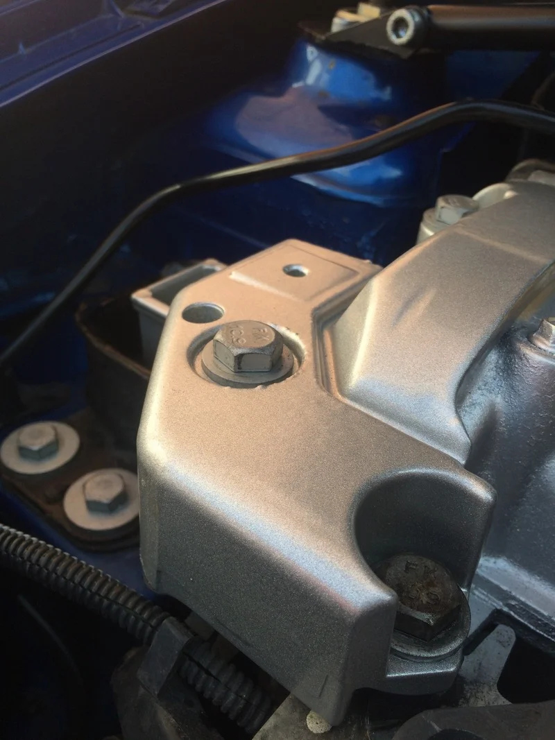

Never tried or looked at how to remove this cover. But Would like to do a proper job on mine. ....
Does it literally just unbolt? It looked like it was part of the engine mount soon didn't touch it.

This is what I am currently doing to my engine bay, getting that all nice and tidy. My inlet is currently in the garden drying, hopefully it will be dry enough tomorrow to sand back the lettering to paint orange.
You need to support the engine from underneath, the engine will just drop if you don't! It comes away from the engine mount. You'll need to line it back up once it's back on, but it's only 3 bolts and a nut that hold it on. I found the bolts were extremely tight, but once undone the job was a doddle.

I though as much. [emoji5]
That's why in left it last time. I did paint it though, just masked the surrounding areas, but would be a much better job if I removed to paint. [emoji106]

Yeah, I only used VHT on the rocker cover. I used normal paint on rest. One thing I didn't do was lacquer it - I may have to consider lacquering it.
As Jamie said. Get a jack with a block of wood under the sump and raise it slightly then away you go.

Along with some new wiper arms and bits and pieces to complete the make over.
