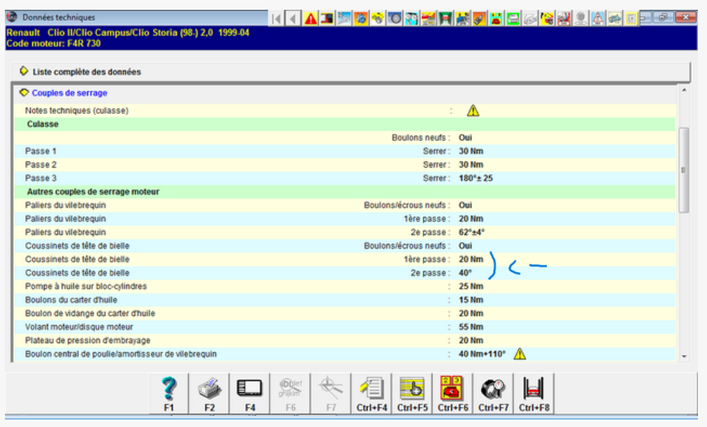

I'm about to change my engine bearing but cant find a trust info for the tighten torque of it.
Does anyone alreadty done it and have the tighten torques for a clio 2 172 2001.
Till now the this is what i fond the most trusted infos to do it.
Thanks

After talking to a few renault addicted this print screen seems to be correct.
20Nm and 40g for clio 2 rs ph2 .
