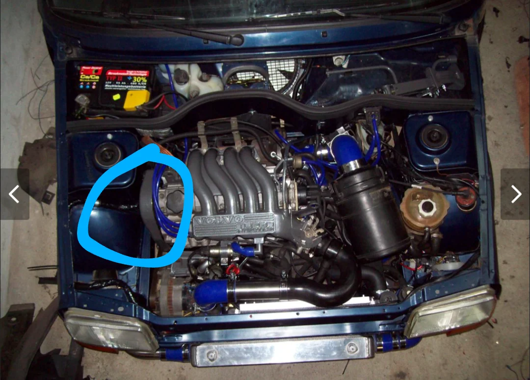

The thing is, for me this is the best turbo "renault" engine, I had a MK1 which I fitted one and only with the stock turbo making 0.9 bar was amazing, and this time I want to use a T25 turbo with something like 1.2 bar, with probably water to air intercooling, N/A CAM and F3R inlet.
The diesel(F8Q and F9Q) mounts doesn't bolt to the petrol heads, the B18FT has the threads to fit F3P, N and R mounts, my main thing is just the connection from mount that stays in the chassis and the hole in the F3R laguna mount will make a good fit or the engine will be angled in the bay.

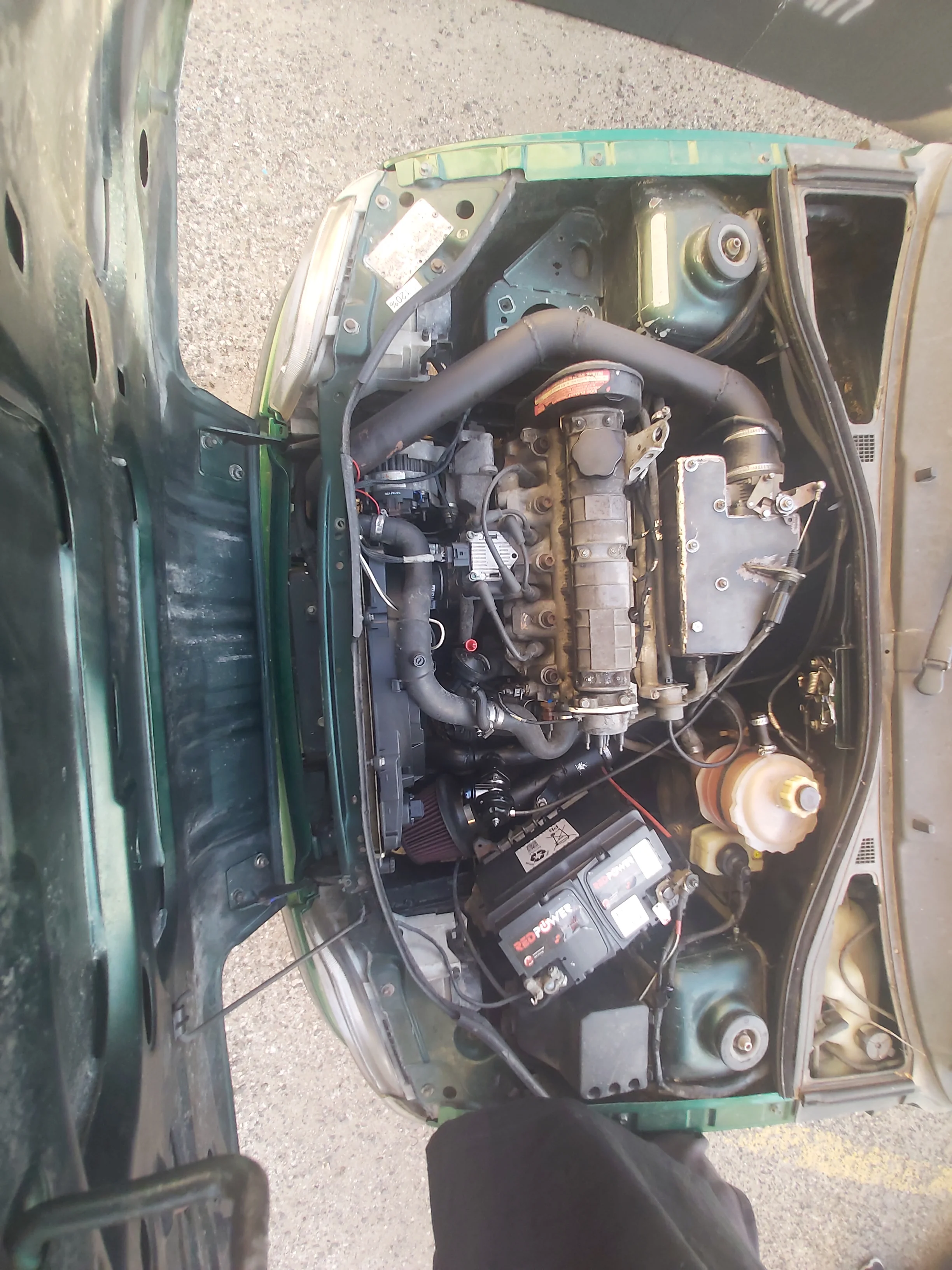

Yes, I have a shop here in Portugal where I make Speeduinos, Custom Wiring Looms and sometimes swaps but mainly Opel, in Renaults I have fitted a K4M in a MK1 and that B18FT in that MK1. I have also a Nardo Corsa B 1.8 16V swapped with Big cams, so anything N/A i don't have much interest
