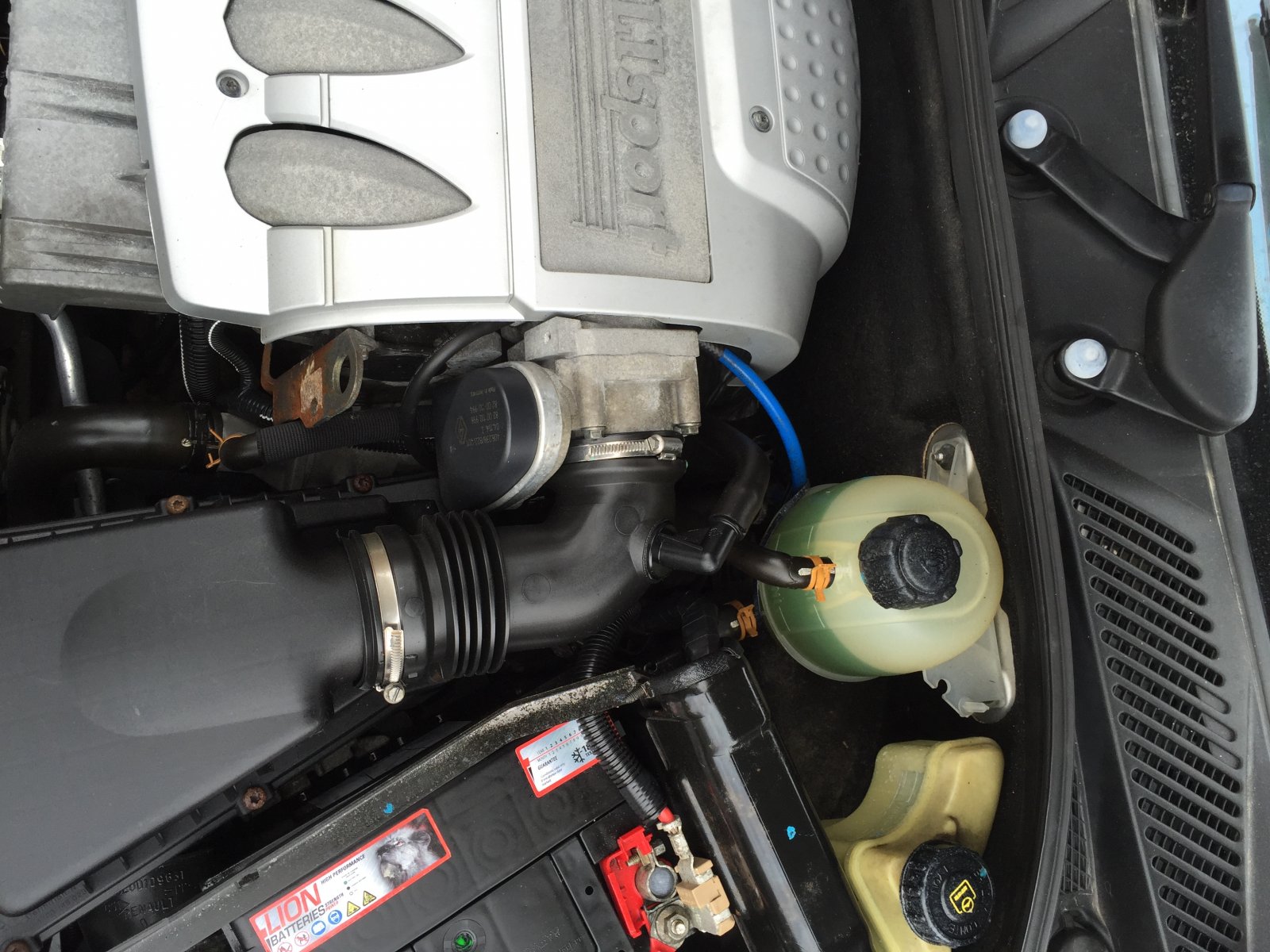

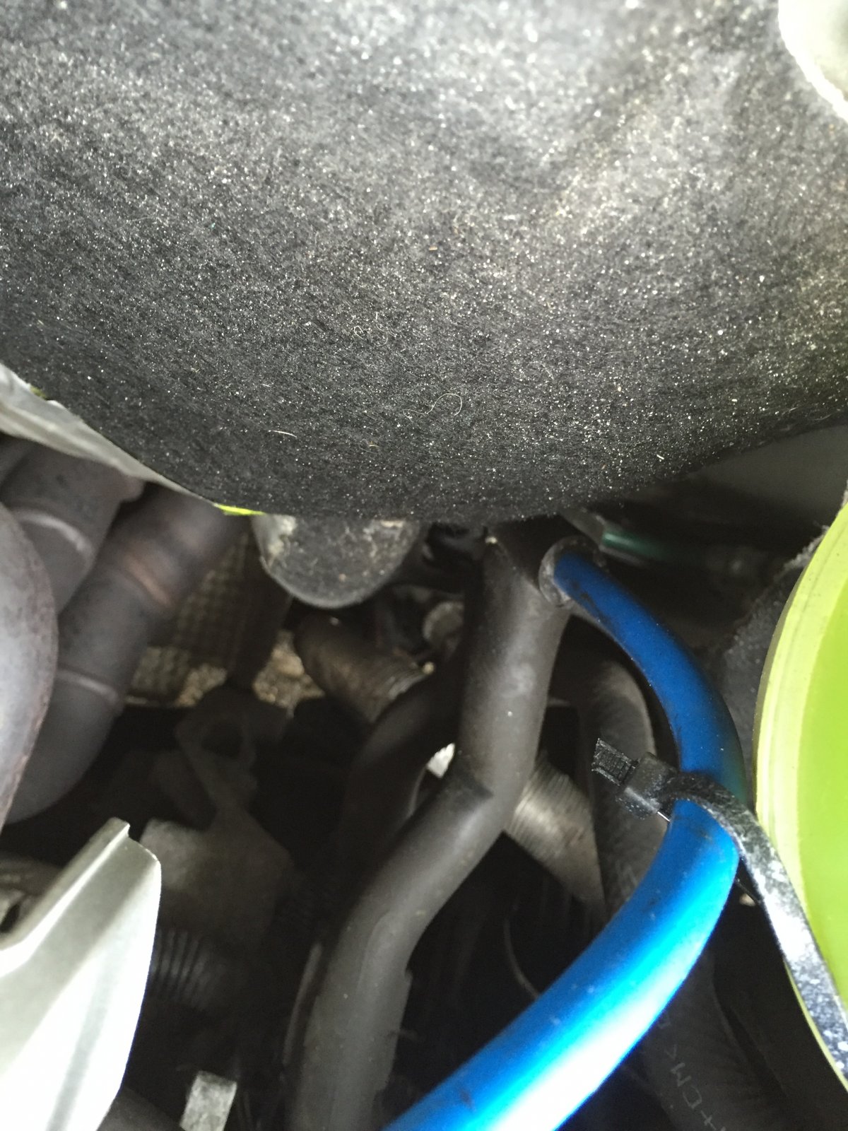

I've just been looking at the engine, and seen this which I believe to be a breather pipe. Correct me if I'm wrong.
I can't seem to see where this goes too. Apart from behind the bulk head. Has this been bodged and will it cause lack of power if not air tight?

Have a look at your first photo, that pipe which joins the elbow between the throttle body and the airbox should look familiar :wink:
Black breather pipe goes from inlet elbow to cam cover.
Blue one is a vac pipe from the inlet to the brake servo.
Yeah, that's not OEM, someone's replaced it at some point. They sometimes melt, so no big deal.
