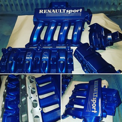

You could consider an inlet like the RS2. That combined with cams should give you a realistic 200bhp and it should drive lovely. They aren't cheap but they look proper cool, and they are rare so they hold their value very well if you ever need to sell it on.

Oooh I forgot about the RS2 that could be an option.

- RS2 Inlet

That’s my plan! Ive got a 182 manifold 197 injectors ARP bolts ktec induction and will group n then get a map at EFI.

I’ve got the RS lower inlet manifold going on, 182 exhaust manifold and with the 197 injectors a map and timing it should be Just right.

And I would strongly advise you get your inlet plenum and inlet mani port matched. You will see very good results from it matched with GroupN and 182 manifold.

This is your port matching company you want to use.

I’ll definitely get my inlets sent off to get matched (after all this corona stuff is over!) as that seems it could be great gain for not much outlay. This forum really is the best with all the advice!
