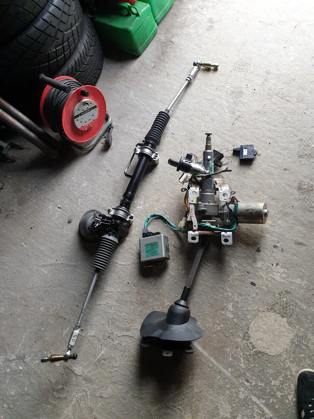

Now I’ve got it back together I’m now thinking that I should’ve done an EPAS conversion at the same time. Is it hard to do? I’ve not done any research into it
Eddie555
  Q7 2018 & 172 Cup.
It would have been easier when the engine was out but still its not hard... It was easier for me as I had access to a 2 post ramp and I just dropped my subframe and changed the rack over on the floor.. the interior part changing the column is a piss easy as was the wiring to it... removing all the old hpas hoses were a bit of a pain though if you want to keep them intact..
Sent from my SM-G977B using Tapatalk
Its the mess of the hpas fluid that was the worst part for me, although had a bit of a time doing the wiring but It was my first time doing such job, had a couple problems prop up which @1985michael182 helped with
Eddie555
  Q7 2018 & 172 Cup.
Yea I read you were having issues with using an existing main power feed. Mines a Cup and I dont think that main feed is in mine so I had a quick look couldn't find one so I just ran an 8 gauge power cable straight to my internal bulkhead power supply from my battery relocation wiring..All the rest of the wiring was a doddle..I think I spent 1/2 hr tops and it was done..
I had to buy a nonsport loom which had the correct gauge wire that goes under the skuttle to the relays, worked out perfect.
I have a cup interior loom and both power and earths are in there btw
Eddie555
  Q7 2018 & 172 Cup.
Lol.. TBF. I spent all of 2 mins looking, thought F**k it and #becausefrenchwiring, thought its better to run new thicker cabling anyway..
1985michael182
Another good reason for Epas is the reduced weight and less strain on the engine with a reduced rotating mass.
Only need the alternator on the auxiliary belt, well water pump aswell but that goes without saying.
Losing the aircon pump and hpas is a huge saving In weight with all the gubbins that goes with it. Less to maintain and more room in the bay.
Can drop the sub frame in a fraction of the time aswell with out all the pipes to contend with.
My plan was do it once do it right then I dont need to bugger around anymore just nut and bolt checks with usual maintenance.
