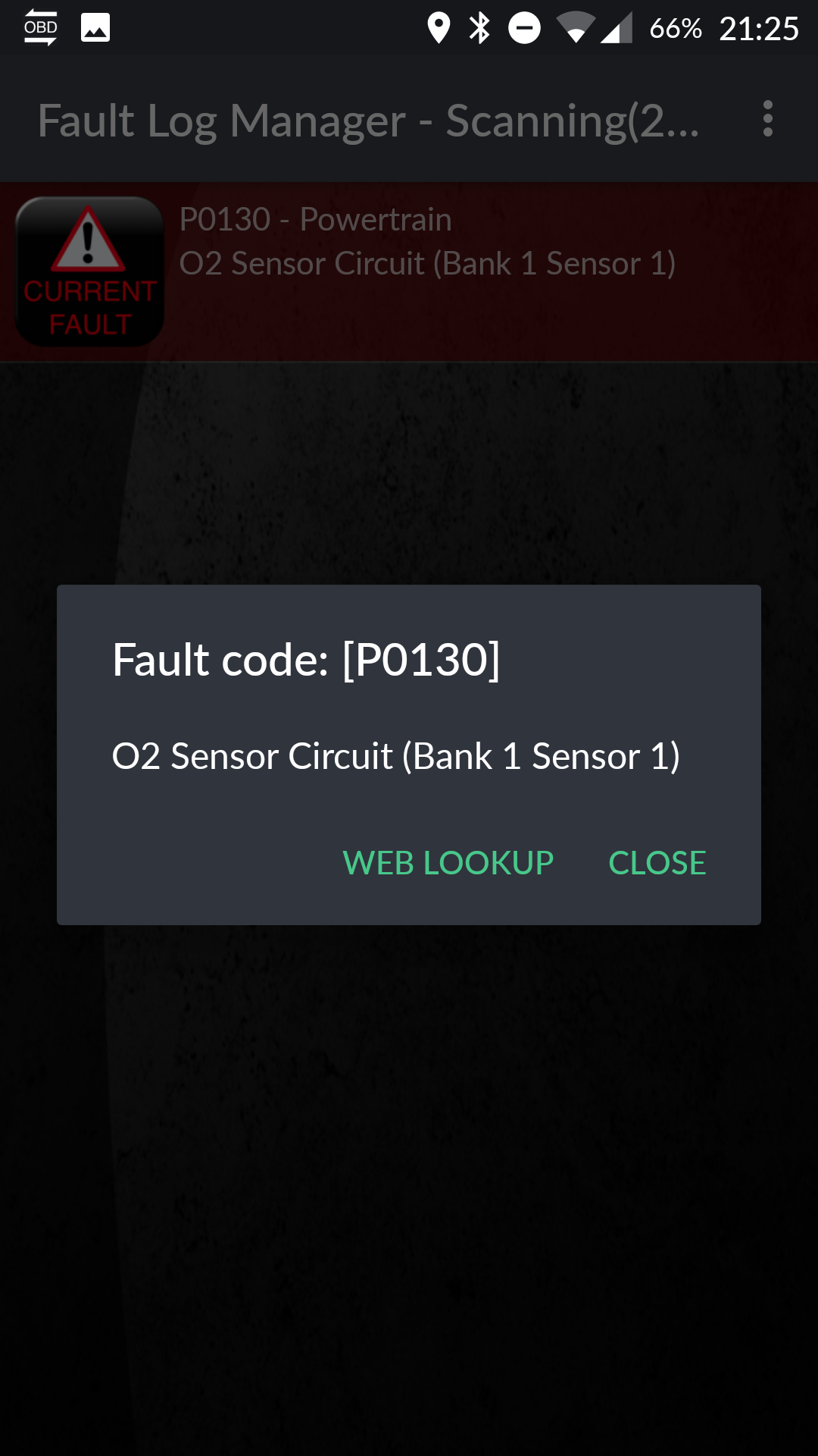

So update time... After speaking to one of my car friends he has lent me his Torque bluetooth diagnostic adapter. Connected it up to the car, and this time I only have one fault code showing, P0130 as below:
And from what I can understand off my research, this is the pre-cat sensor. So it looks like I needs to be changed. Again, from further research ECP have a Bosche item for £82 as per below:

you can get it cheaper than that. also torque is a load of shite, it misses plenty of codes, absolute joke software. get it checked on something decent.

Well, following your advice and suspect of the Torque, I took it down to a recommended garage and it was indeed confirmed as being the Pre-cat Lambda sensor. I shopped around and found a discount code for ECPs and got it down to just over £60. I couldn't seem to find it cheaper than this from a trusted seller (more on that later).
