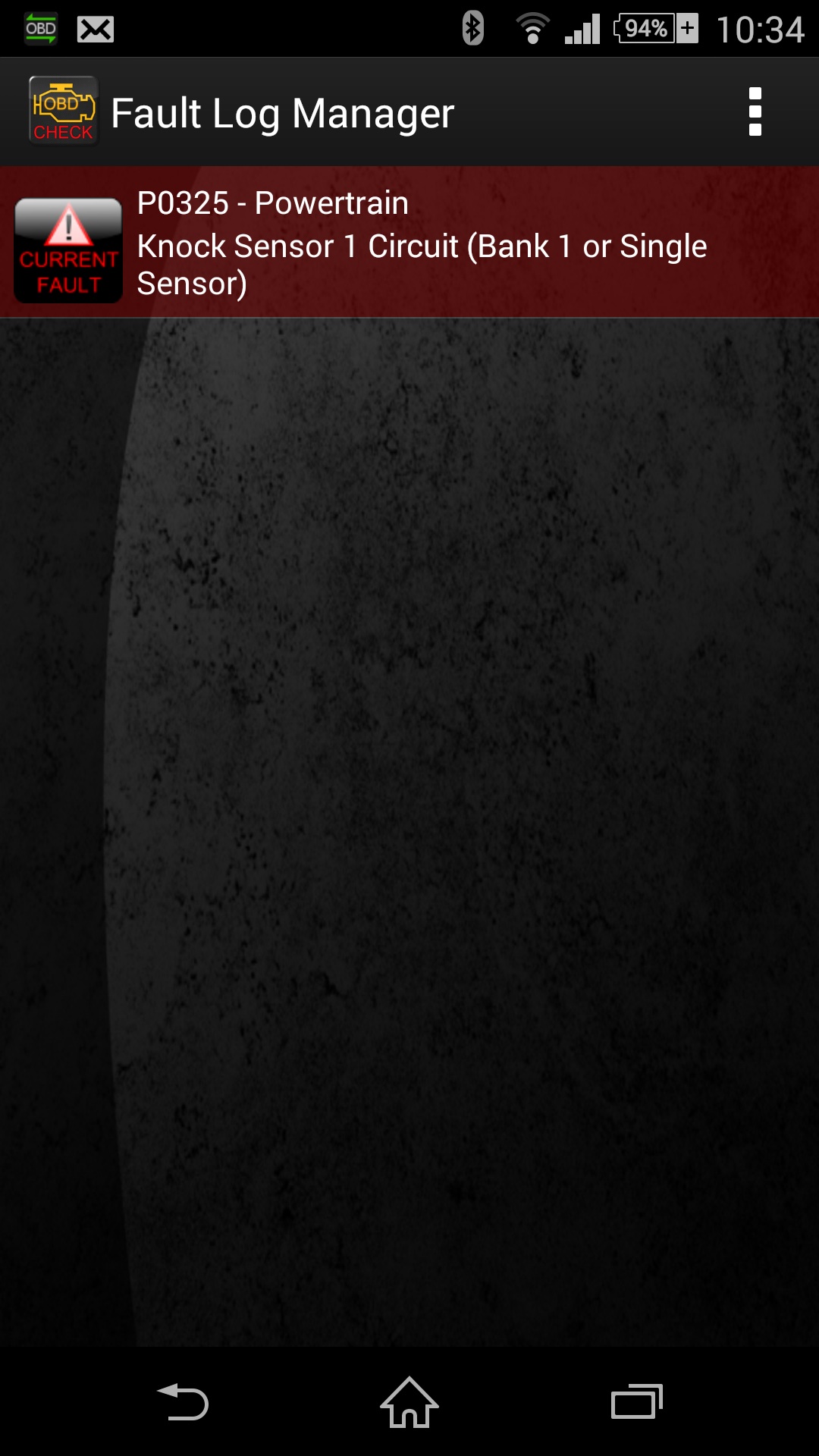

Or at best be temperamental! I've managed to get the fault code, can anyone tell me which one it refers to and will it be an easy fix? I'm driving from Suffolk to Plymouth this weekend, is this doable or am I destined to be sat in my wife's Fiesta??

Knock sensor circuit fault - is the sensor plugged in, intact and not hanging off the block?
