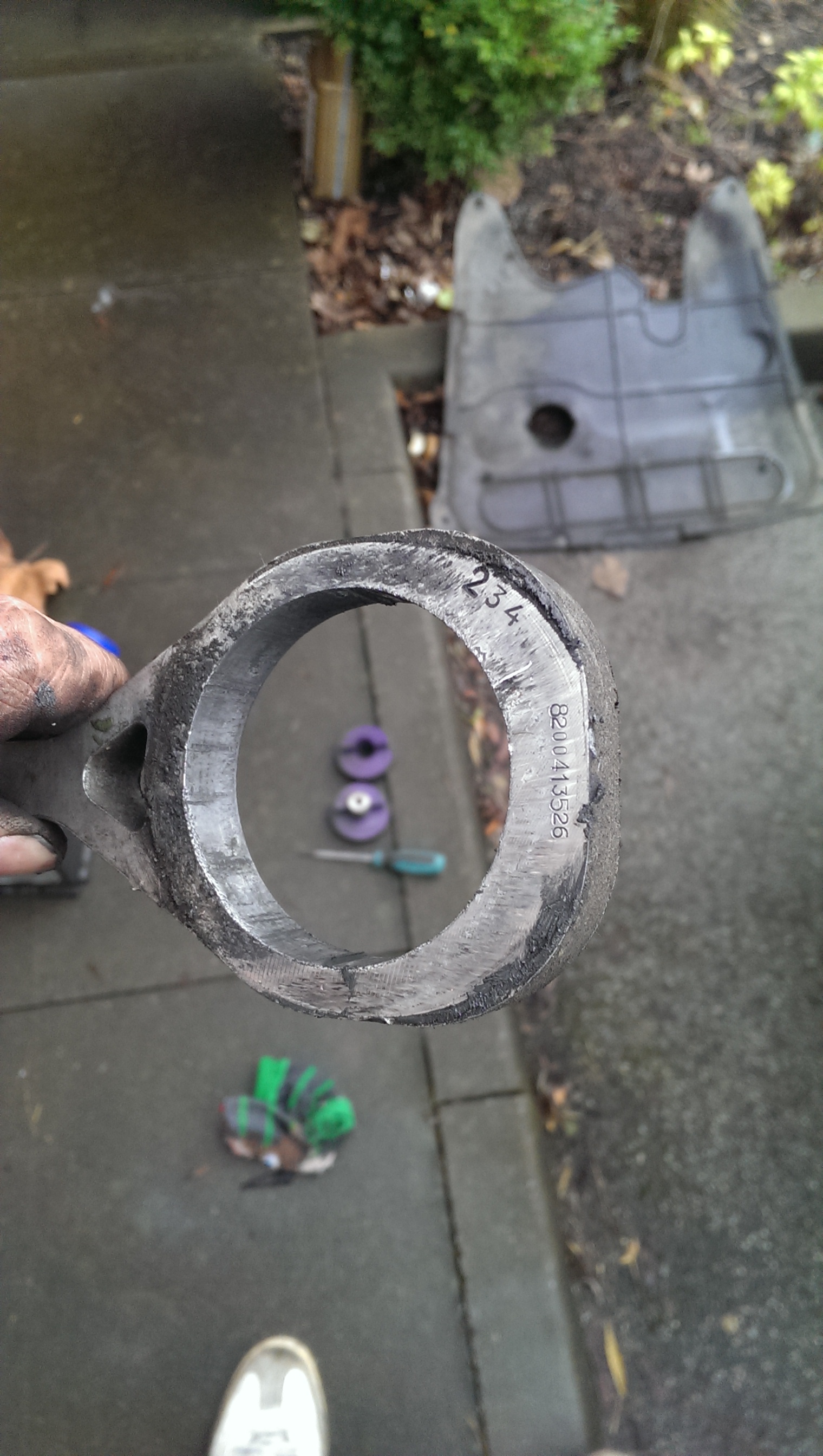

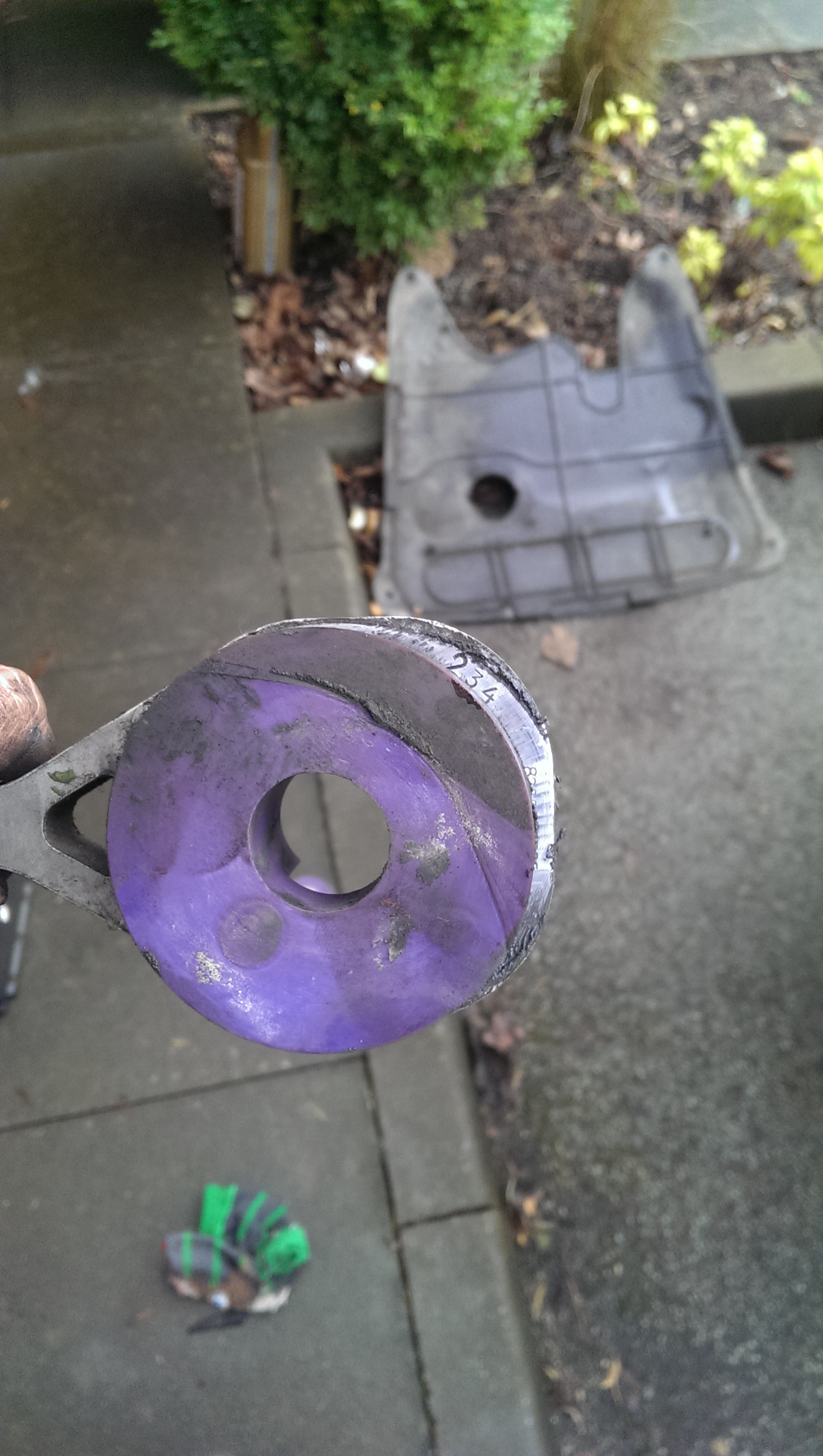

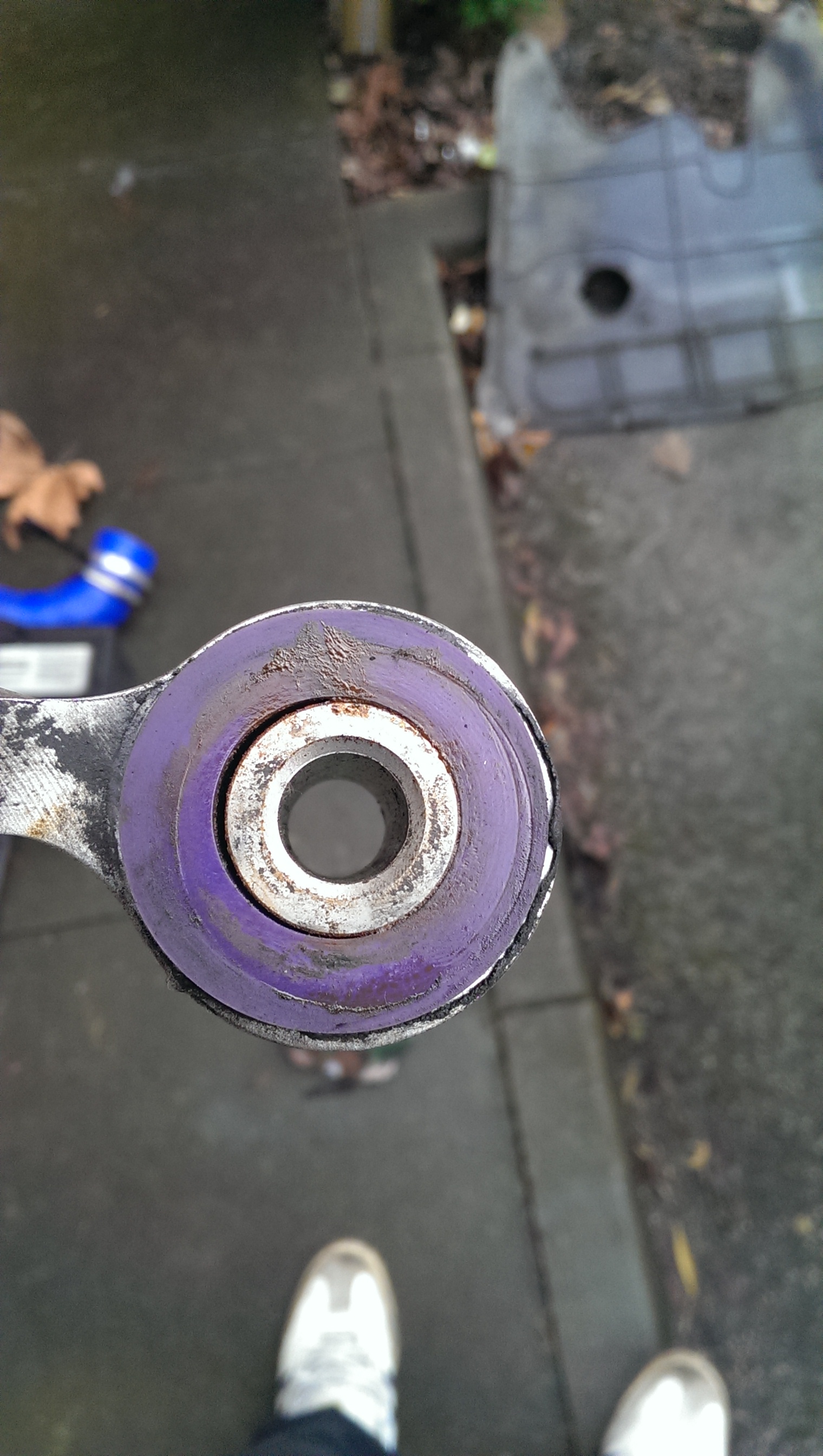

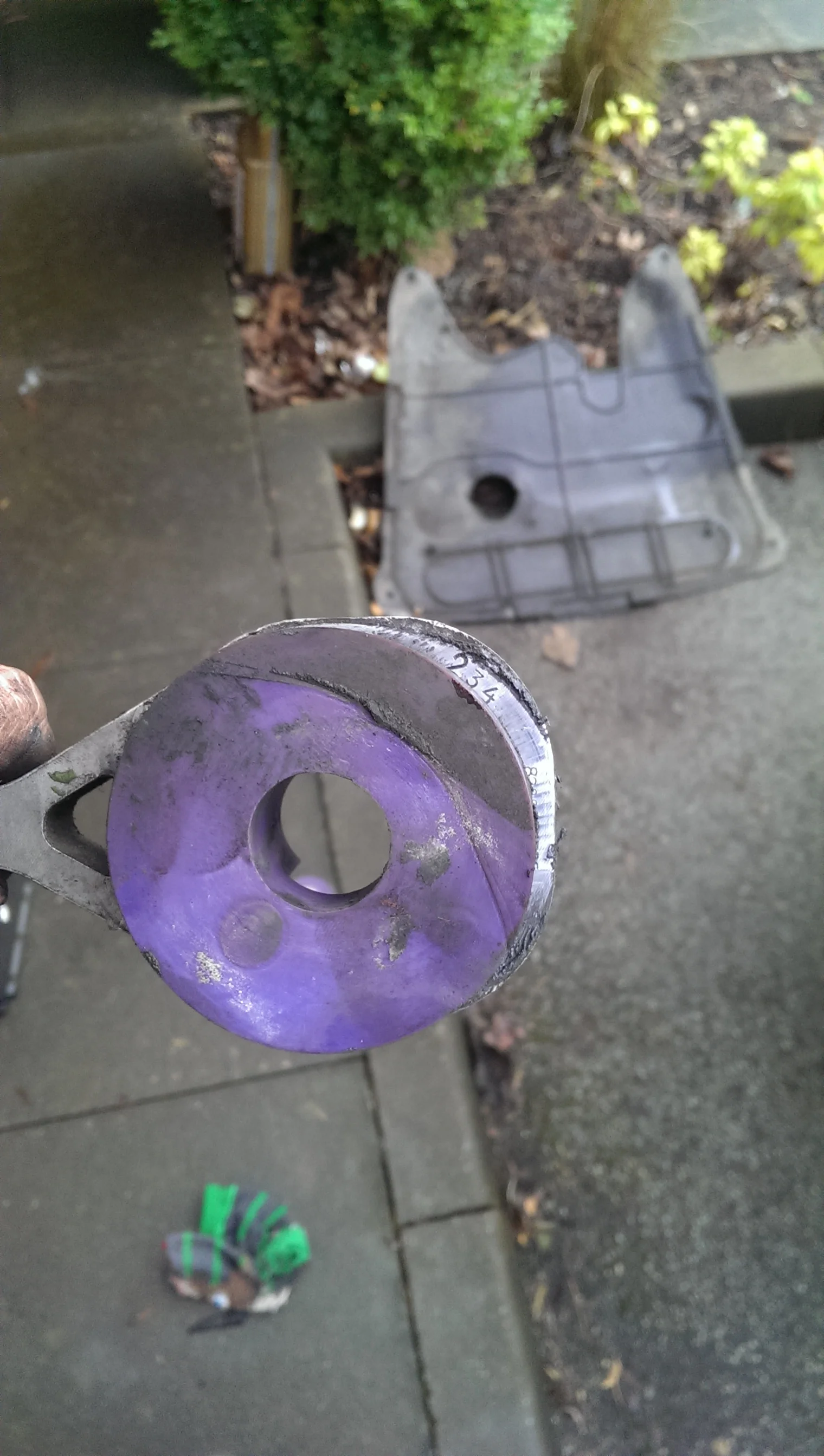

Yep i have powerflex insert on top mount ,new standard mount on box (awaiting vibra mount) and powerflex dogbone.
Flex is the exact thing they do lol. Powwrflex are sending me a replacement.
