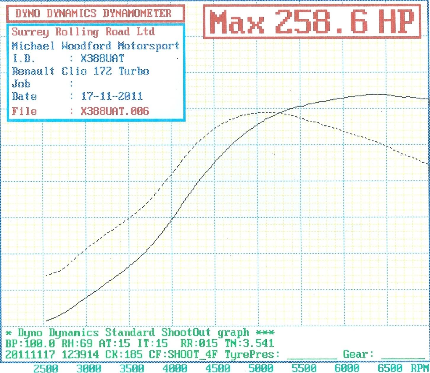

Turbo's work brilliantly on them, this is the MWM car on a standard bottom end with a 197 head/inlet and a MWM turbo setup:
As is always the case with turbos though, they need to be well mapped, there are loads of rubbish turbo converisons out there blowing up left right and centre on the 172 lumps!
