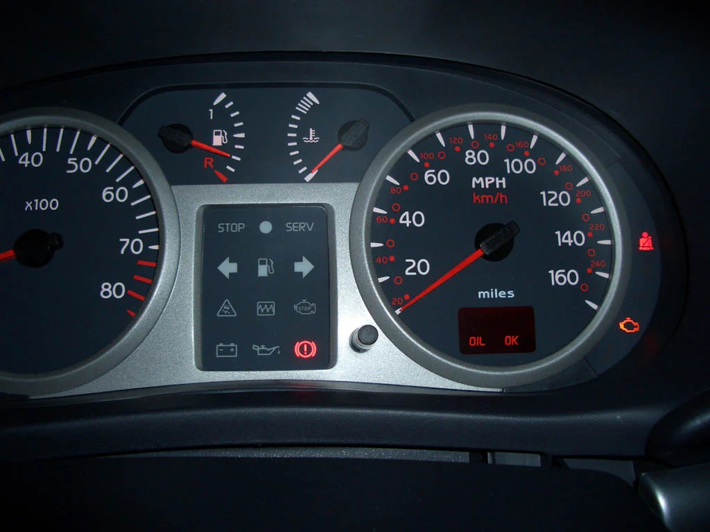

Sorry, a guy at the meet today told me it was E.M light, it's on the bottom right of the dash. shall I take a picture?

Bottom right is the toxic emissions light.

Just took a pic of it, so we know which one I'm talking about...
I'm a bit silly with these things :p
