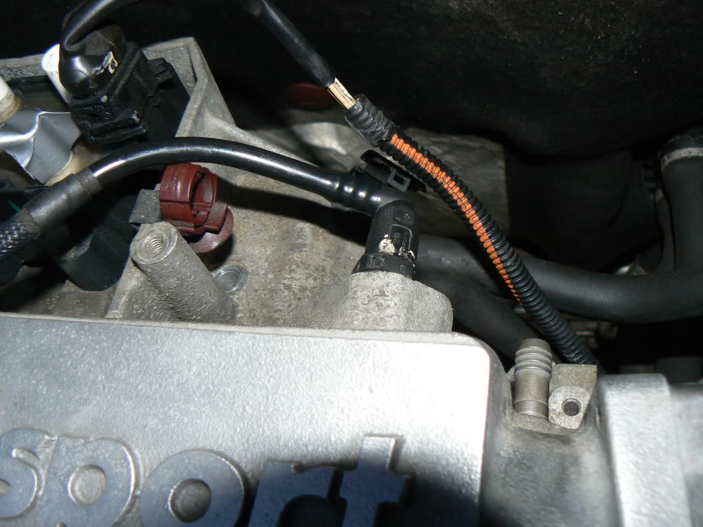

while the plenum is unbolted I thought I giveit a good clean but how on earth is this plug coming out? (the one that enters the plenum from behind, having beneath the letters "RT" from spoer :D - I have no idea what is that)
see pic:

well I've installed it all back together and first the idle went somewhere between 1200-1500 rpm quite longer than I've expected but when the car got to optimal temperature the idle went back to normal. took a drive with the car and it's ok. for now..
