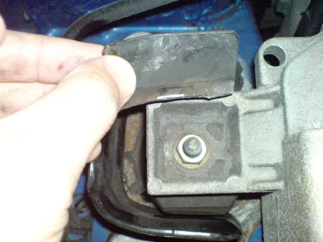

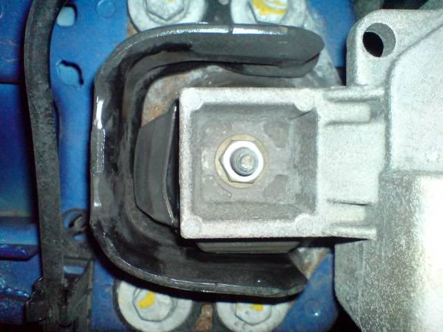

No I think this one is damaged rather than it being a weird design from new:
Firstly looking at the mrs clio I think the bit on the left is actually meant to be at the top
And I don't think I should be able to do this
Could the one under the car have worn and therefore increased the pressure on this one causing it to go as well?
