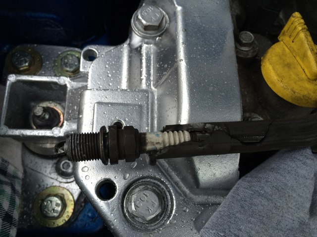

Took the car a run today and noticed it a bit "chappy"
Took it around the block and on the bypass, sitting at 70-80mph steady heard a pop and bit of smoke from engine and now sounds as if it's running on 3?? Any clues to fault?

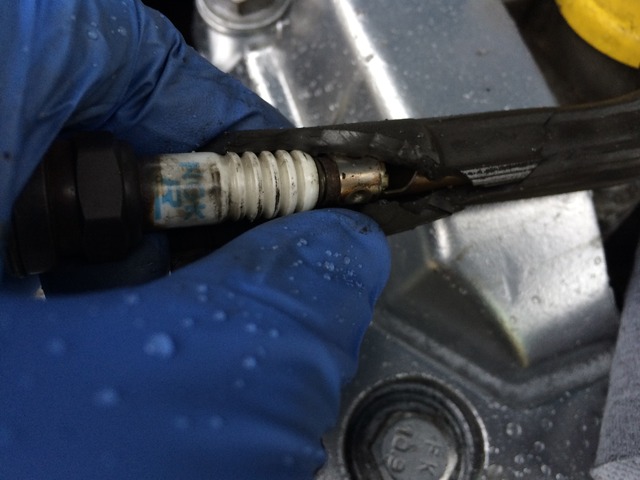

Shat a plug right enough

As soon as i seen this i knew. Remember and use a timesert and NOT a helicoil

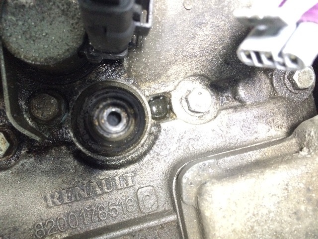

Has it taken the threads? As you may well be able to just wind it back in. Was it cylinder 2/3 by any chance?
Edit, no, 4.
Cylinder 1 closest to oil cap.
I did try it back on a few threads and it was starting to take to it but it blew the plug out so would that increase it happening again if just put back in as the threads will be weak?
