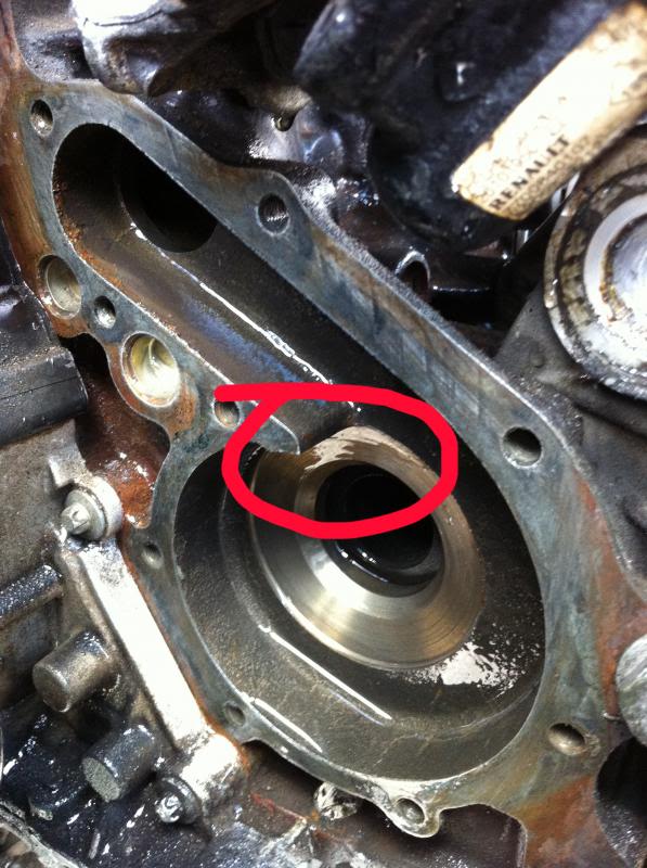

So the pump is changed, I think from this picture its an indication the bearing was starting to fail and the impellers touch the block... but after a LOT of agg including popping the brake reservoir out of the master cylinder yesterday... its all back together and runs, sounds better there was a slight bearing noise on when reving slightly that seems to have improved.
But the noise is still there. after the many hours spent on it im just glad to have it running again.
