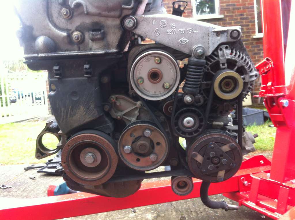

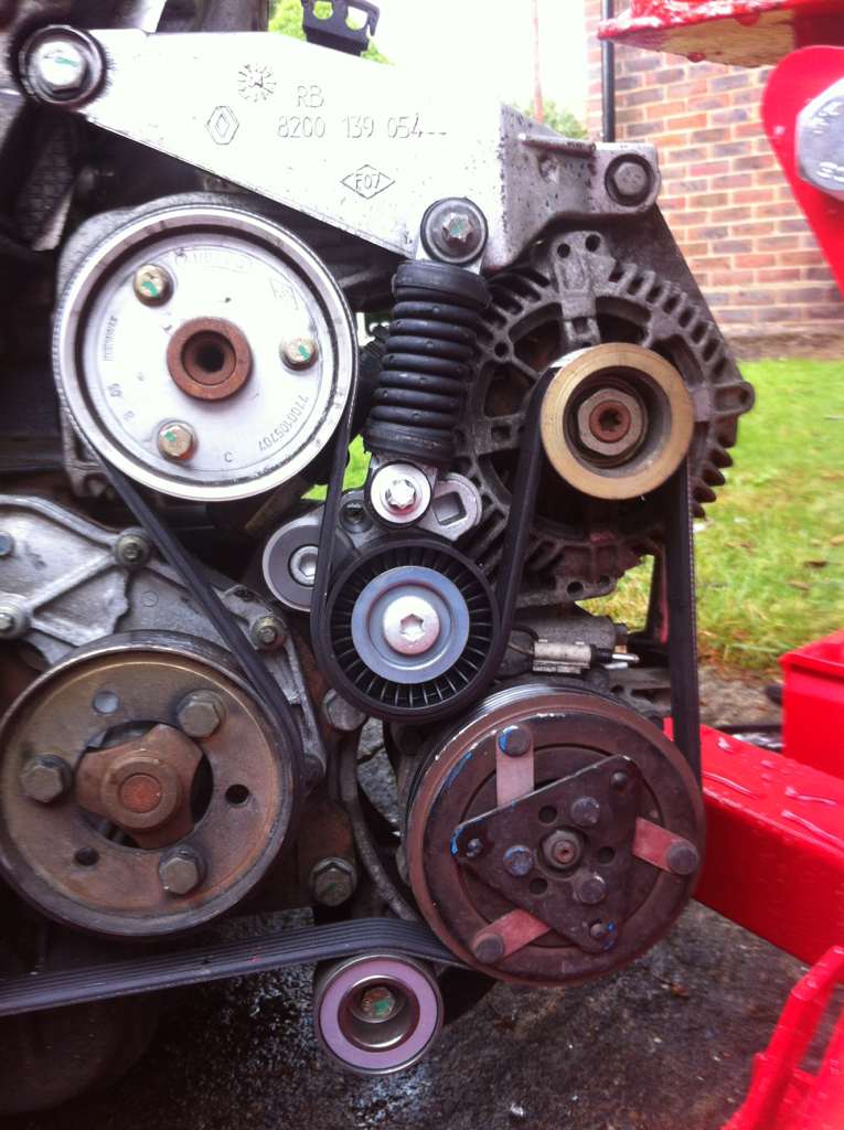

Whats the procedure for getting the new belt on please ?
This picture shows how the tensioner works
And the belt route.
Thanks Budgie, what is the best way to shift the engine over? If i remove the engine mount and support the sump, what else do I need to remove to shift the engine over?
Does that plastic lower cam cover need to be removed? looks like there is a bolt over the pump.
And lastly is the jubile clip around the tensioner sping the bodge way to get the belt tensioned?
