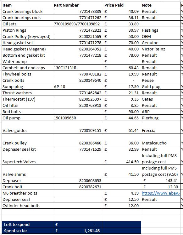

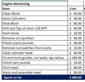

I recently built my engine and the costs were a follows. It isn't a cheap business if you do it properly and often there is little point in doing half a job as it will cost more in the long run. Mine was built for turbo but realistically the only difference between turbo and non-turbo is the head gasket thickness.
This excludes assembly labour, loctite 518, silicone for the end cap, measuring gear, pastigauge, fluids for running in and sourcing the engine parts. The latter being extremely difficult as most cars are high mileage and have scored or out of spec components.
Machine shop was: Vulcan engineering

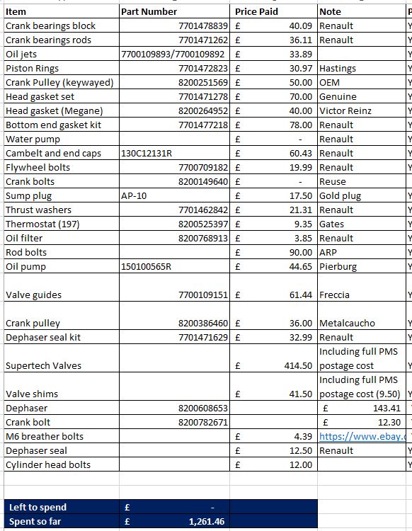

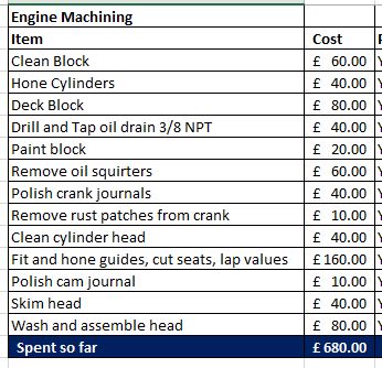

Zinc and vapour blasting: TSR vapour blasting

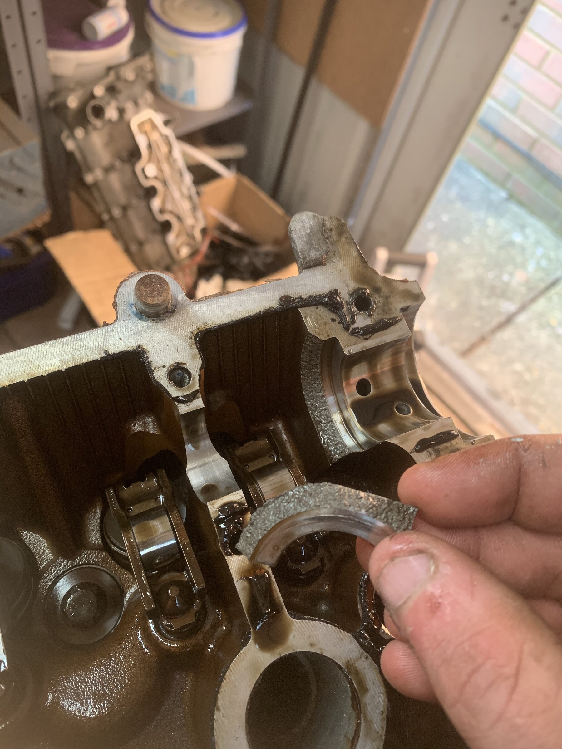

So spent a few hours this evening stripping the head off and down and pulling the pistons out to be greeted by this once the rocker was off
few people have said not to worry about it as it’s not near the cam seal or any oil or water ways, not sure how I feel about it what’s people’s opinions ?

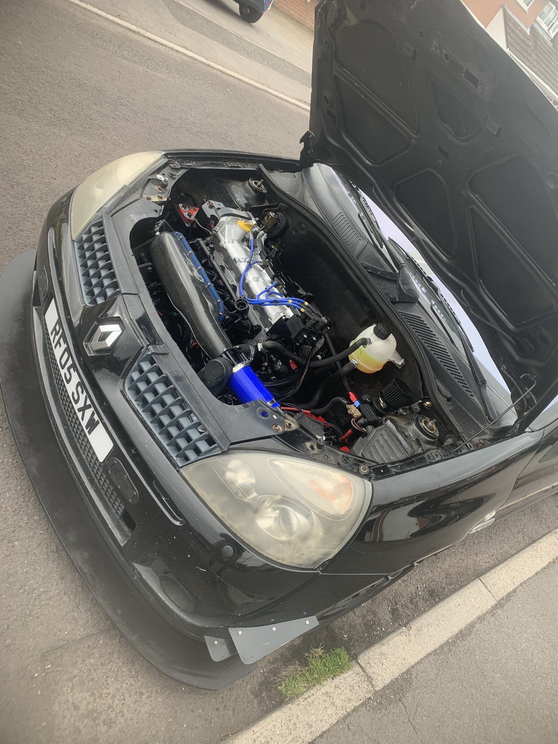

Hey @gambit its all done and up and running, I left the 182 injectors on and have done about 200-250 miles on the engine so far and all
Seems good and the noise is addictive and I’ve not even put any load on it yet so am excited to see what it makes next month at mapping
