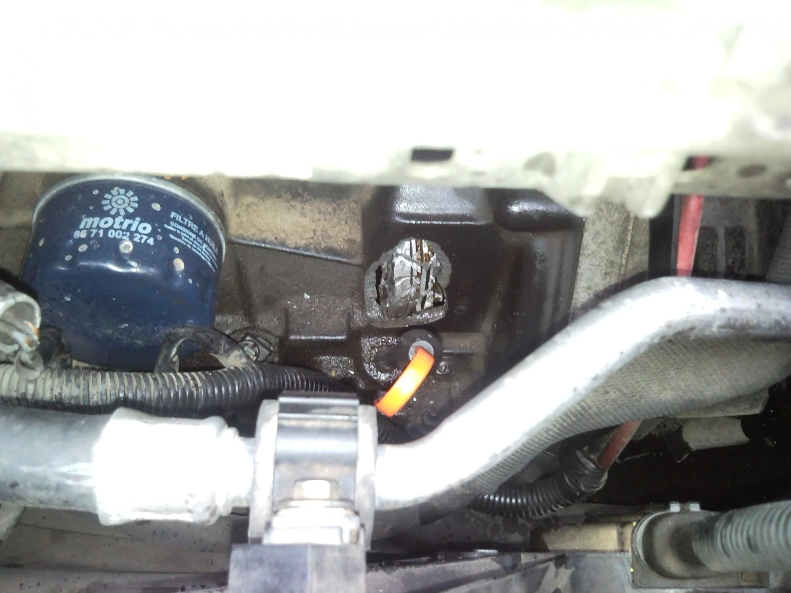

So one moment everything is fine the car is driving fine downhill 3000rpm-ish... the other rpm goes to zero and the car is dead....
Popped the bonnet and saw the 2-3 inch wide hole on the engine block, just above the oil dipstick and a metal object sticking out of it...
Doubt I can source a new engine here in Montenegro, maybe an engine block could be taken out of megane or espace......
Will be posting pic of the damage tonight, when I am home....

Here is the pic...
Does this look like a con rod?
