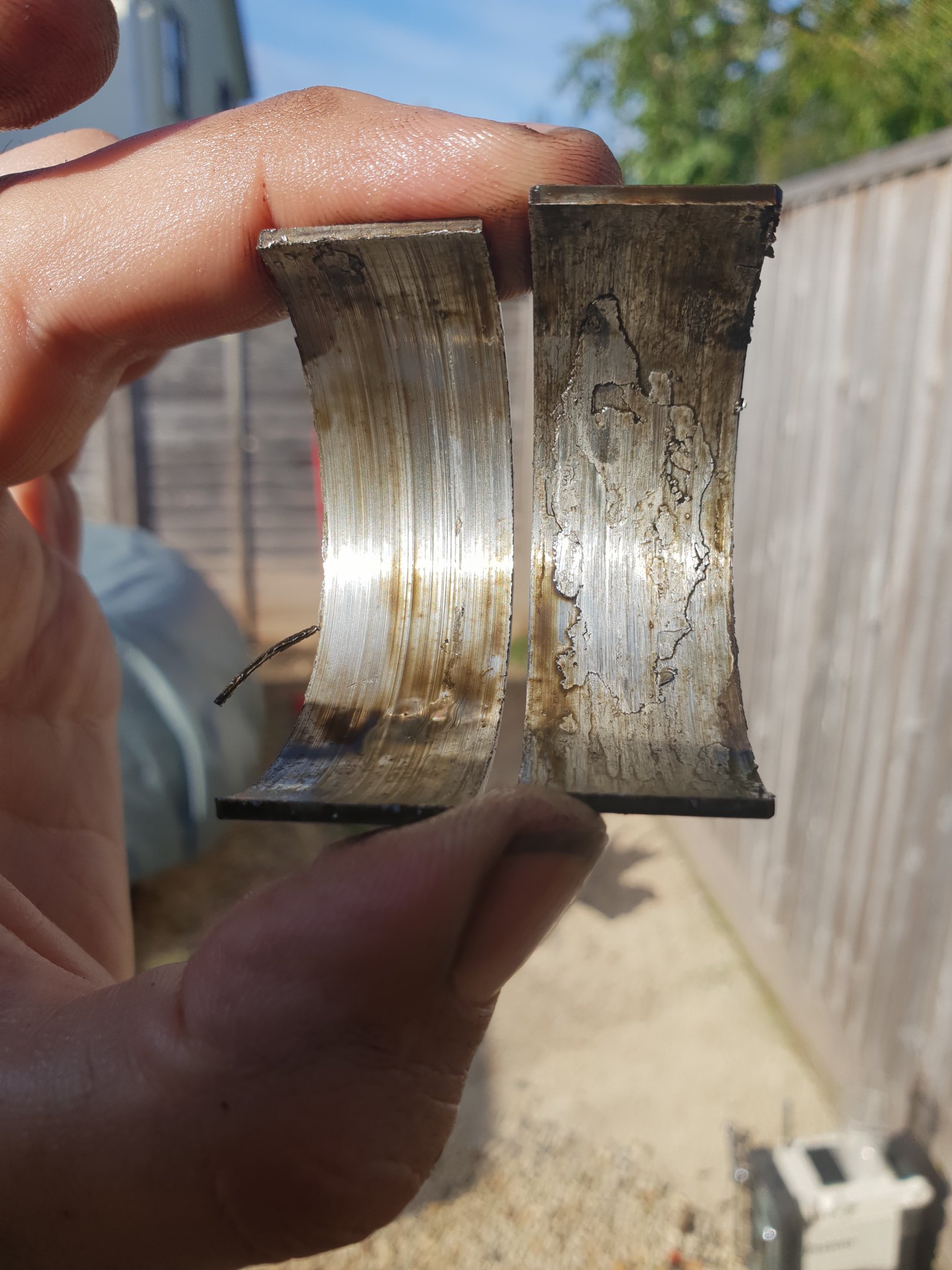

I wanted to get people's thoughts on the possible cause of failure of the bearing shells in my Clio Sport 172.
The engine seized on a track day (first outing after getting the car!!), stripped the engine down today and everything looked ok until I saw the condition of the big end bearings. Also lots of metal flakes in the sump!
Looks like the engine has been apart in the past so wondering if it could be poor fitting, oil starvation, or just cheap bearings??

strip and check oil pump, pressure relief valve sticking is common on them. i'm guessing that that's no2 big end bearing? you'll probably find no3 main hasn't moved but may well be mullered anyway.

Lots of ways to reduce it, but it all costs money mate. The ph2 172 crank is also a pos, so that doesn’t help the job along.
