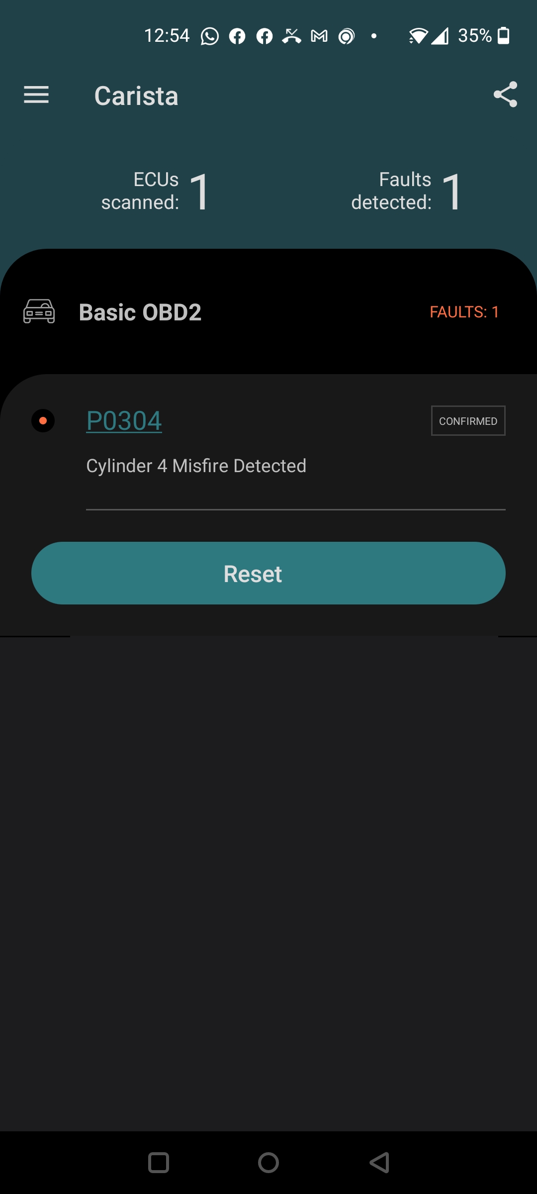

my Clio 182 is coughing and running quite rough at lower RPM. The emission warning light is flashing when I start the car but then goes away after a while. I can smell quite a strong smell of fuel from the exhaust and the car seems to be hunting on idle.
Does anybody have any ideas on what the issue could be?

Had this a couple of times (most recently a couple weeks ago) and was a single injector as noted above.
Think Renparts sell genuine injectors for about £33 each. They were on amazon recently for £27 but keep fluctuating in price. Anything cheaper than that is unlikely genuine and may cause issues.
AutoDocs is usually about the cheapest, but it can be a week for delivery

Thank you guys! I’ll have a look and see if new injectors can fix it
