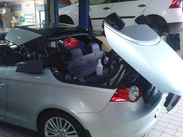

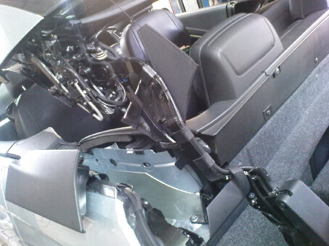

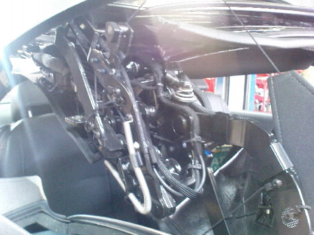

just a few pics of an Eos roof in motion, you can stop it in stages, shows off some of the 497 individual moving pieces in the roof mech

Imagine a kid put their poking figures in the mechanism though...
Impressive. But that's a nightmare just waiting to break? Surely the whole point of having the 'elegance' and functionality of a folding roof is that you don't want to see how it works?

It seems like a ridiculously over contrived mechanism to me. Why make it some complicated? what purpose does it actually serve?
It does eem complicated, but i think the main difference is all the mech is on show with the Eos, a lot of manufacturers hide all the moving bits lol.
