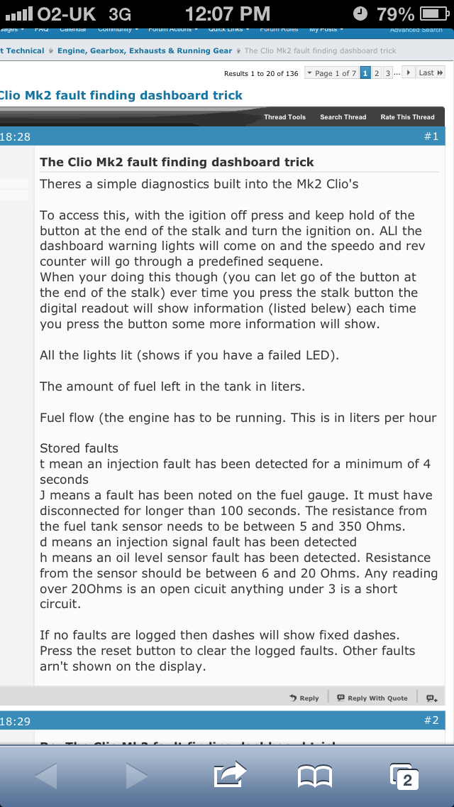

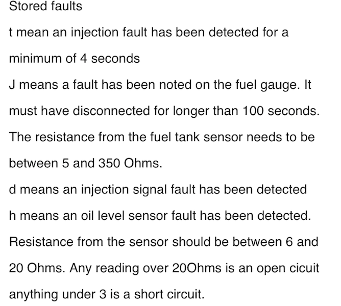

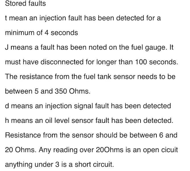

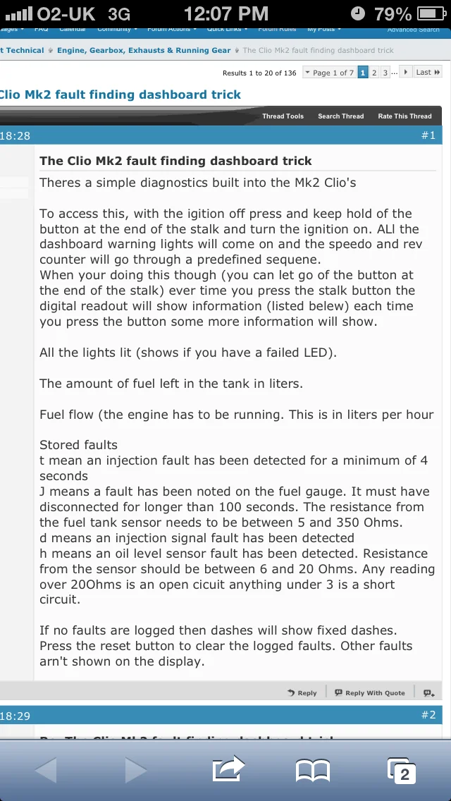

Error code?
That's simply saying the clockset is missing fuel level information. Check your fuel pump is getting power and if not, go to the fuses in the engine bay.
